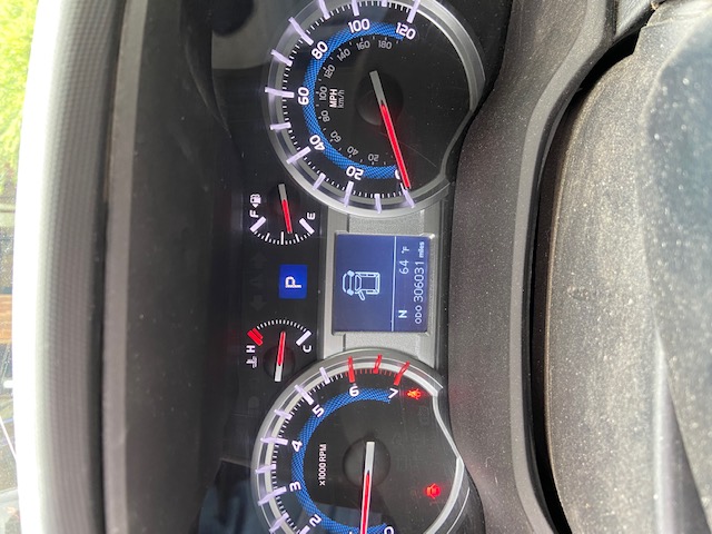

There's nothing wrong with the standard Toyota OEM filter and a name brand synthetic or semi-synthetic oil changed every 6 months or 5000 miles, whichever first. You're talking $35 per change if you do it yourself and if you can't do that yourself, get a Tesla.
Quaker State 0w20 Synthetic and Toyota OEM filters.
Scoreboard matters…
