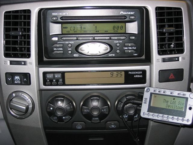

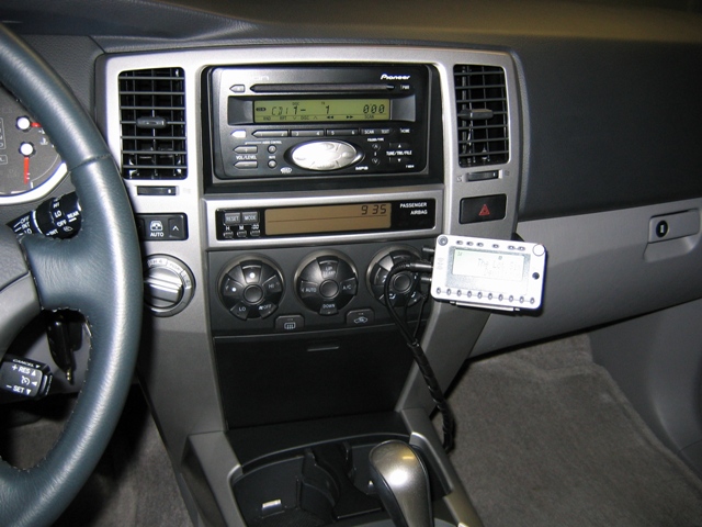

I just recently addedthe XM Roady2 to my 4Runner. It was a fairly easy process. I too have the Scion HU and I hooked up the XM with a PIE auxillary input adapter. I got the Roady2 with the home kit for $70 off of Ebay and the input adapter and a Bracketron vehicle specific mounting adapter from myradiostore.com for about $100. If you want good sound, I would definitely use an auxillary input adapter. Sorry I don't have any pics yet, I'll take some this weekend and post 'em.
Here are a couple of pics of my XM setup. I just need to get a new cable with a 90 degree mini plug. The cable I have now blocks the one climate control knob.
I mounted my Roady in the sunglasses flipdown.
The cleanest XM install would be to buy a Scion XM kit, but its pricy.
