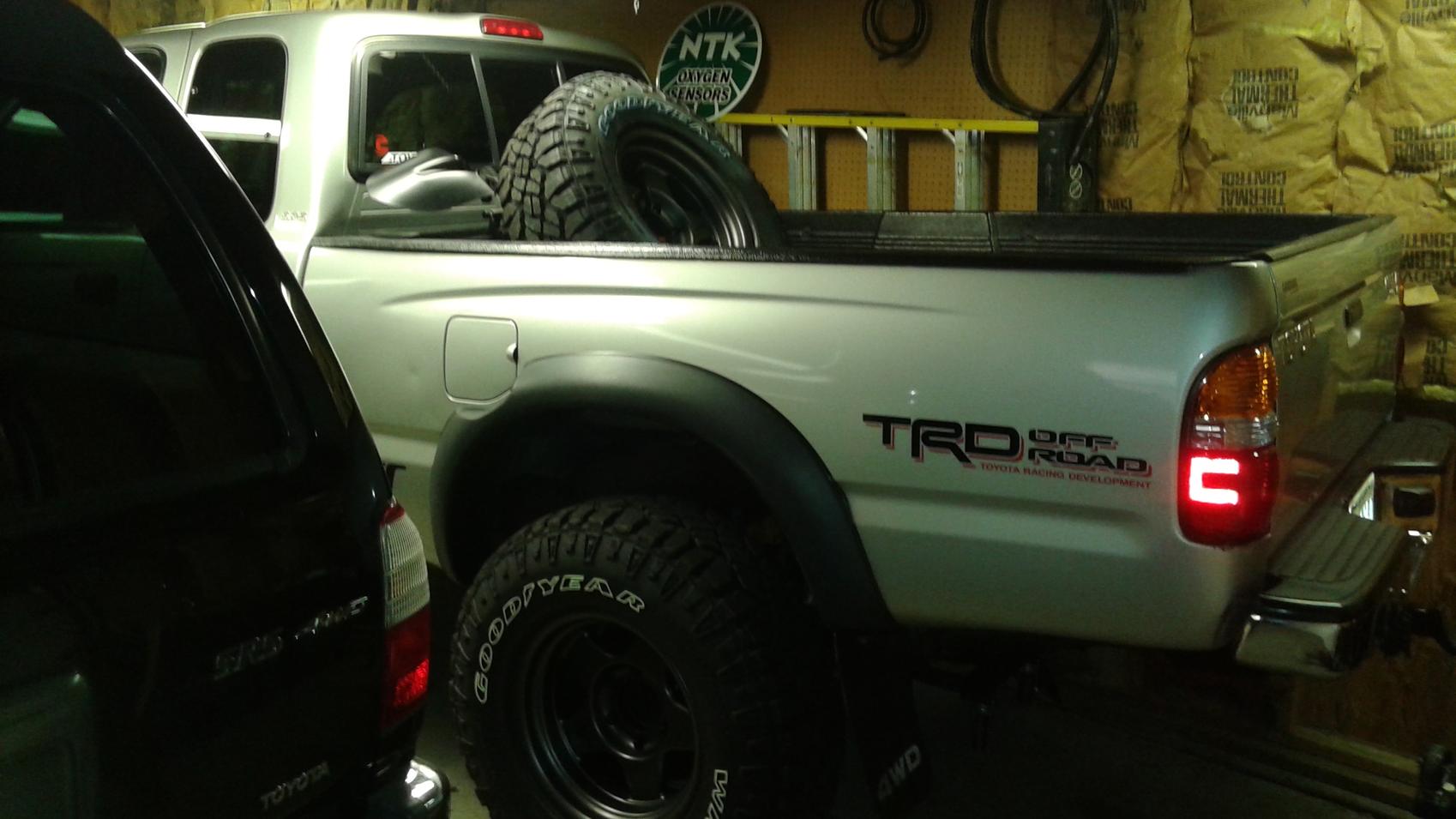

Buy a DD and leave the 4Runner parked all winter.
That's exactly what i do. The guys at work laugh at me because i have a lifted 4runner & a lifted tacoma and when the roads are snowy and/or salty i drive my beater honda accord to work. I tell them my trucks are hibernating in the garage for the winter, lol! Even tho' my yotas sit most of the winter i still spray WD-40 inside and on the outside of the frames, diffs, rockers, ect... My wife drives her 02 4runner daily(she loves her runner, she wont drive a beater) but i also WD-40 the undercarriage of hers many many times during the winter. Here's a pic of my 2 last winter.
