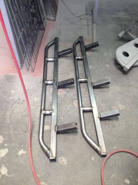

Finally got back around to Jerry's to start/restart my sliders. I'm going weld on and the KDSS on the driver side is a bit of a challenge but we'll make it work.
