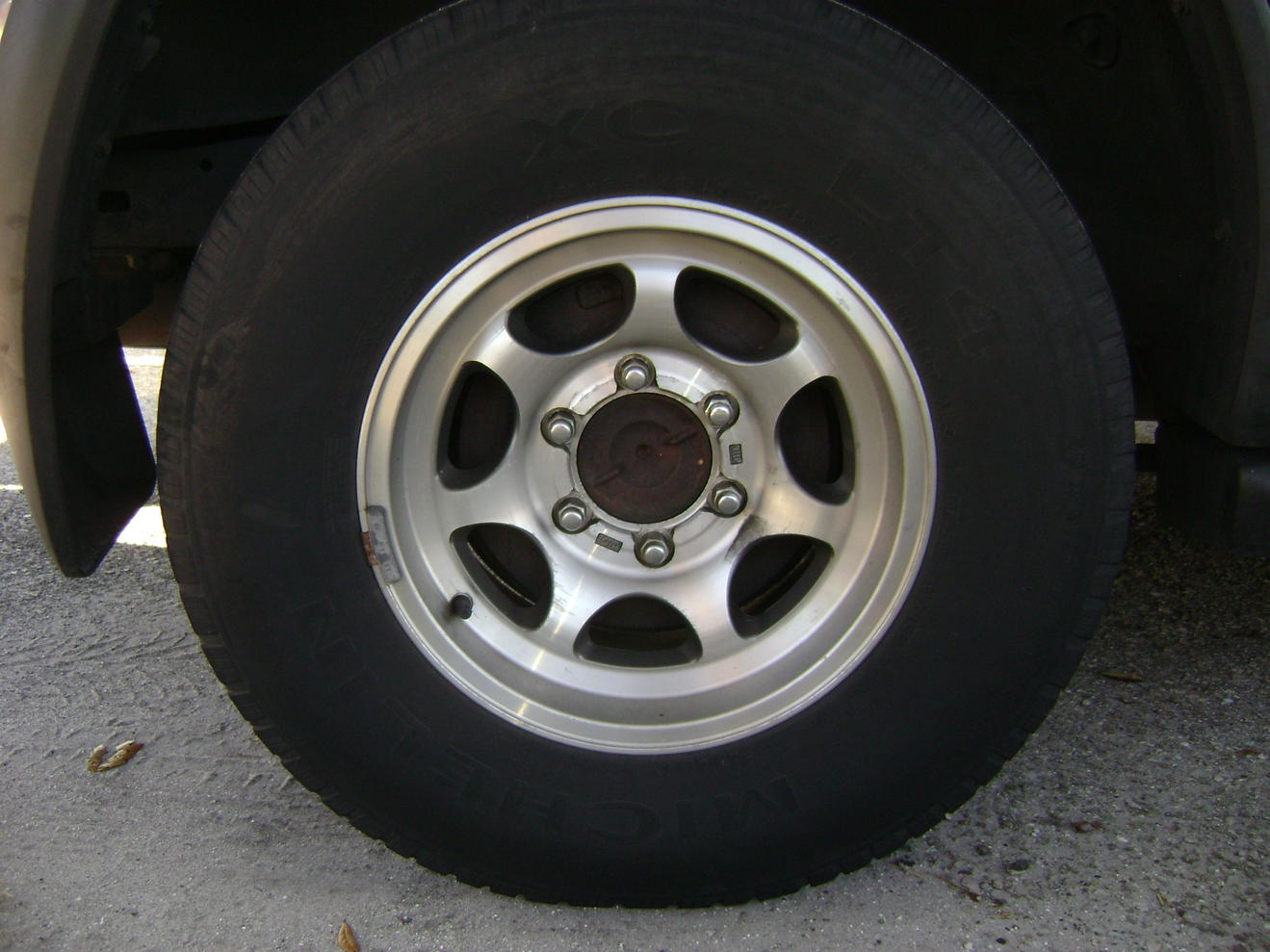

I have the 15" Enkei that came as an upgrade on the 99' and hate them.

Mine came with the same wheels, I believe they were 225/75 r-15. which came out to about 29.5 inch diameter. Not sure what will fit, but going up to a 30 or a 31 wont cause much of an issue. I went up to 33 inch and the speedometer is off by about 18% and I could tell there was some performance loss but not to the point of making it un-drivable. I was in the same place you were, but now looking back i kind of wish i had kept the stock Enkei wheels and just painted them black.
