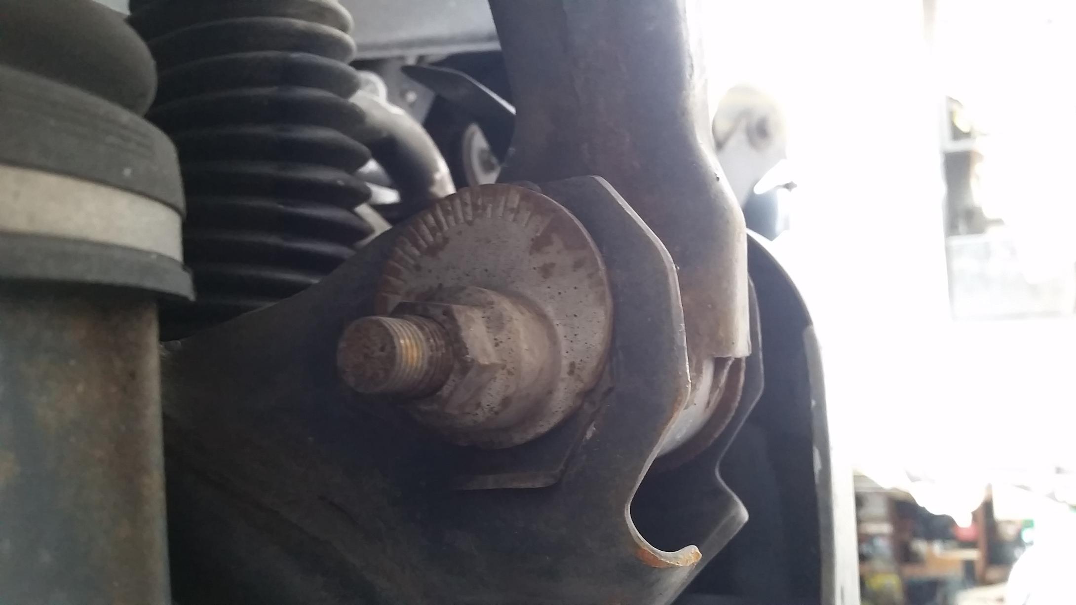

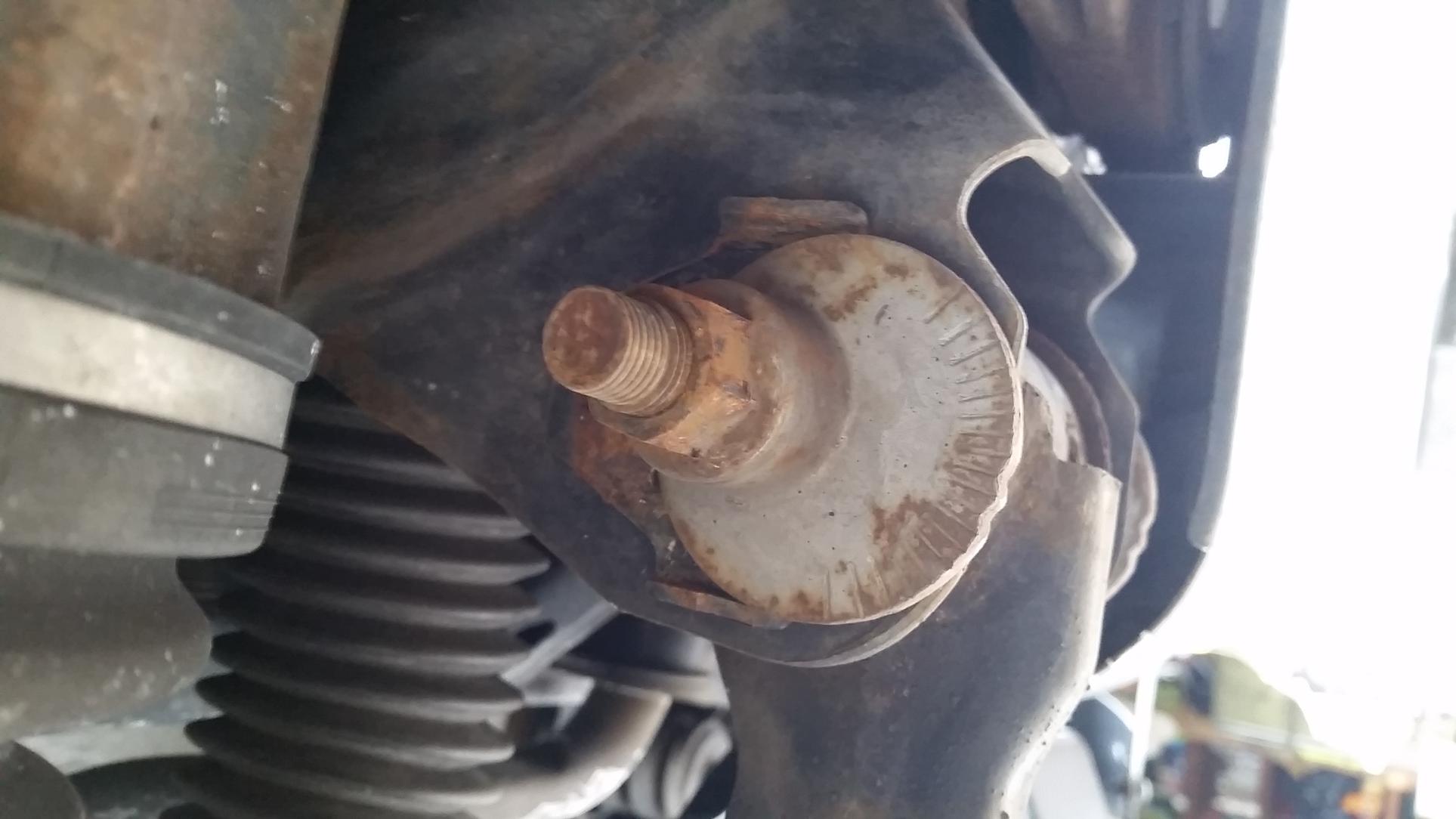

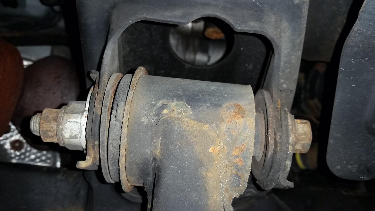

Hi all, I seem to be having this same issue after doing the Bilstein 5100 front lift. The tech left the front with .6 positive camber on both sides, 2.7 caster, and .05 total toe. Drove fine so I thought nothing of it. 2 weeks later now and I'm noticing feathered edges on the outside of my front tires. I checked the alignment myself and I am showing 1/4" of toe in??? Camber is still .6 on the RF and now .1 on the LF. Caster is still 2.7 both sides. Attached are pictures of 3 of my eccentrics that look like something is f*d up? One of them is upside down, another has the eccentric in 2 different adjustments on the same bolt causing it to be at an angle in the bushing, the other has the eccentric over top of the tab.
Yeah, that alignment needs to be redone - and that tab is probably bent, from the looks of it.
In that second pic, that cam adjuster looks way off. Maybe the bolt wasn't tightened enough by the alignment shop and it was able to turn on it's own.
I agree. Cam bolt on one pic is not flush and looks loose. You need to get it aligned again and at a different shop. Tell the shop you want 0 -.1 toe in, 0 -.1 camber and as muck caster as possible. You should end up with 1.5 - 2.0 caster on stock uca's.
