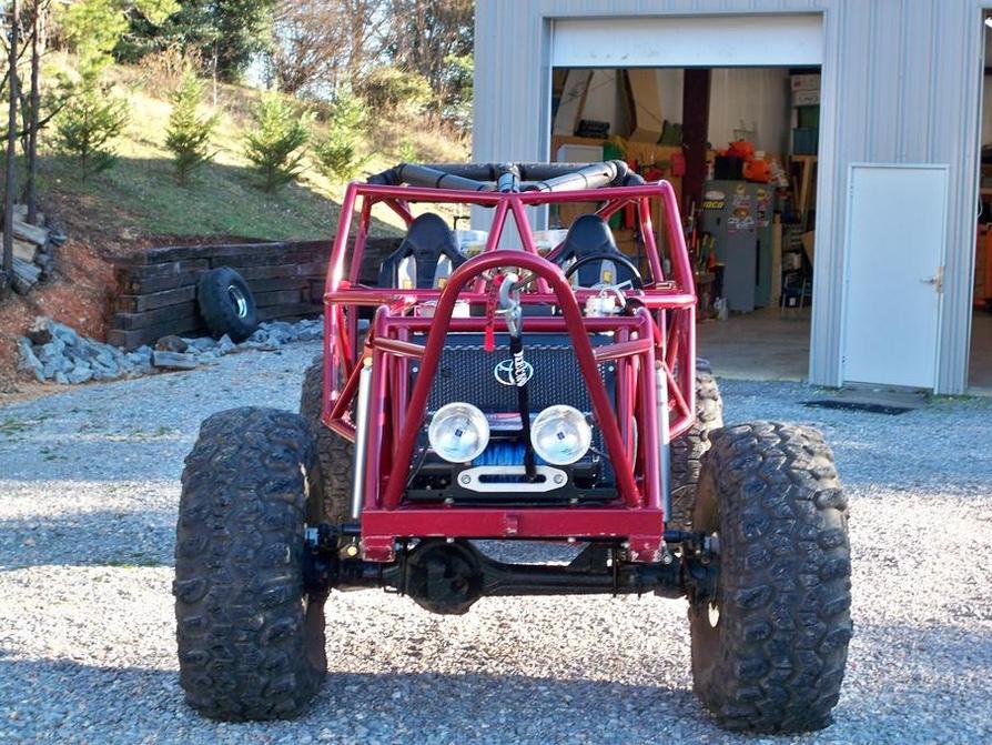

I ran the all pro spacers on my buggy torqued to spec and they never gave me any trouble. Had them holding 42's TSL SX's on 2" backspaced beadlocks with Lincoln lockers. I ran them for three years and would use them again in a heartbeat.
We're going to need to see your "Buggy" thread in the Gallery section, please! That thing looks awesome!
:clap2:
