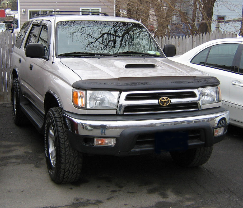

If you have 99 tall springs you can run 275-70-R16's, I did it for 10 years with no issues.
This is what Bridgestone Dueler 275/70/R16 AT's look like with stock 99 springs & stock wheels.
