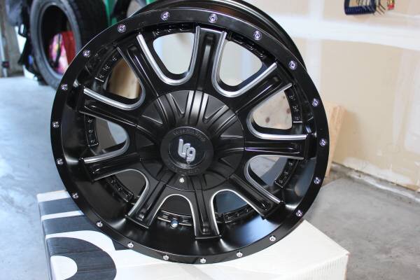

So I was thinking of getting some wheel spacers. Reason I was thinking about them is cause i got some wheels at a really really good deal but the backspacing i figured out after the fact would require me putting in some spacers.What I was wondering is how do people feel about using wheel spacers.
Also what would you suggest for spacers. thanks

yeah i realize that now but i got them at the 4wheel part show brand new set for $100. So another $200 for spacers is not a bad deal i think.
What kind of wheels did you get for $100? A whole set?
Wheels

[MENTION=69819]FactoryRide[/MENTION] yeah I went to the 4wheel parts jerp and truck fest and got them in the swap meet area.
