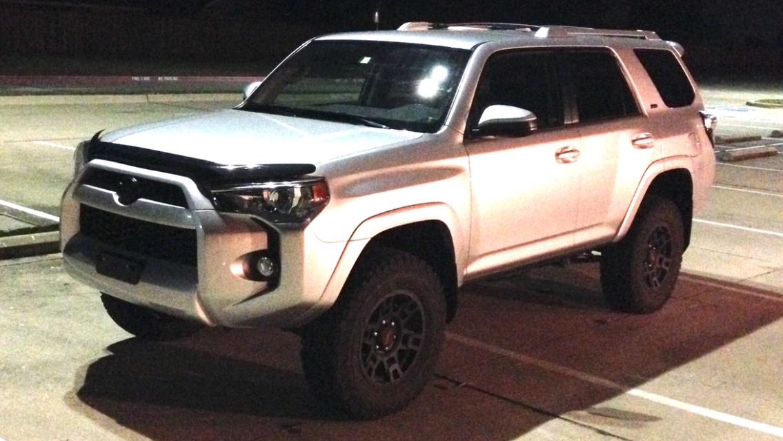

I'm sitting at Firestone getting mine aligned right now. Installed T1 coils on Old Man Emu shocks on the front and OME 895E coils in the rear last night. Here's a pic from about 2:30 this morning.

[MENTION=146493]TXBulldawg[/MENTION] Damn looks good! That's the stance I'm looking for. You running any aftermarket UCAs? What's the post-lift measurements looking like as well?

No UCAs yet. I've never had to use them before. Castor is obviously out of spec, but I'm going to see how it handles before upgrading.
I've only got 20 or so miles on the suspension so far, but initial impressions are favorable. The ride is very firm. I think some people would call it "sporty." The Wheeler's/Eibach springs have a 620lb rating, IIRC. The OME rear springs I believe are 590lb rated. Definitely eliminated the nose dive so many people complain about. Some people might not like the ride. Some might love it. I guess it depends what you're used to. If you're accustomed for a 1974 Oldmobile Delta 88, this probably isn't the suspension for you. If you've driven trucks, Jeeps, and SUVs all your life, you'll probably be right at home.
I have pre measurements. I haven't taken any initial post measurements, yet. I'm going to give it a little bit to let the suspension settle. The increased height is definitely noticeable getting in and out. :D
Looks good! I like that some of the rake is still there. Keep us posted with how things go after the settling.
