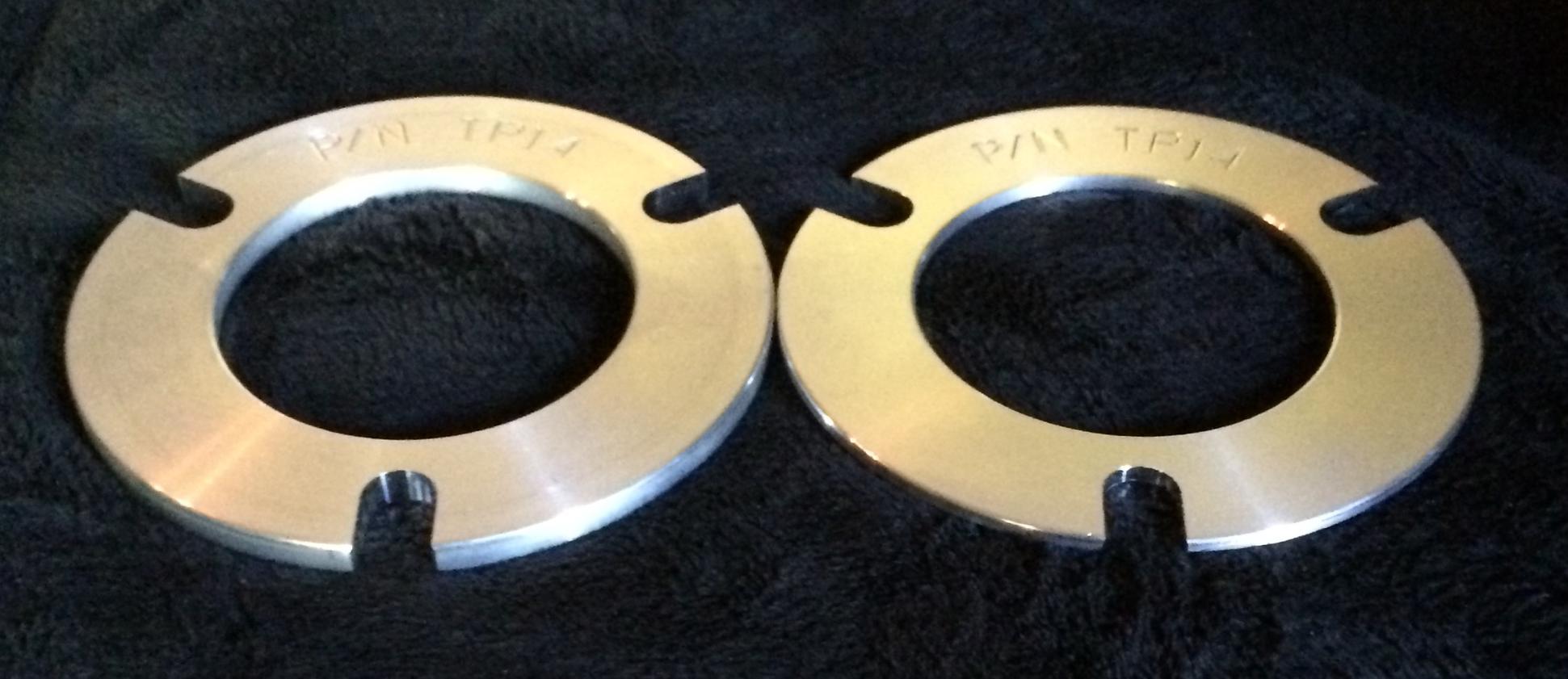

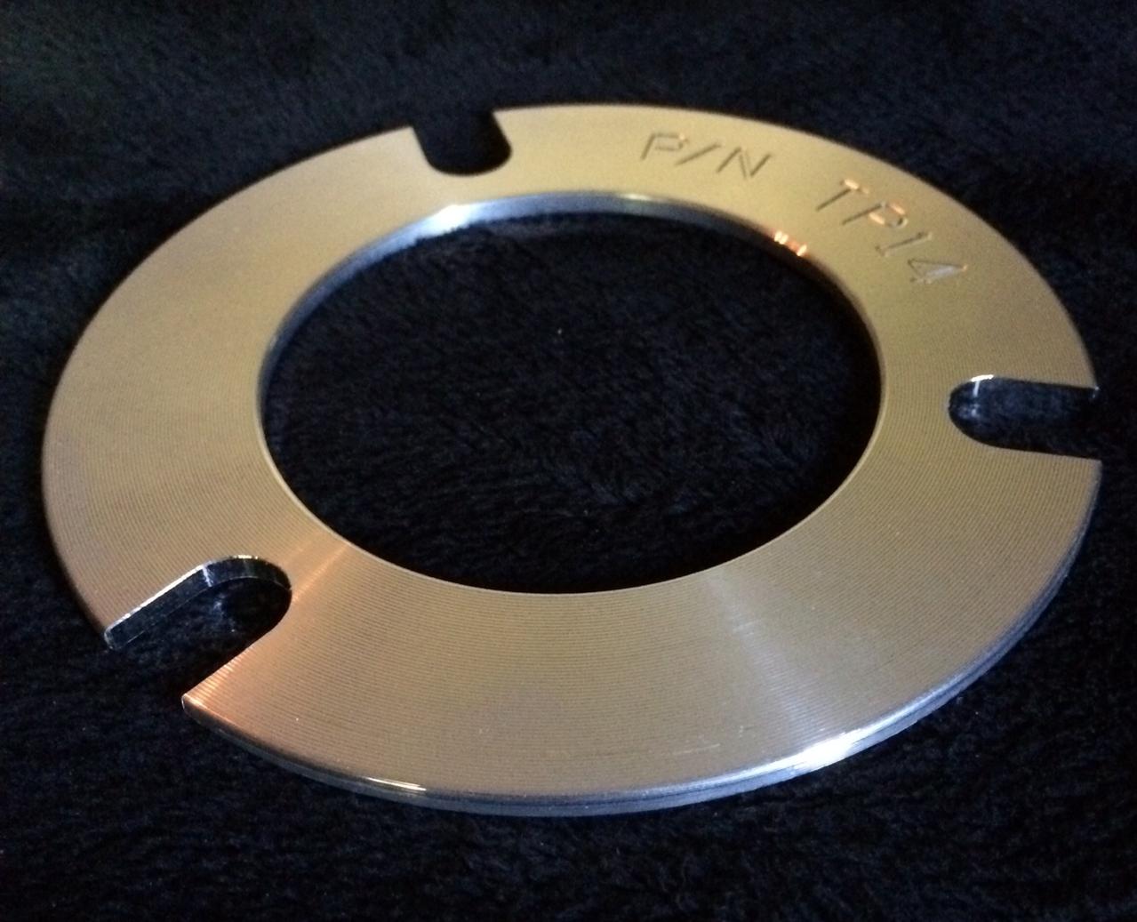

I got my Modded Toytec TP14 spacer back from being faced to 1/8" thickness (BTW it looks awesome! :clap2:)
I hope I don't need it but will have them in case I do!
So the 1st Pic is both side by side, 2nd pic is the modded TP14 1/8"thick!
Thanks again!

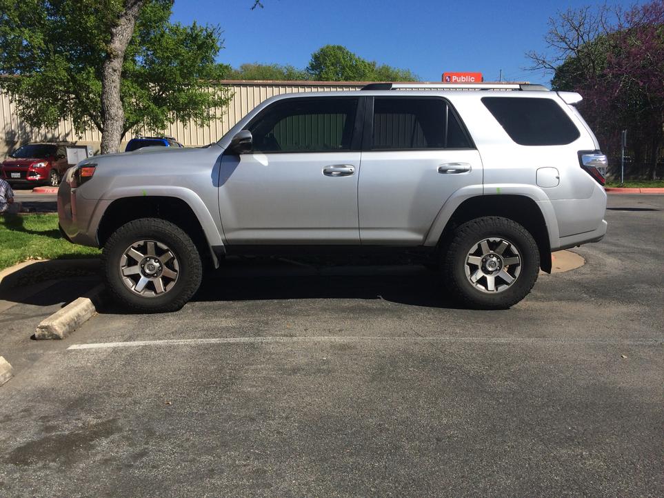

So finally got it in and aligned and with a full tank of gas here's the before (stock), and after with TP14 front driver spacer, 6112s set 4th up, 5160s with 1.5" top spacer, measured floor to fender (tape over hub for ref):
Stock:
Driver front 34 7/8
Passenger front 35 3/8
Driver rear 36 1/2
Passenger rear 37
Lifted:
Driver front 37 1/2
Passenger front 37 7/8
Driver rear 38
Passenger rear 38 3/4
Maybe our setting for the 4Runner reflect more on the 4x2 lift guide off the Tacoma
Seems like everyone on the 4th setting is getting atleast 2.5" of lift
