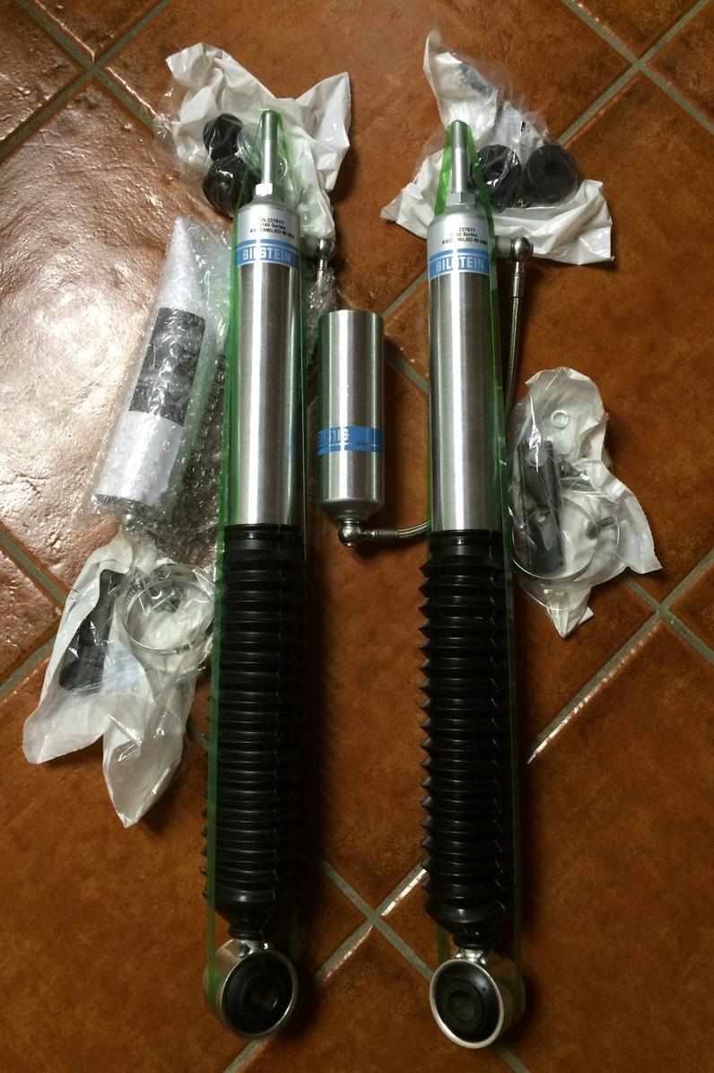

5160's
Well well, look what Brown did for me, again today.......
The 5160's came with the Bilstein Shock Boots and the Remote Reservoir Fixture designed to bolt to the frame....so it's ready to be installed, but, I prefer to wait on the Billet Clamp before install...it hasn't arrived yet!
Thanks Chas [MENTION=120150]TotalAutomotiveLV[/MENTION] !!!!
[MENTION=103267]Saker[/MENTION] which way are you going to install the reservoir on the 5160? The instructions say to orient main shock so that the hose fitting towards the rear of the vehicle and orient the reservoir so that the hose fitting is on the bottom, which would put it upside down (Bilstein letter upside down).
If you look at the videos and literature of the 5160 with the billet clamps, they have the orient reservoir so that the nipple is on the top.
I'm thinking the reason they tell to orient the main shock hose fitting to the rear and the reservoir hose fitting on the bottom so that it can work with the frame clamp, but if you're using the billet bracket, it doesn't matter.

I think before I do anything in reference to mounting of the reservoir, I will call Bilstein to make sure it can be mounted with the fitting in either direction.
The remote reservoir looks different than the one shown in the vid....it may make a difference, and then again, maybe not!
If you call them, please post the response!

I called Bilstein this morning, spoke with a Tech and asked about mounting the reservoir with the Billet Bilstein Clamps and the orientation of the hose that [MENTION=120875]sigbrown1297[/MENTION] raised the question on.
Bilstein stated since the reservoirs are under pressure it doesn't matter how one orients the remote reservoir.
So upside down right-side up or sideways, you will be ok!

Got the billet brackets today. Having the reservoir with the hose fitting on the bottom definitely has less tension on lines. They are steel braided lines so it should be okay. I do think it looks better with the hose fitting on top. I'll prob go with top as long as the lines doesn't interfere with anything. I'm guessing it will be a good idea to putting some thread lock on screws.
Got Momma home from the hospital but 5 days of hospital chairs 24-7 has my back out. Will go to chiropractor in a few and hopefully remedy that so I can install tomorrow. Going Res up in the billet brackets.
The 5160 setup is lookin' good, and I'm really looking forward to your install!
