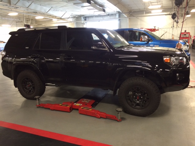

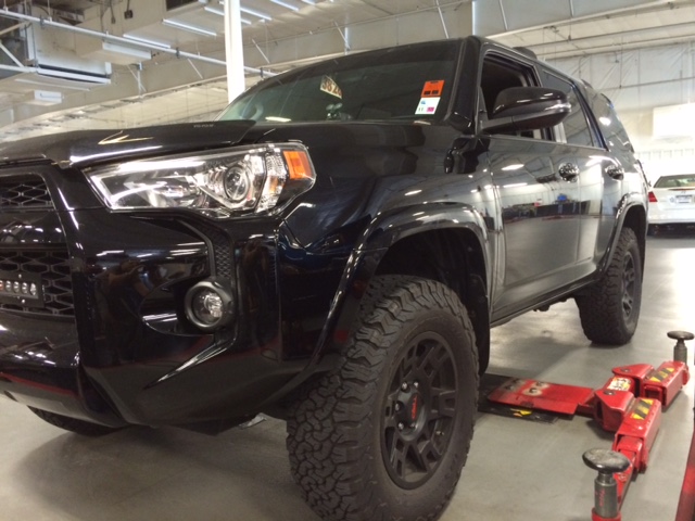

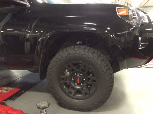

So finally got it in and aligned and with a full tank of gas here's the before (stock), and after with TP14 front driver spacer, 6112s set 4th up, 5160s with 1.5" top spacer, measured floor to fender (tape over hub for ref):
Stock:
Driver front 34 7/8
Passenger front 35 3/8
Driver rear 36 1/2
Passenger rear 37
Lifted:
Driver front 37 1/2
Passenger front 37 7/8
Driver rear 38
Passenger rear 38 3/4
So about 8 days later of normal weekly driving:
Driver front 37 3/8
Passenger front 37 3/4
Driver rear 38
Passenger rear 38 5/8
Not much going on there as far as initial settling. Then again I didn't expect much. Rear springs didn't change, and the spacers had already previously been used on her FJ. Front top end was reused on a 11mo 2014 so any compression settling in those parts was established as well... leaving only the spring for any potential movement... for the most part.

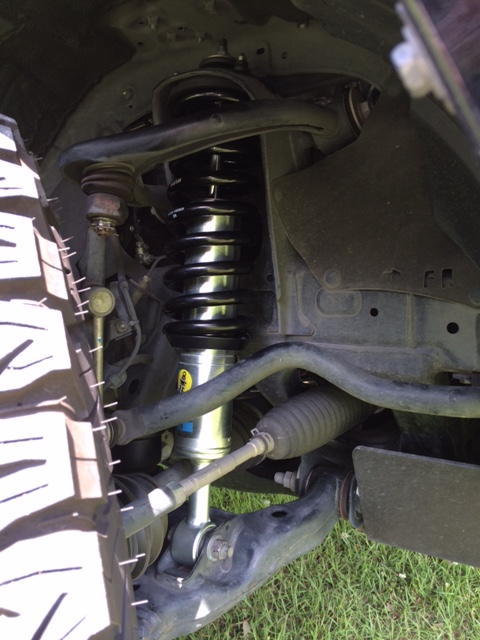

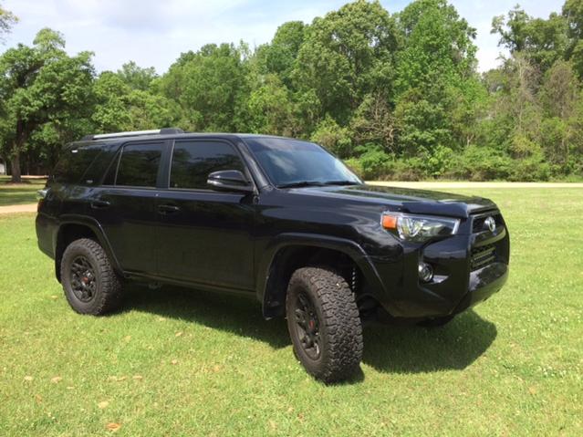

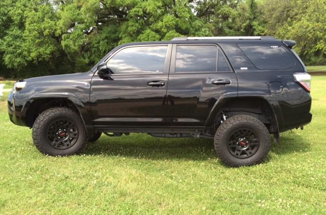

6112's Installed
Status Report:
After seeing what the lifts were at the different spring seat circlip grooves, I decided to place mine on the middle groove and shoot for a 2" lift.
It came in at exactly 2"
Front L & R Side = 37"
Rear L & R Side = 37"
Alignment done...drives really good and nice ride quality with these 6112's!
Photos included!
I threw in a flex photo. Flexing in a small ditch...
oh... I almost forgot.... :reddance: :party: :party::reddance::
