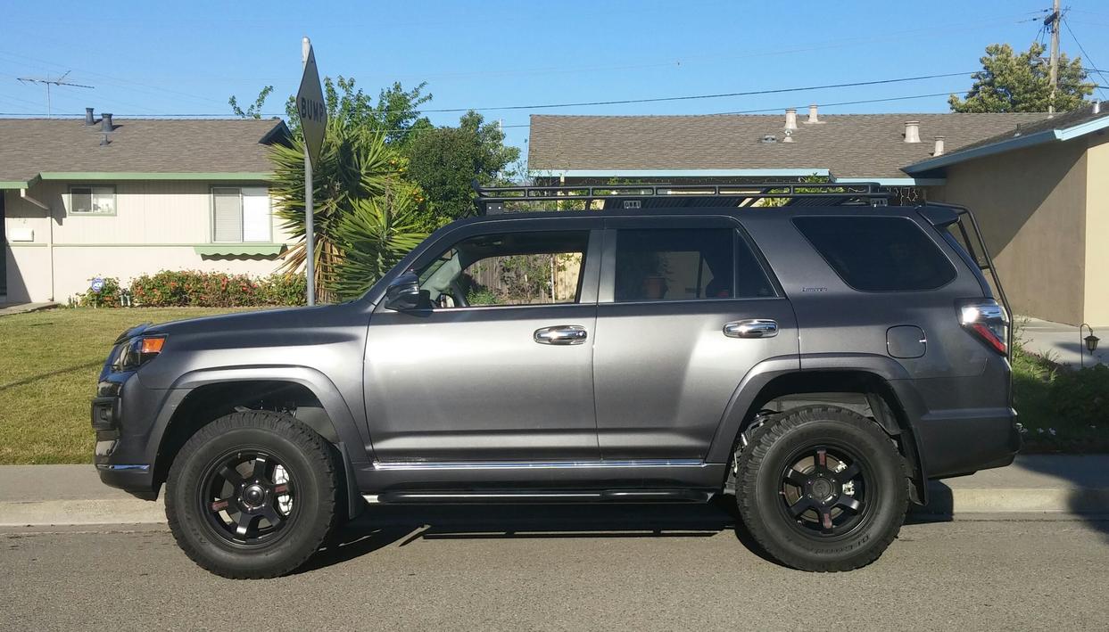

Finally got it install. I'm on the 4th setting.
2.5" front and I'm actually getting close to 1.5" rear with the SAW
...and it looks great. Should have plenty down travel left. However, what do you think about the ride? I'm always function over form!
Hard to tell at the moment but my initial feedback is it a little more comfortable and plushness overall. Feels closer to when I had the P-metric tires at 32psi. As for the nose dive, it's about the same, maybe a tad more if any. I actually notice more body roll on high speed and moderate speed side to side compare to my Xreas. Still need to get an alignment and put a few thousand miles to have a better comparison

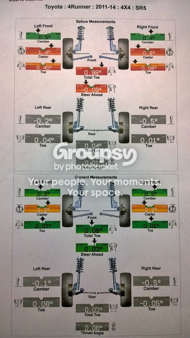

Yes that's after the alignment.. My alignment guy can't get it back to factory spec or within Toyota spec.. He said I have some camber because is higher than stock. Guess I need to pay them to put it back to lowest setting.. Could any of you guy get the alignment back to factory spec or within ? This is on factory uca, wheels and tires..
talk to rhino about the alignment at 1.75"
I'm at the 4th setting at 2.5" This was the best they could do on the cast with the factory UCA.
