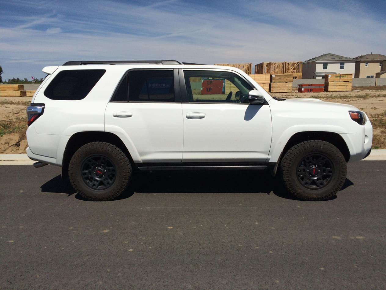

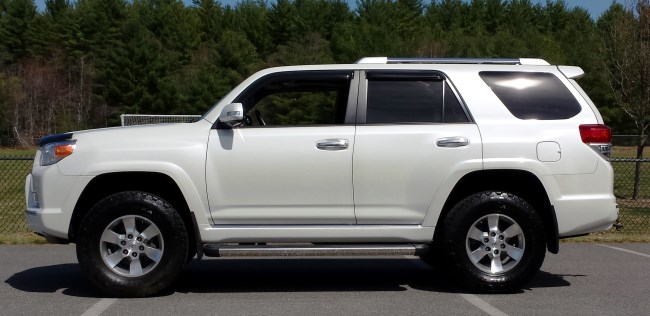

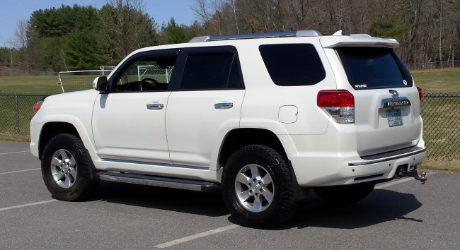

Yes, mine are on the second groove(0.5 inch average lift). I'm down from the 1.75" to about 1.5 inches above factory in the front now. Installed the 5160's on the rear a couple weeks ago and then had it aligned a second time last week. Gained about 1/8" in the rear with the new shocks. My alignment specs are in the green and almost exactly the same as 4Runner714 specs. Really like the ride, very stable and absorb the big bumps nicely. Here are a couple photos:

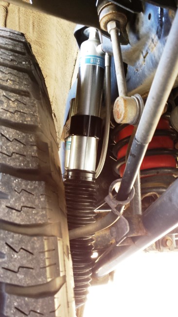

Installed front shock boots & rear brackets.

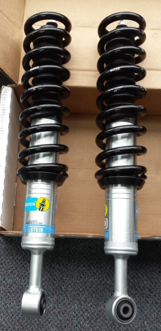

Installed today, can confirm 4th setting equals Daystar 2.5" spacer.
Very impressed with the ride quality so far. Alignment is close, but will have it checked this week.

Looks good. Looks like we are seeing consistent 2.5" lift on the 4th setting. Bilstein should do something and update their info...
On an unrated note, its amazing the difference on the amount of rust on the underside depending on where you live. Just looking at your pics I could tell you were up north somewhere. Bought mine from a guy up in Maryland and I have some rust on my from the salt/brine.

Boots are generic, Pro Comp cost $6 for the pair. They are long, so when sliding them on keep pulling down until the top of boot is same height as top of piston, then trim off the excess (think it was like 5 ridges) and add wire tie.
