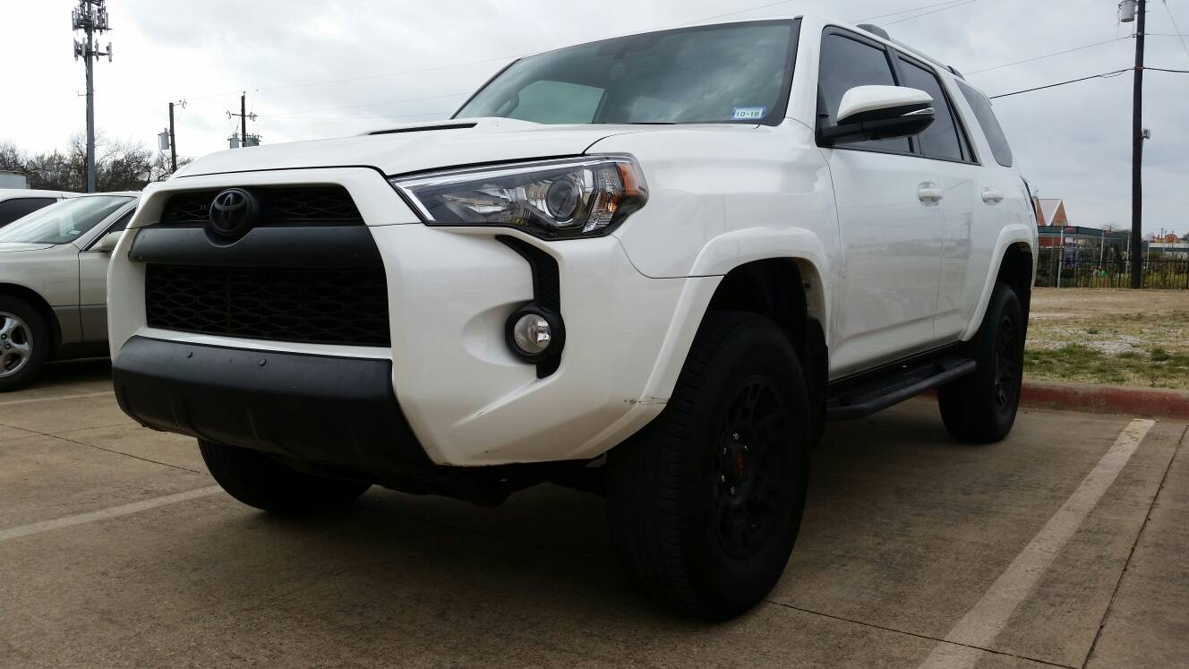

3rd clip w/ ICON 2" rears from local customer [MENTION=136709]Myron_Hensel[/MENTION]

It's the angle of the photo or the lense used, makes it huge.
Plus, the passenger tires are probably sitting in a ditch/off the road surface at a lower elevation causing the whole truck to lean that way. Terrible picture to showcase lift height on an adjustable suspension, but still a cool shot.
