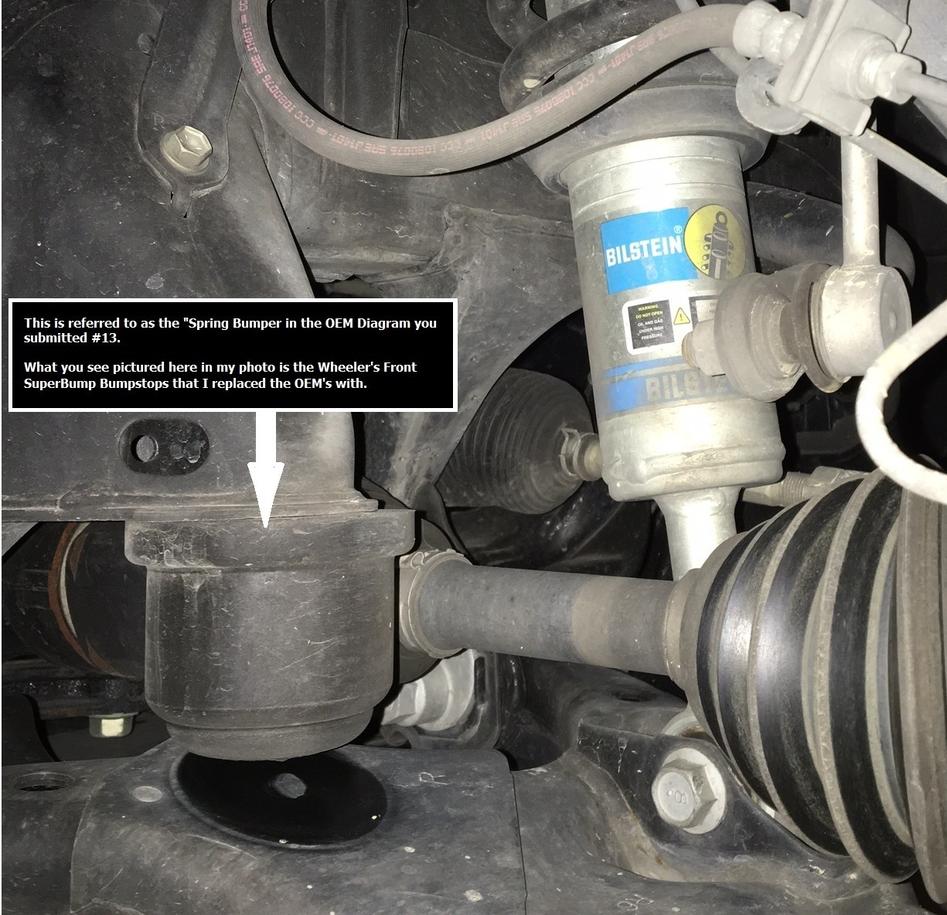

For those who have done the installs themselves. I am trying not to reuse any of my original strut components. So I ordered all new parts using the OEM list mentioned earlier in this thread. However, it appears to be missing one component.
From pictures I have seen of the OEM strut there is a bushing that sits on the shock's shaft that is supposed to act as a secondary cushion in the event the shock bottoms out. I believe its part#13 in this diagram:
Can anyone confirm this? Did you guys just transfer it to your 6112 setup? Thanks in advance.
[ 13 ] FRONT SUSPENSION / FRONT SUSPENSION / STRUTS & COMPONENTS / Spring bumper
Part Number: 4830460150
spring bumper 4WD Right
This:

This:
why did you add this in? I thought one needed longer bumpstops for extended travel setups???
:confused:
:confused:
All I was doing there was clarifying what part #13 was in post #444 as described for Xtremluck.
That's it, he was a little confused as to that part.... :wink2:
