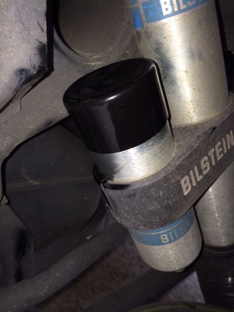

im concerned about that mounting, I have it the same way, it seems like a perfect spot for salt water/snow to sit and rust out?
For some reason, those caps make me think of those annoying Flex Seal commercials. Dipping reservoirs into flex seal...
That's pretty weird to think like that IMHO! j/k
All I know is, mine has been in place and its a mod that will keep out unwanted debris/water/mud/dirt/salt....etc.
This is fantastic!
...time to clean existing gook out and pick those up!! I saw the water there already, and then I just imagined salt on top of it..... recipe for disaster!
We have to thank [MENTION=81322]barryhiram[/MENTION] for sourcing that "perfect" product locally and at a very reasonable price that works great.
I thought about an easy fix, he thought about an easily acquired item that works! :first:
