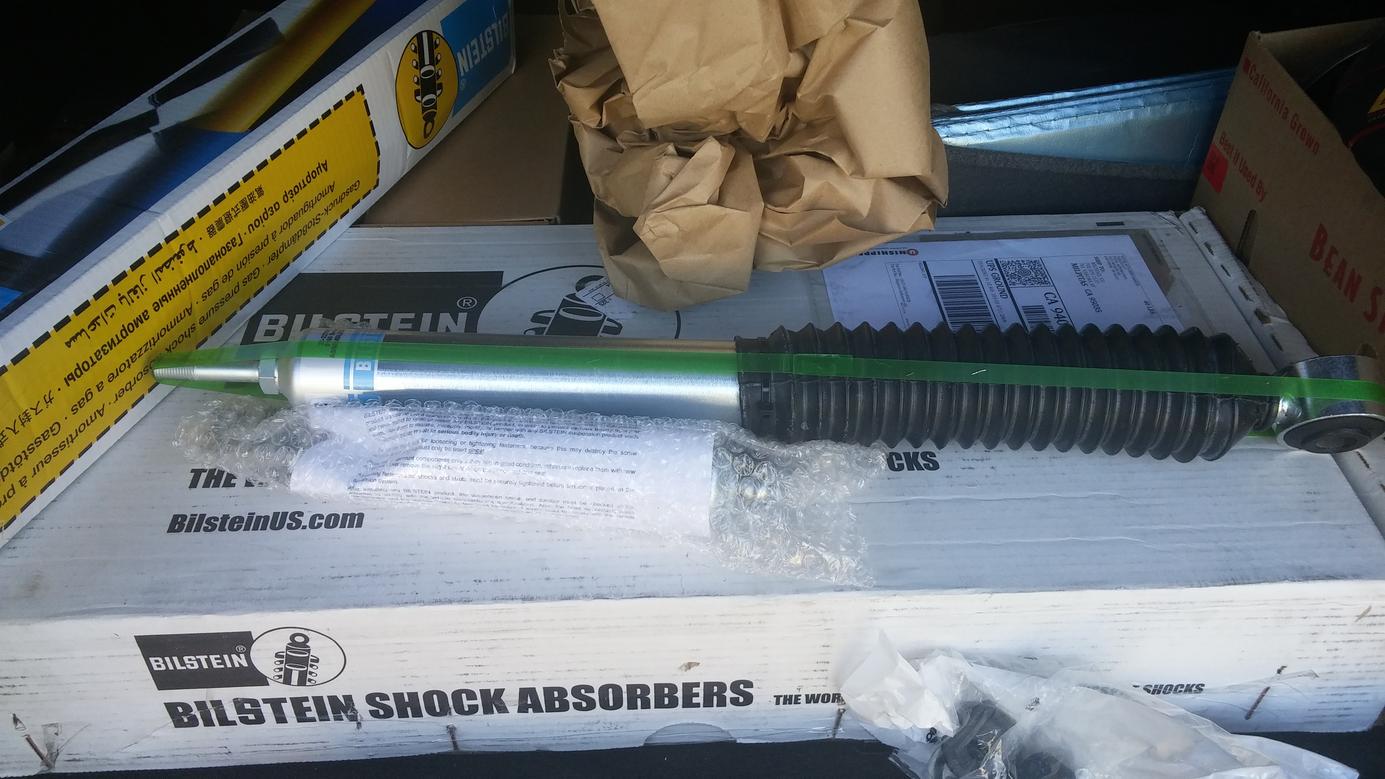

When will the Bilstein 6112 be released?
You didn't think you going to save money did you? j/k
Sweet on receiving all 4 shocks!
On the boots, you didn't order them with the shocks from Chas???
Bilstein said they were not included with the 5160's!
Chas musta sent you mine! :lol:
Nope, it came attached to the shocks.=)
but hey, we can trade, I'm missing the billet mount, they must have sent it to you instead. =)

Im not wanting to spend 160 on extra set up strut mounts but not having to get a spring compressor to transfer them out may be worth it. I may try the Moog or KYB strut mount kits.
Ohhhhh, I see what you did there! :whip:
That's funny!
I hope mine comes from Bilstein with them installed, that would be saweeeet!

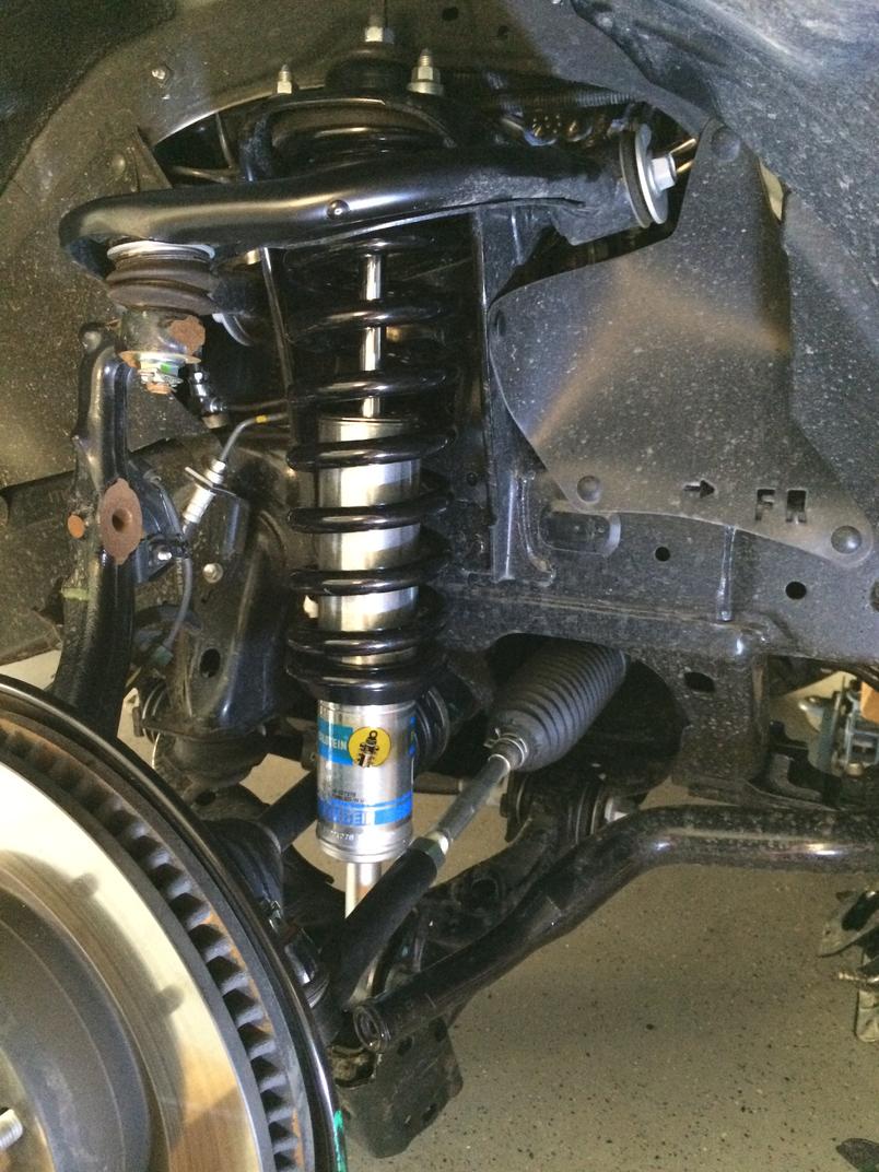

Sounds like I was one of the lucky ones to receive the 6112's about a week ago. Just finished the install on an otherwise stock 2015 KDSS suspension. Thought I better share my results. Using the 0.5" average lift circlip grove setting, I measured a change of +1.75 inches in ride height. Drove it a bit to see if it would settle, but no change. A little more height than I wanted, but looks pretty much level. Helped a little to relieve the annoying nose dive under braking, but really softens up the bumps nicely, not that it wasn't already pretty smooth from the factory. I'm curious to see what other people get for ride height change.

Looks beefy :) So you got 1.75 lift from the lowest setting? Those grooves are 0.5 increments right? Did you do the install yourself? Post of pics from the side.
How close is the strut to the CV axle? Looks like its touching the strut from that angle..

I used the second lowest setting, the second groove up from the bottom. It's the groove that the Bilstein instructions call their "0.5" AVERAGE LIFT". The grooves are about 10mm apart. Did the install myself, but used a local 4x4 shop to compress/remove the factory spring hats and reinstall on the 6112's. The change in ride height is about 1.75" average between the two sides.
The CV axle is about one inch away from the strut.

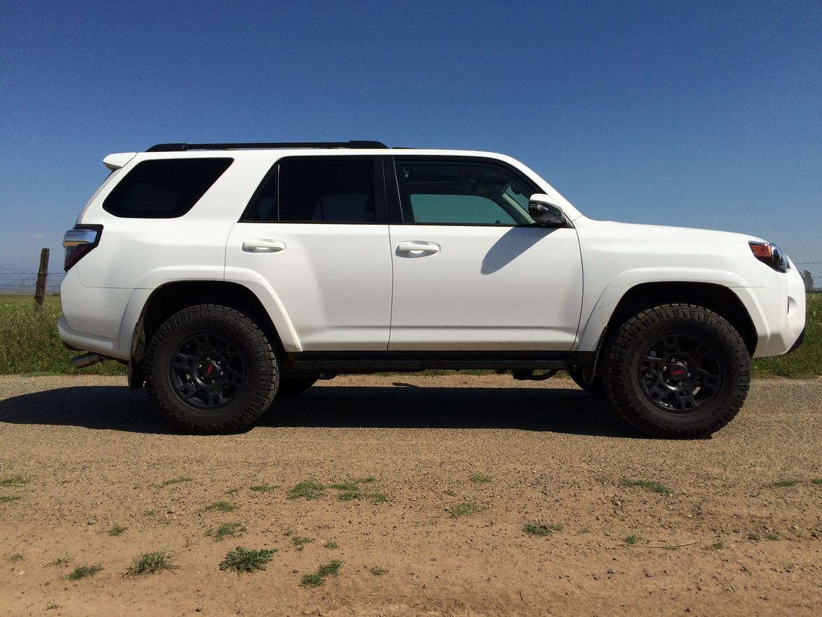

Here's a side view, looks a little nose high to me?

Looks great! Very close to level... I like it! Exactly what I'm looking for.
But, I don't want to do the install more than once because the Bilstein info is off ... Maybe Chas could address this issue for all of us.
if you're just looking at the wheel well gap, it looks even, but i see what you mean about looking nose high. Looking at the roof line or side skirt, it does look like it tilts up towards the nose.
Its probably something the most people won't even notice and when you're sitting in it with a passenger, i bet its dead even.
