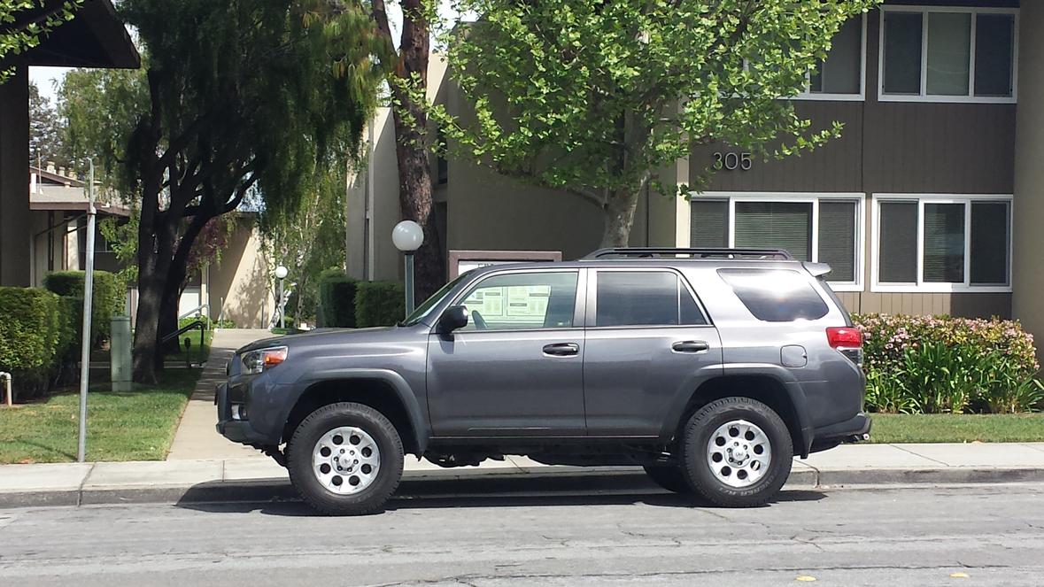

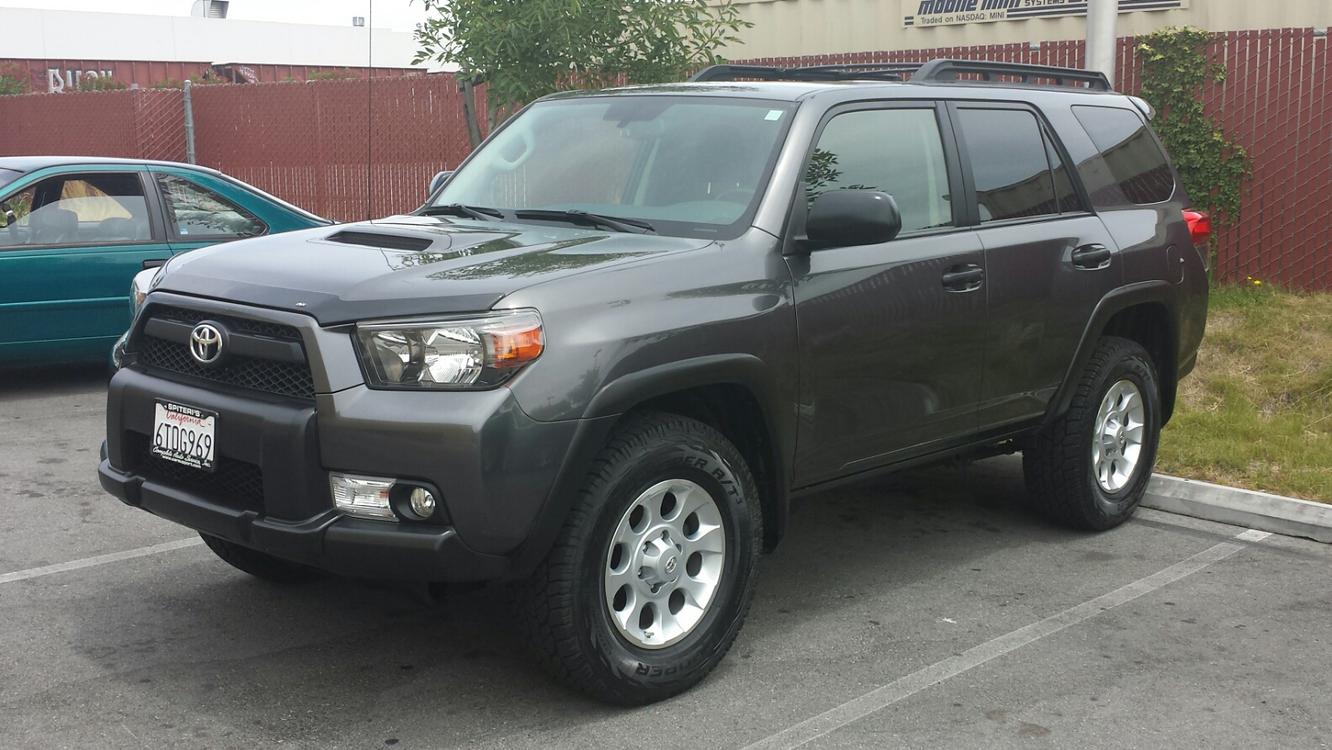

Here are some before and after shots. Keep in mind the street is slightly slanted down hill in the second shot
Yes i had them re use the original mounts as they were still in great shape. I'll be returning the new mounts. With how high the front end looks compared to the rear I am guessing 3+ inches, but i may be wrong
Yeah, looking at pic, i bet you are at least 3. Is the rear stock?
Yes the rear is stock.
On a side note the ride is very smooth, even smoother than stock. I drove down a bumpy road and i swear it just floated over the bumps and dips.
