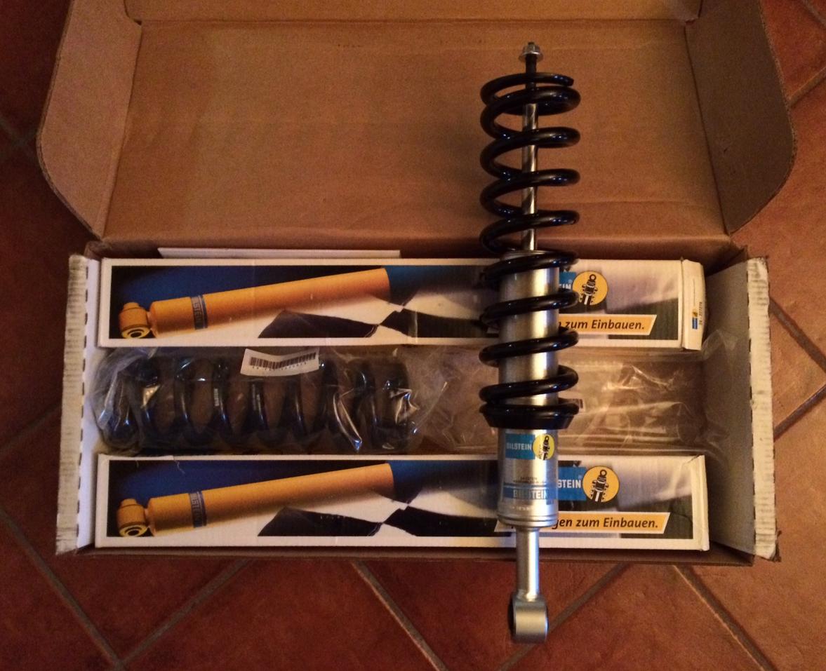

Well well, look what Brown did for me today.......
Addition: Got a notice the 5160's should be here next Wednesday!
Thanks Chas [MENTION=120150]TotalAutomotiveLV[/MENTION] !!!!

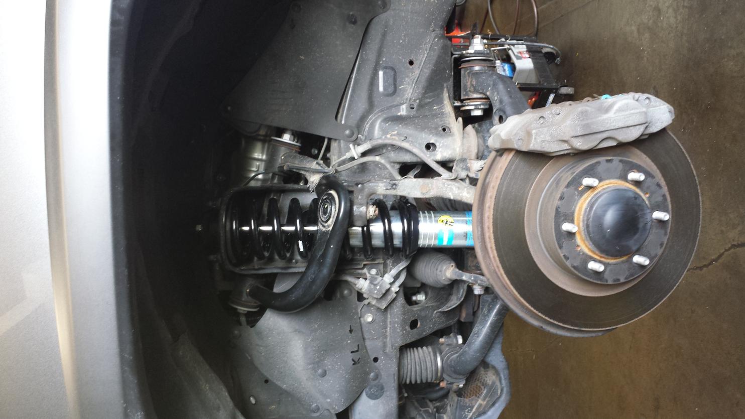

I used the second lowest setting, the second groove up from the bottom. It's the groove that the Bilstein instructions call their "0.5" AVERAGE LIFT". The grooves are about 10mm apart. Did the install myself, but used a local 4x4 shop to compress/remove the factory spring hats and reinstall on the 6112's. The change in ride height is about 1.75" average between the two sides.
The CV axle is about one inch away from the strut.
Here's a side view, looks a little nose high to me?

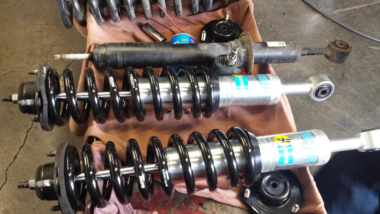

I wish I would have seen this thread sooner. So i had my 6112's installed today. I wanted a 2" lift so i set the snap ring to the 4th setting (out of 5) because the instructions that came with the kit stated the 4th ring location was good for 2" of lift. I ended with with way more of a lift!!! Im going to buy some small coil compressors and try to compress the coils enough to lower the snap rings 1-2 settings.
I didnt take measurements but im guessing i got over 3" of lift.
