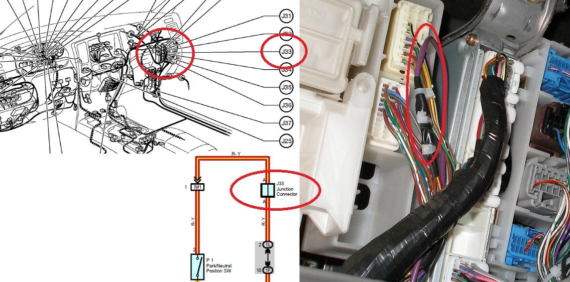

Hey Joe. I tapped into the reverse wire for the headunit at J33, which is over by the engine control module. I actually ran accessory power to the camera so I can switch to it whenever I want - not just when in reverse.
The wire going to J33 comes off of the park/neutral position switch, to J33, then on to a junction connector (J40), then to each back-up lamp. J40 is in back just forward of the bottlejack (under the trim). Here's a a pic of J33:

Well, the the pic in my post above (upper right) is of J33 and shows it's actually white in my 2003, but may be different in the different years (doubtful but possible). I would look for the red wires w/ yellow trace (there will be several) and check with a meter when you put it in reverse. Again, there will be several and they all will get power in reverse so it really doesn't matter which one you tap.

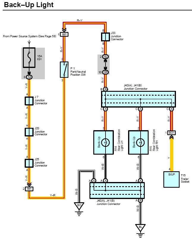

Here's a full diagram of the back-up circuit. I modified it a bit so it's not so long (stretched out), but the content wasn't changed.
