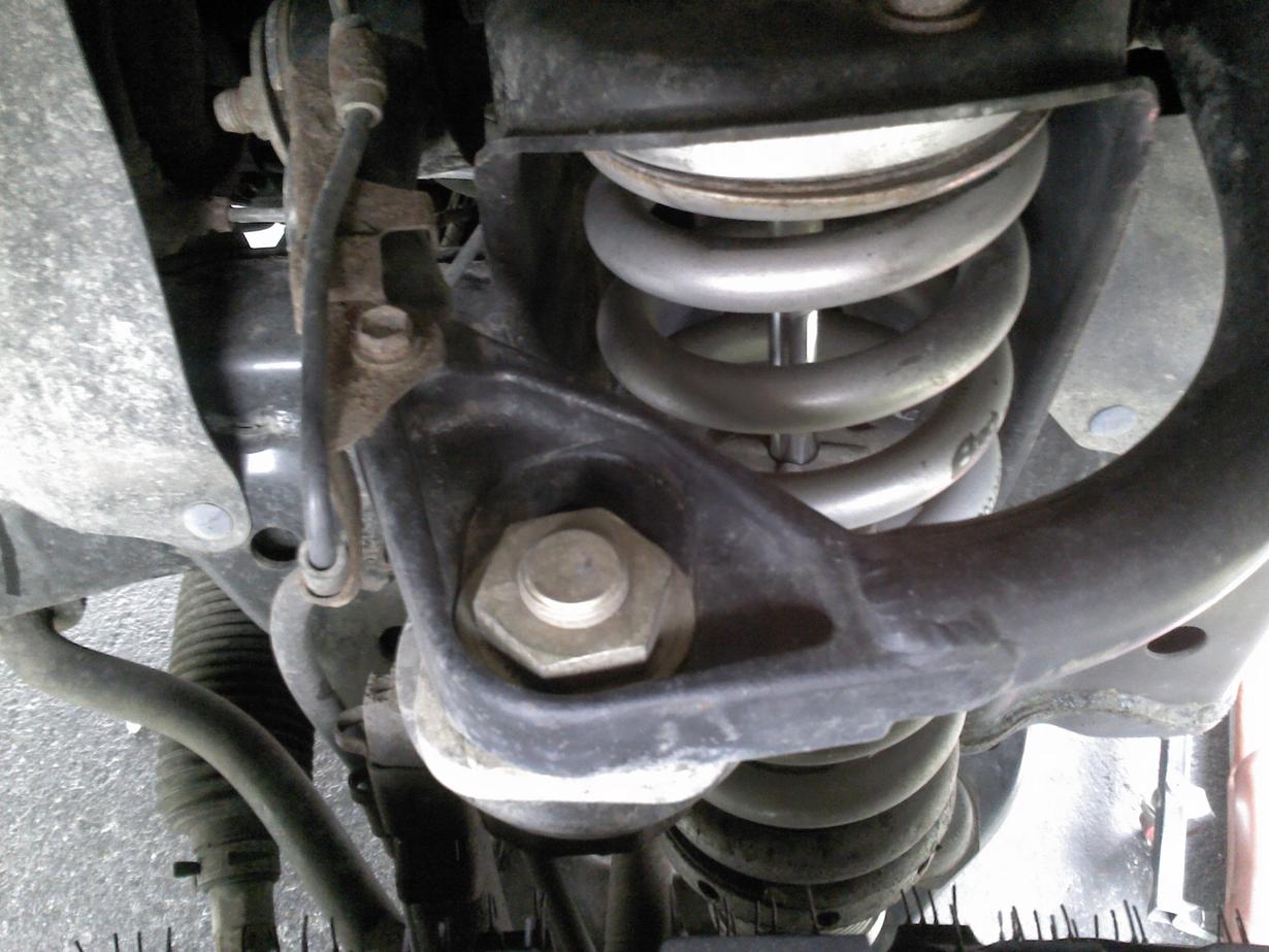

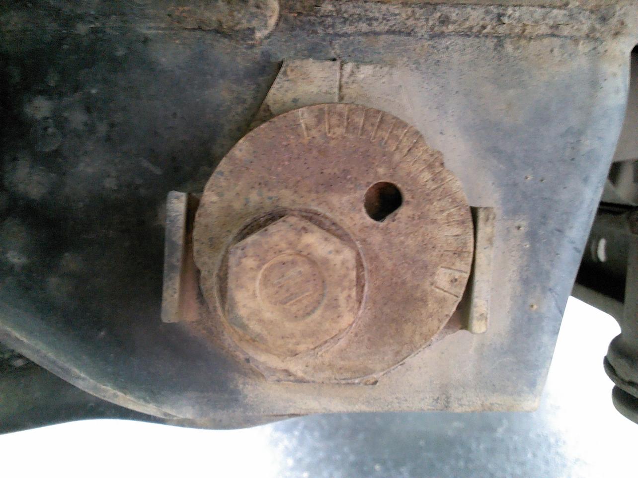

UCA's should be here Tuesday and swapping them Thursday. I'm guessing they should be setup at the 0 position?
A
Thats where I set the caster on mine and the camber adjustment as close to the center as I could. During alignment the caster was about dead center in the green range and minute camber adjustments on the cam bolts at the LCA.
However, I have the top plate spacer installed with 881 springs in the front. My front now sits higher than the rear so I need to pull the spacer out. You might want to go 1 or 2 notches towards less caster if you are not using a top plate spacer.
I have a 1/2" spacer and running LC coils so I should be right on or just slightly down (pretty much where it is now) in the front.
A
Thanks, I compared that to mine and was ablt to get to the alignment shop. Funny though I noticed your UCA boltis toward the tire and mine after alignment is in toward the vehicle.
