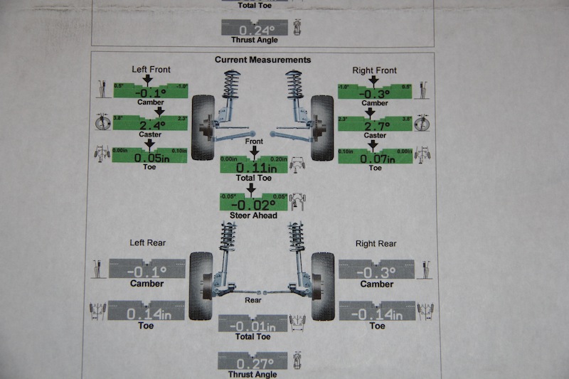

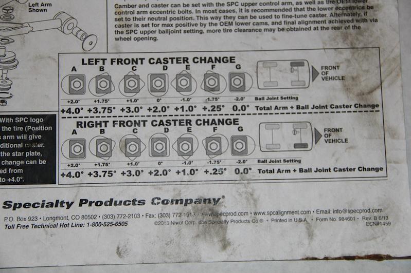

Definitely a good idea to do the UCAs at the same time as the lift. Knock it all out at once. Here's a snap shot the results of my alignment after the lift and UCA install. The SPC UCA's have an adjustable eccentric "plate" that can be changed to increase or decrease caster as needed. I left mine on "D". They were within my budget and I met a guy at an estate sale with total chaos UCA's and he said he wasn't happy with them. Hopefully the picture shows you the advantages you have with after market UCA's.

I'm in love with your caster!

Actually it doesn't make sense, you left them at "D" it is supposed to be zero in that position?
Yea, I had to read it twice when I installed them. if you leave the eccentric at "D" or zero it equals +2 degrees combined ball joint/UCA. If it didn't come in the positive during the alignment, I would have re-positioned the eccentric. Without the adjustable UCA I believe you're stuck with whatever the factory adjustment can get you to.
Yeah and the problem is that the factory adjusters are doing camber/caster at the same time so that sucks.
The arms I bought are fixed caster but gives you and extra 2.5 degrees and then you adjust by the factory adjusters to fine tune.
