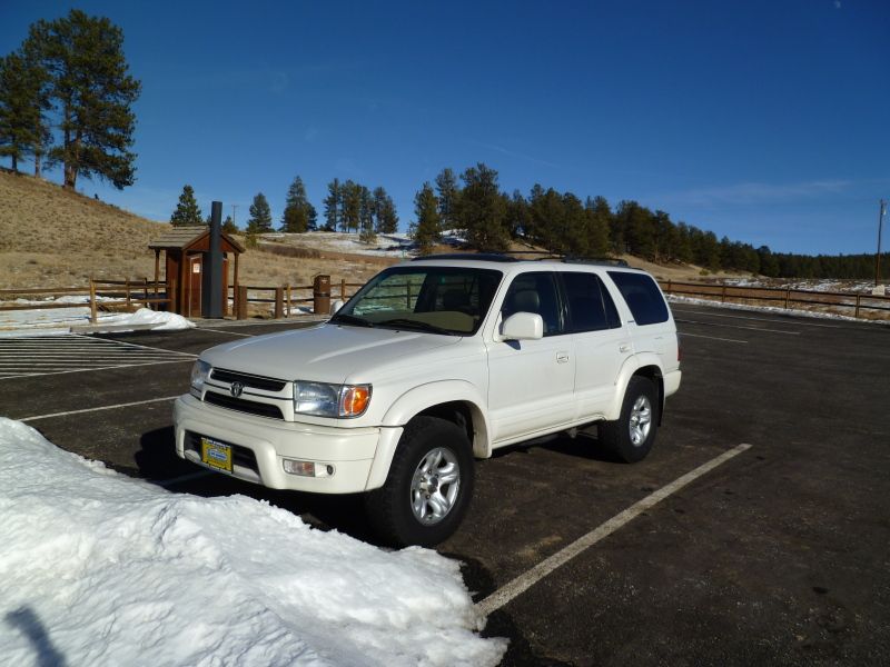

Till I pick the vehicle up on Monday (going though detailing right now). I posted a photo of the same year 4runner and color that I purchased.

I dont think ive ever seen a pure white 4runner quite like that. Every white one Ive seen either had gray bumpers and flares, or black sport flares, or chrome bumpers. That thing looks awesome! i love it
