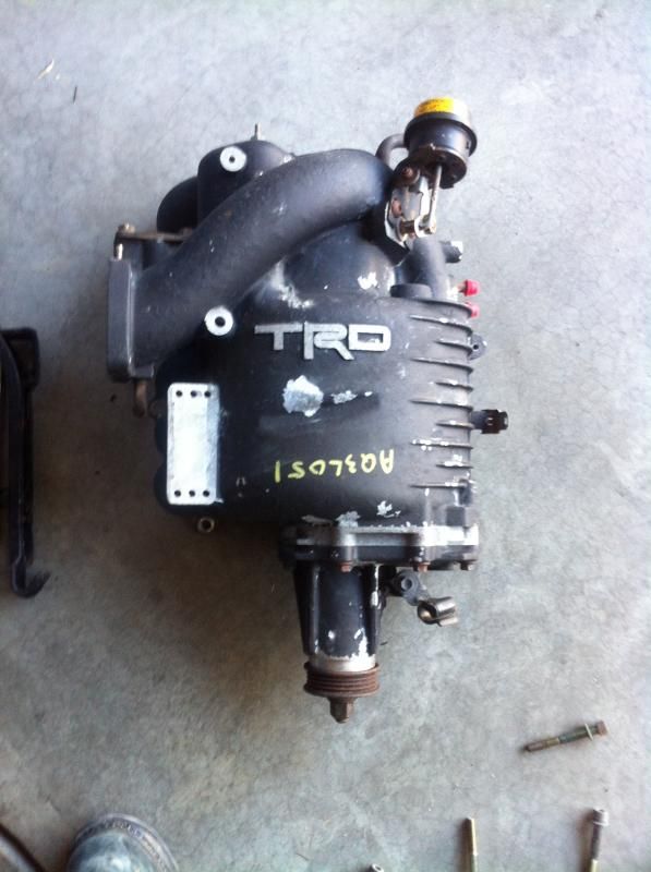

Any recommendations on repainting a supercharger? This thing came from the east coast so the finish on it is pretty well shot.
I've done some search and haven't found much.
Media blast and powder coat or sand/wire wheel/paint stripper then rattle can?

Media blast and powder coat.
Nice! Did you get that one off Car-Part.com? I'd just scuff it up and paint it. Should work fine and it shouldn't come off that easy.

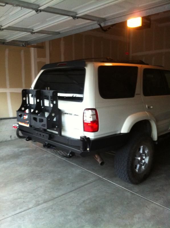

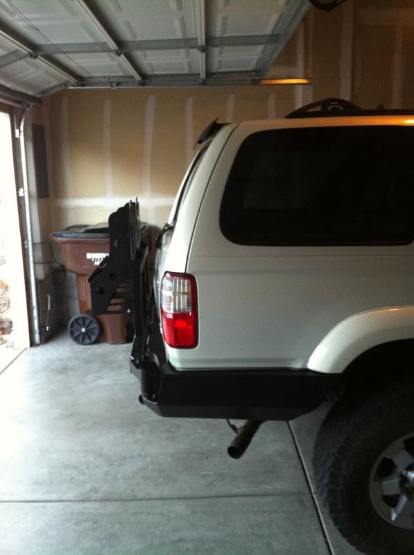

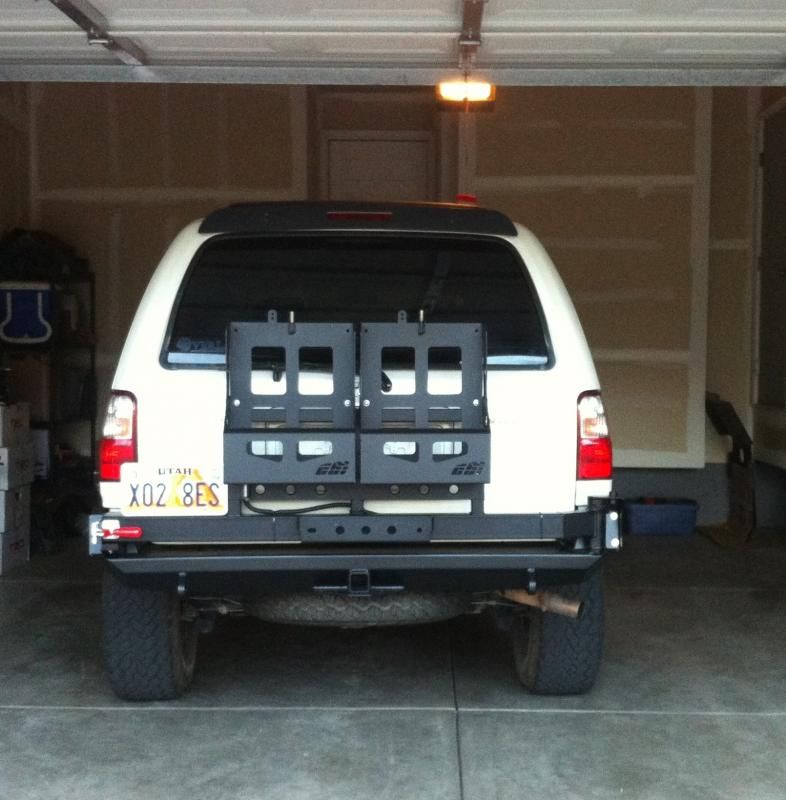

New CBI rear bumper - only issues with was the holes for the license plate light are a little off and the spindle cover the holes didn't quite match up.
The bumper is setup to run two gas and/or water cans on the back the spare tire fits back underneath just barely (265/75/16).

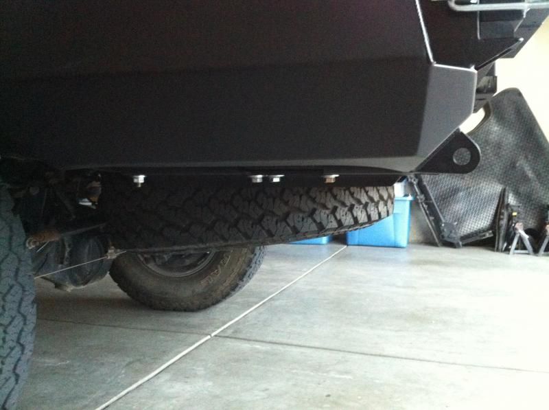

Overall, it was a great trip and my first real run in 2 months. I had one major issue on the trip and that was with the new rear bumper.
The spare tire fits underneath until you flex out the suspension in anyway. All along the trail I heard some awful noises coming from the back as the track bar and the tire kept coming in contact ( removed the tire today and ya it rub pretty badly). The second issue I had with the bumper was the same I had with the last in the rear passenger side contacts the body when the suspension moves so I'll have to install some spacers again for clearance.
Not really sure what to do about the spare tire situation.
1. Don't run a spare.
2. Run a stock spare tire again but even that I'm not sure would clear.
3. Try to modify the track bar for clearance.
4. Modify the (old) swing arm to fit with the new latch setup and waste the new swing I got to carry fuel cans (waste of $$).
The supercharger is going to be put up on craigslist soon. Decided that I dont want to screw with everything needed to get it to work properly (meaning rebuild and 7th iniector, etc).
On the spare tire issue I think I got it fiqured out. In that im going to run a smaller tire. A 265/75/16 is slightly to large
. The 245/70/16 off my work truvk fit with plently of space so im think if I got back to the stockmsize it should give me anninch between the track bar and the tire.

I know your into long hauls, and with that being said I would be cautious running a different sized spare for a long distance.
It will get you by for a short jog up the road but if your 100+ miles from a repair or replacement I would be concerned with drive-train damage.
Ya, I'm aware of that. If needed I got a plug kit as well if needed.
