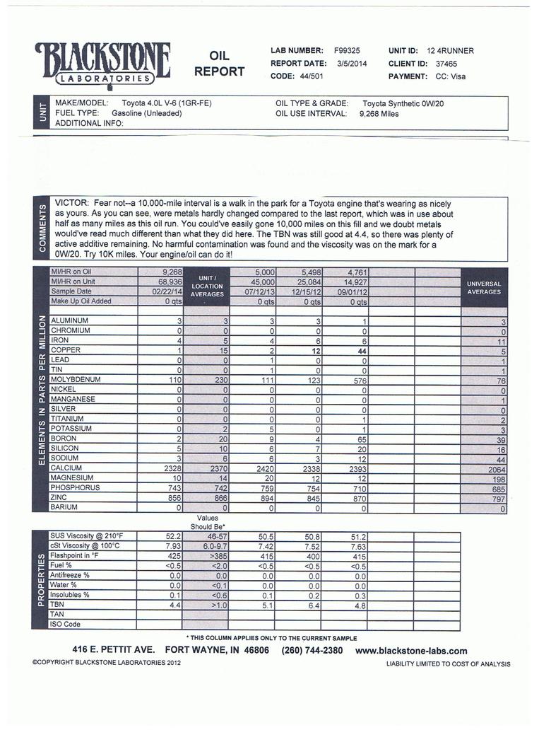

I have changed my oil every 5k miles up until now. Have sent samples in to Blackstone a few times, all good, plenty of additive left.
So I have decided to try one 10k interval and have it tested, I changed at 60k miles and now have 68k and going for 70k miles before changing oil. I will send a sample to Blackstone and see what the report says.
If all is good, this will prove to me that it can be done, if the report comes back marginal then I will continue my 5k intervals.
I chose this time of year (winter in CA) to do this test because there is less dust and the ambient temperatures are not so hot. The 60k miles oil change was in November the 70k should come up in early March.
I use the Toyota brand 0w20 synthetic oil and either Toyota or Purolator filters.
I plan to post the Blackstone 10k oil report when it arrives.
As promised I sent an oil sample to Blackstone after my first almost 10k mile oil change interval. I ended up having to do the oil change a little early due to my work schedule I would not have had another chance to do an oil change until after 10k miles and I did not want to go over.
Change was done at 68,936 miles on vehicle, 9,268 miles on the oil.

Looks like the motor is breaking in nicely. Your TBN is much higher than mine was at 8K (1.8 vs. 4.4) but most of my driving is short trips where the truck barely warms up with 1k mile road trips every month or so.
It looks like the miles are pretty easy on your truck. Didn't you say you had 70k on the OEM tires?
thanks vickpik58 for this oil analysis the past ones too. We can clearly see the engine break-in for the first 3 analysis', and we also clearly see that 10K miles is far into safe ranges!

Yes I still have the original Bridgestone tires on, but they are to the point that I would not want to get into the snow with them, but they have done fine in the recent rain. Not down to the wear bars yet.
I drive mostly highway miles with some in town and a fair amount of stop and go bay area traffic.
Very rare not to get the engine completely warmed up.
I am kind of surprised by the report, and thought it would be closer to the end of the oil's life.
I will probably still do 5k in the dusty hot summer months, but think I am going to extend to 10k the rest of the time.
