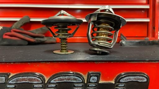

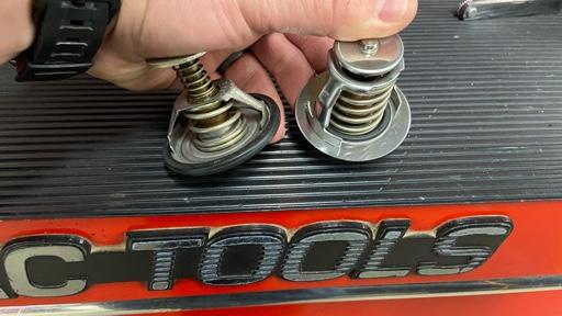

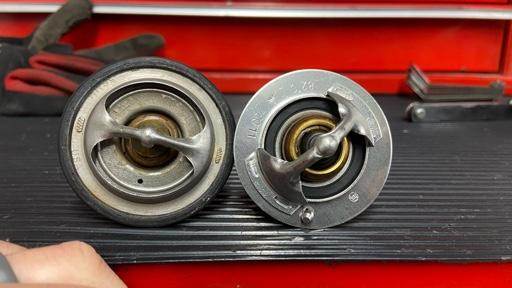

Timing of this thread is great, I just actually happen to have mine apart. Aftermarket USA manufacture, probably stant thermostat on the left. I drilled a hole into it when I installed it earlier this year with the radiator. Helps to prevent air locking when a jiggle pin is not present. Trick my old diesel school instructor showed me.
Toyota new OEM on the right. One thing to note that the aftermarket does have a larger passage than the Toyota. The sensing bulb and spring for the Toyota is much larger. I placed my homemade vent on the aftermarket thermostat at 6 o’clock for what it’s worth.
If I had to take a guess on the why 6 o’clock from looking at it right now, my guess is that it has something to do with the location of the oil cooler and the fact that the block passage is nearly open entirely above the thermostat. There must be some type of air pocket that gets created. You would think being on the suction side it wouldn’t matter that much.
There isn’t anything else on this thermostat visually to me that would indicate that it would even matter. So I guess the mystery continues.
