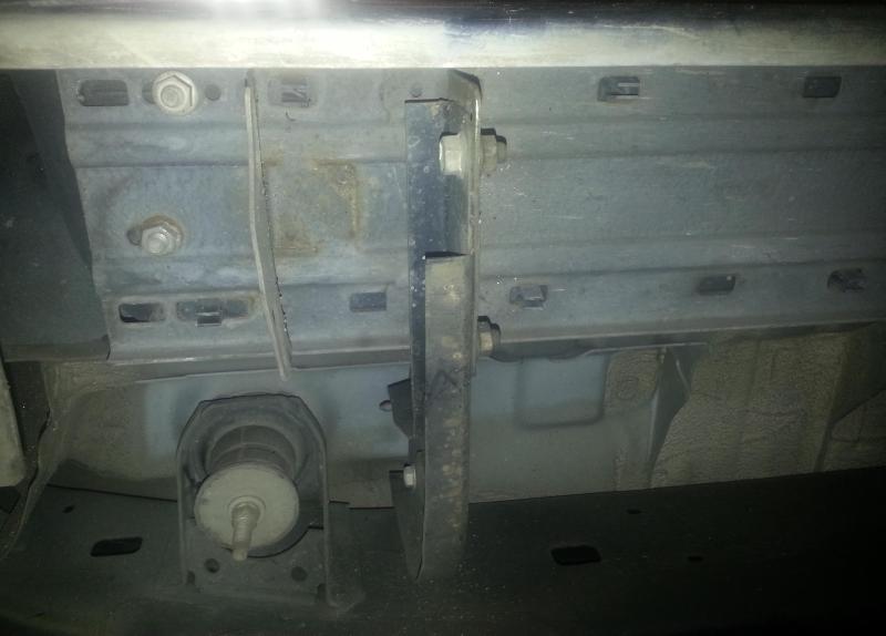

I'm not sure what to call the spot I used, but it is the lowest spot in front of the rear wheel on the frame, which has a round "thing" which I assume is a swing arm bushing but I don't even know what a swing arm is so I could be calling it the wrong thing.
Here is a picture of where I had placed the jack stands:

I only now, belatedly, realize that the point I used, which I don't know the name to call it, is the WRONG point to use for jack stands.
Here is the point that I used.

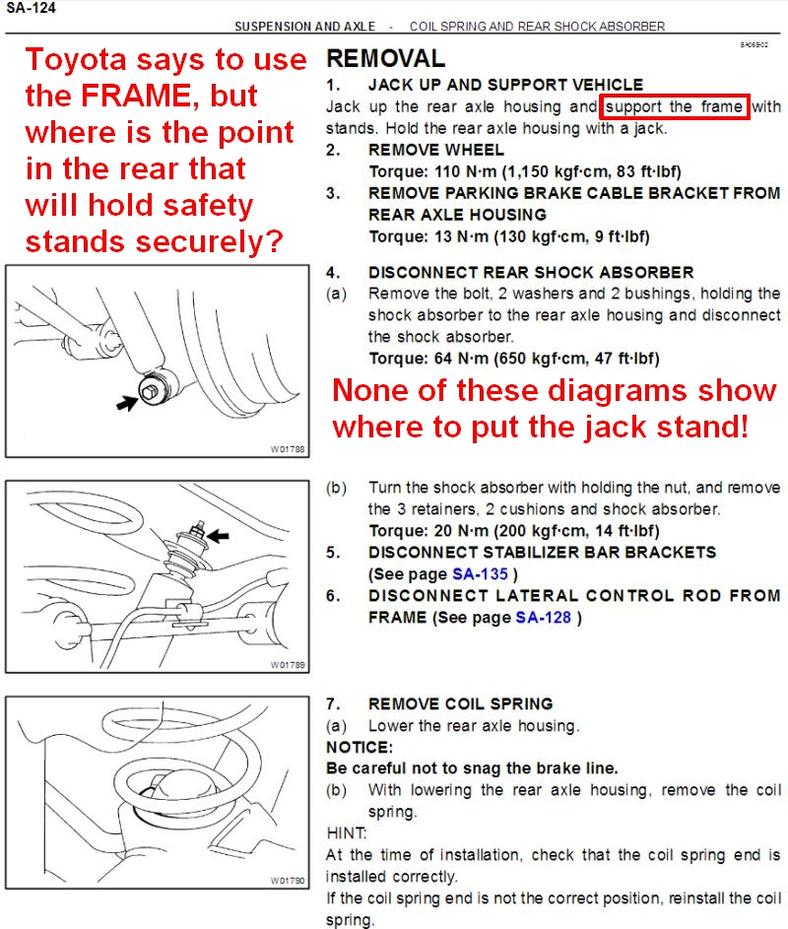

Well, if you are doing a job that requires the diff to droop, Toyota WANTS you to put safety stands on the frame. See Item 1 on how to change the rear springs from the '02 FSM
Thanks for that PDF (reproduced below).
I see the words "support the frame" and I understand your point which is that some jobs require jackstand support on the rear FRAME.
But I can't find a good point that is a FRAME in the rear that jackstands will hold on to.
Everything looks flimsy (see photos above) except that one spot I found that has a bushing in it.
The only point I can find (I wish I knew what to call it) is the one where the yellow arrow in my photo points to?

I'm sorry but I don't know the terminology but looking underneath the 2WD 4Runner, this is the ONLY point that I see that seems reasonable to put a jackstand under.

After reading all the 3rd-generation threads I could find on the subject, I didn't find this question answered; hence I asked it.
The answer, even at this very moment, seems to be still unclear from Toyota's standpoint, in that:
  1. Fact is, the Toyota diagrams do NOT recommend jack stands in the rear anywhere other than on the axle itself;
  2. Yet, TheDurk clearly found a Toyota reference with the words to use "the frame" (but zero advice as to where exactly to place them on that frame);
  3. However, the frame is, IMHO, far too close to the gas tank for perpendicular-seated jack stands to fit without risking damage to the fuel tank and/or shield (IMHO).

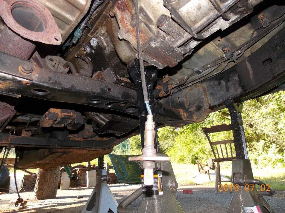

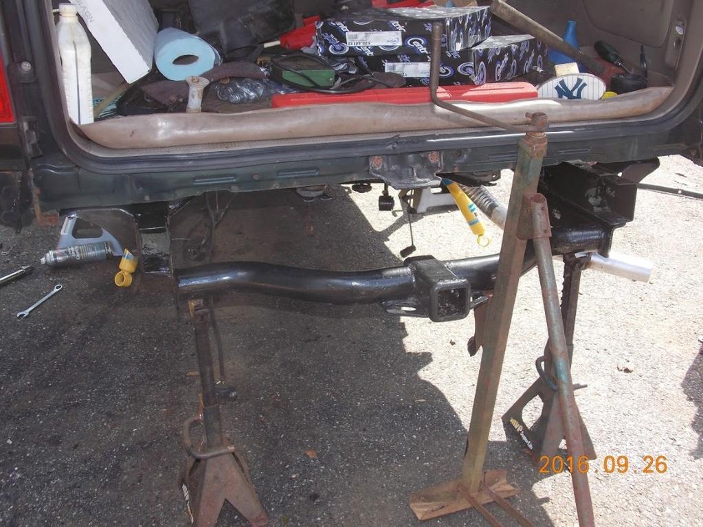

If others use the typical 6-ton jack stands that I use when working on the rear suspension, then it would be instructive to see a photo of how others safely orient the head of the jack stand on that frame, due to the innate proximity of the fuel tank.
For 17 years, I've been placing my 6-Ton stands right in the spot against the fuel tank forward of the control arm point and never knew it wasn't possible. Yes, iI put that one parallel. I just did my frame swap supporting it there and I was underneath it for days connecting and disconnecting. I also had a backup in place using my 1961 Olds station wagon bumper jack plus two more stands on the tow hitch. It alone can lift the whole rear end that way. And I like having a few thick logs in strategic places that will keep me from getting crushed even if they fall over.
Having one turned parallel with a total of seven stands and an engine crane did not bother me at all.
Like you, until I searched for Toyota's recommendations, I didn't realize that the jackstand point I had chosen, was not the Toyota-recommended location for rear jack stands.
Yes, iI put that one parallel....Having one turned parallel with a total of seven stands and an engine crane did not bother me at all.
That pretty much answers the question of what people do.
We still have unanswered the question as to what Toyota recommends (specifically, with a diagram or photo anyway).
The fact that it's problematic to put a typical jack stand in the proper orientation under the rear frame is likely why Toyota doesn't seem to recommend ANY spot on the frame in their diagrams.

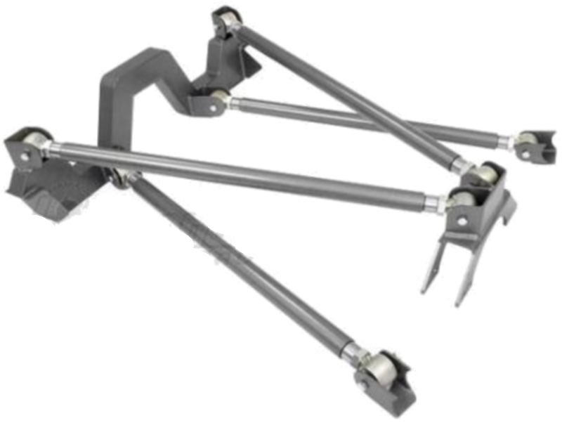

I confess I don't even know what a lower link does (is there an upper link, for example?).
Just by the looks of it, intuitively anyway, it seems to be a 'sway bar' of sorts, only it's in the front-to-back direction instead of a side-to-side direction.
Googling, it's a "suspension link", so it must work in conjunction with the springs in the rear, as a suspension component where, according to this reference "the rear lower control arm' (LCA) links the rear axle to the frame to keep [the rear axle] in place".
It's not my vehicle, but the whole reason for asking the question is for my safety, and for the safety of others who have the same question (which was NOT fleshed out in the aforementioned threads, AFAICT).
1- Search "4 link suspension" on YouTube, or Google "How does 4 link suspension work", and watch some videos to better understand how it works. It would probably be very helpful in understanding that Toyota's recommendation- to not place stands there- is VERY valid.
2- If this is not even your vehicle, what are you doing to this vehicle that you need to support it on jack stands- on a location other than the Toyota-recommended location under the axle? Unless you are working on suspension components, supporting under the axle should be sufficient. Please don't take this as rude or snarky- I think that everyone should be able to ask a question here without being flamed- but since you don't seem to be familiar with the suspension at all, I am assuming you aren't working on the suspension.
Frankly, I'm mystified that this thread even exists. Put the jackstands on the frame rails (or under the axle if that suits whatever purpose you have) and be done with it. The OP is making waay too much of the factory "recommendation".
I'm familiar with leaf-spring suspensions, but not these Toyota 4-link suspensions.
Googling for "how does the 3rd-generation toyota 4runner 4-link suspension work", I find this article which states that Toyota switched the 4Runner from leaf spring to 4-link in 1990 (with Panhard bar).

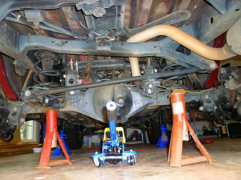

I agree with you.
The only reason I asked the question is that I have been using the lower control arm connection to the frame for my 6-ton jack stands, but I was uneasy with that location (as I prefer a nice solid frame).
However, I was just as uneasy with using the frame because it is just too close to the fuel tank for the jack stands to be placed in the conventional crosswise position.
It didn't even occur to me to use the axle; but that's what I will use moving forward.
