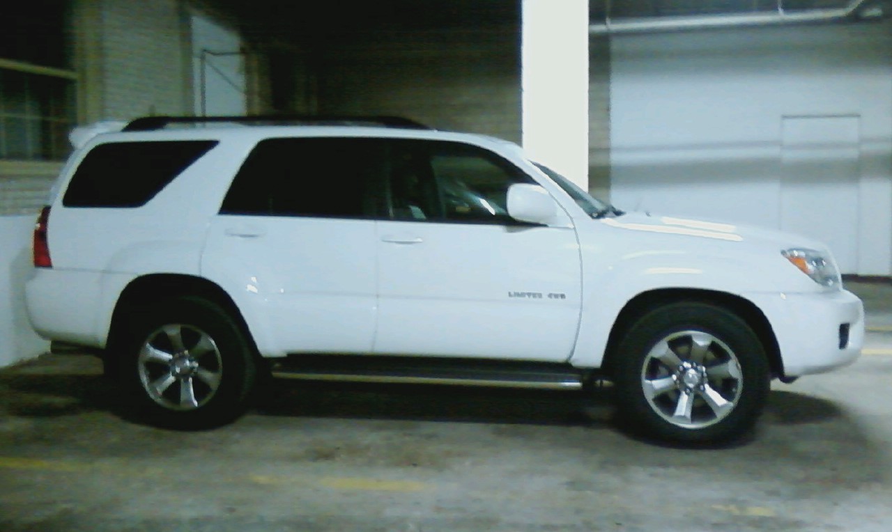

I have a set of factory 06 Limited wheels with Michelin xterrain tires for sale ($850) If you're interested, let me know.

06 Limited Wheels
Hi,
Yes they are 18" and have TPMS sensors in them. I bought Chrome rims so i was thinking about keeping these for the winter but if I get a decent offer I'll sell them.
