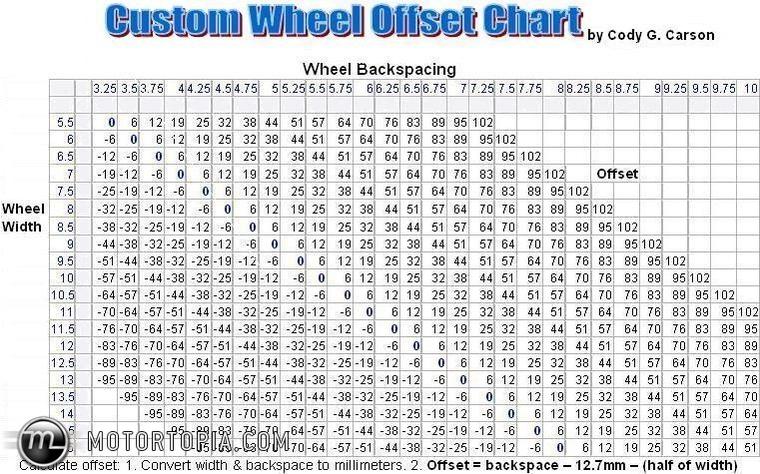

Yep, That looks like a good fitting wheel and tire combo. :boink:
You may have minor rubbing on the front inner fender liner because your going up to a 9 inch wide rim. I doubt it though as your tire diameter size is about exactly the same diameter as stock.Easy fix if you did.
The offset changes in relation to the width of the rim so maybe that's why the offset recommended you read is different .
Here's a chart to help you understand offset better.
You will just barely touch the body mount at rear of front well...but only at full lock in reverse. Also only on driver side. Will be close but not enough not to use those. How much will depend on that MT tire. The -12 offset is the contributing factor but really is the best offset for that 9 inch rim. Will give your truck the look you want.
