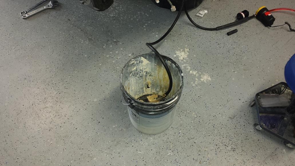

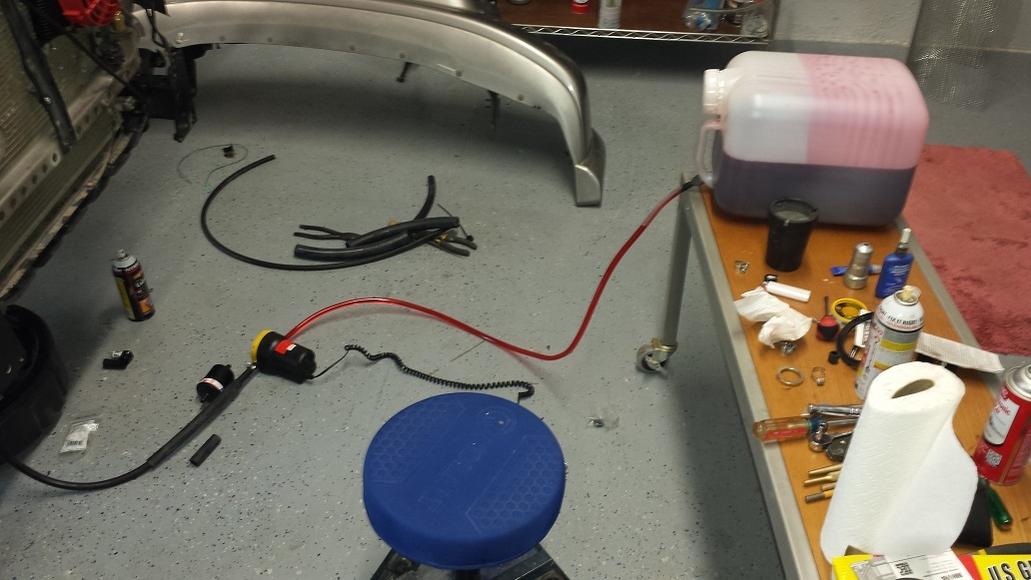

That sucks. I am sorry to hear that the trans flush did not go as planned. I am really close to doing the same thing. Is there anything else that causes pink milkshake besides the transmission fluid mixing with the radiator fluid? Maybe to be on the safe side, replace the radiator. Keep us posted, and I hope your transmission is safe.
I have been thinking about the same thing since yesterday. The fluid was strange. It flowed dirty reddish brown at first and then the milkshake appeared. I am wondering now if I introduced to much air from the new lines, and the fact that I drained off quote a bit in the cooler install.
As well I would think that any number of things internally wrong with the trans could cause a similar reveal to the milkshake.
All I can do at this point is drive it a little and see. I did not want to drop the pan, but I will in a few weeks and inspect everything and then re-flush the system. Its a 100 bucks of fluid, but the diagnostics of viewing the fluid could answer a lot of questions. When I do it this time I will make sure the system is hot, the cooling lines full, and the beer cold, just in case.
There is no telling at this point if it is terminal or not. I will look for a re-buildable trans in the wrecking yards and start that as soon as I can, regardless of the outcome.

Checked everything out today again and I think I did not have water in the trans. The radiator is good and the new fluid is fine. The old fluid revealed no water in it.
I think what happened is the air in the lines under pressure foamed up, and caused the fluid coming out to have a milkshake look.
This makes me wonder if the milkshake can have other causes besides water from the radiator. I won't know if my tranny is bad until I get it finished, but I think it is fine.

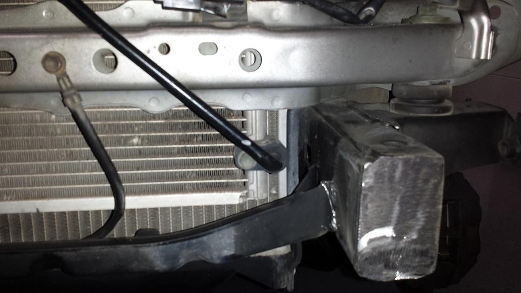

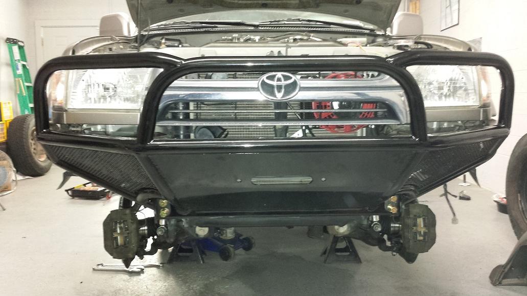

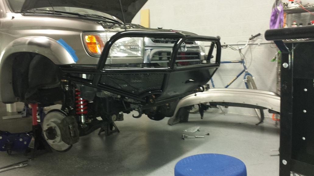

I received the bumper and got it off to the powder coater. I wish I had of thought that through and waited until I had the mounted all sorted out first. Now with the powder coated bumper I have to be really careful not to damage it while getting it mounted...I don't no what I was thinking, or perhaps I was not thinking at all in my excitement...likely the latter.

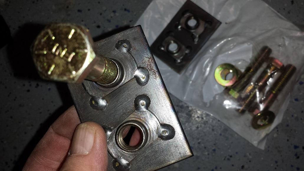

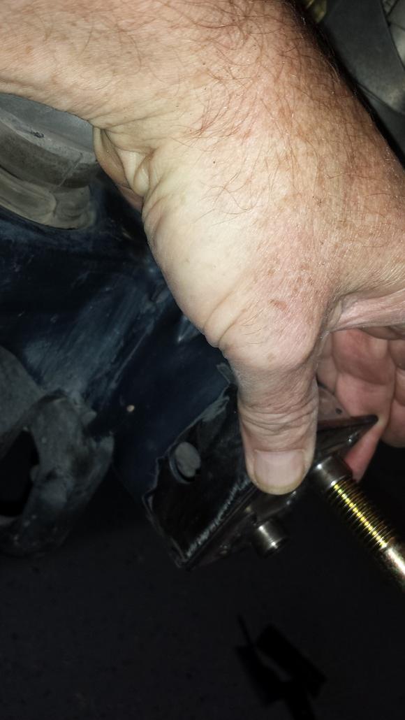

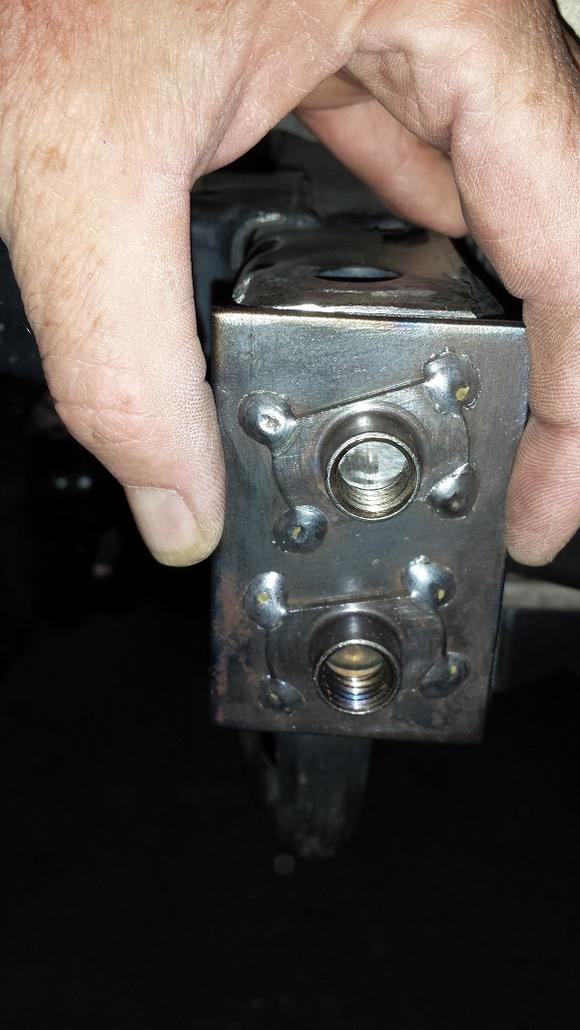

The bumper comes with a little kit for mounting. It requires a little cutting and then a little welding to mount the bolt on plates to the front of the frame. I prefer this over welding on the bumper in case the engine and trans need pulling or you have to do any in which the bumper would either be in the way or have to been leaned over...a half out of that and the torch would be out.
During the grinding I hit the air conditioner line...I did not cut through it, but it will have to be replaced as it will fail in the future. Arghhhh.
I posted pics of the bumper temporarily mounted...

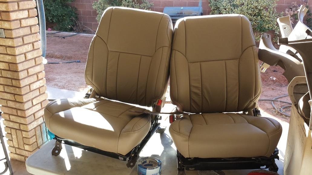

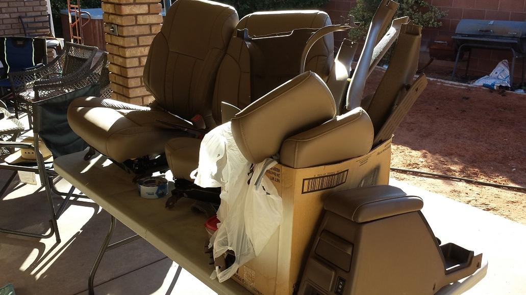

The seats are reupholstered and just need reassembly and re-installation. the interior is cleaned and prepped as well and waiting installation. I need to clean the interior a final time to rinse out the detergent smell which has replaced the nasty smoking as the new nasty...A good wash and rinse with a mild detergent will handle that...

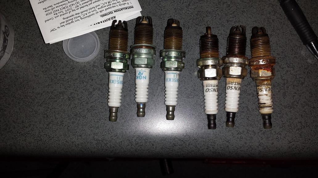

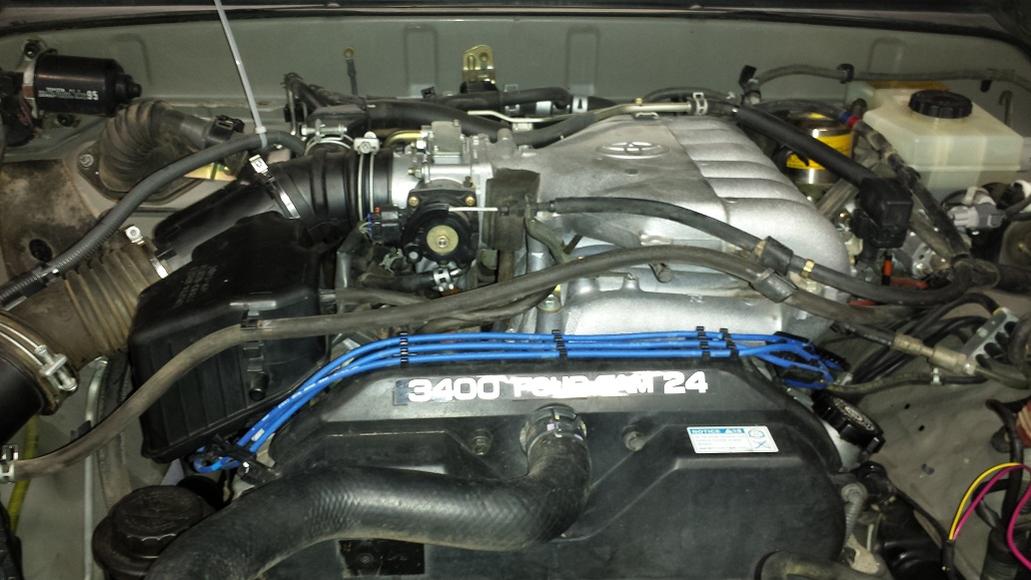

Finished the engine and trans work today

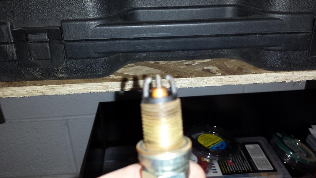

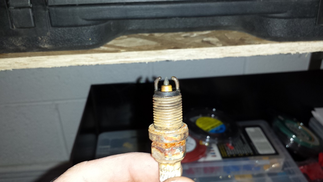

The last thing I had to complete was a plug and wire change. When I changed the spark plugs I was stunned to find that the left side plugs were different then the right.
Apparently the last tune up was not completed for whatever reason, I can not fathom.
Notice that the plugs are two different types, also notice the three from the left side are much older and wore out than the right side.
The work on this toy was done by TuneX, and I paid for it. I new my stepson would not care properly for the toy, so I paid to have it maintained. Needless to say I am pissed and going to visit Tunex tomorrow.
The good news is their does not seem to be any serious damage and after the tune up the toy runs great.

Also, the 5VZ-FE's all came with NGK spark plugs in one cylinder head, and Denso spark plugs in the other.There has been a lot of speculation as to why Toyota did this.
At any rate you can run all NGK, or all Denso, or all whatever your choice of spark plug is, if you want.

2. Now I am even more pissed because I am thinking the plugs were never changed....argh...
Thanks for the info, I won't shoot the messenger...:)

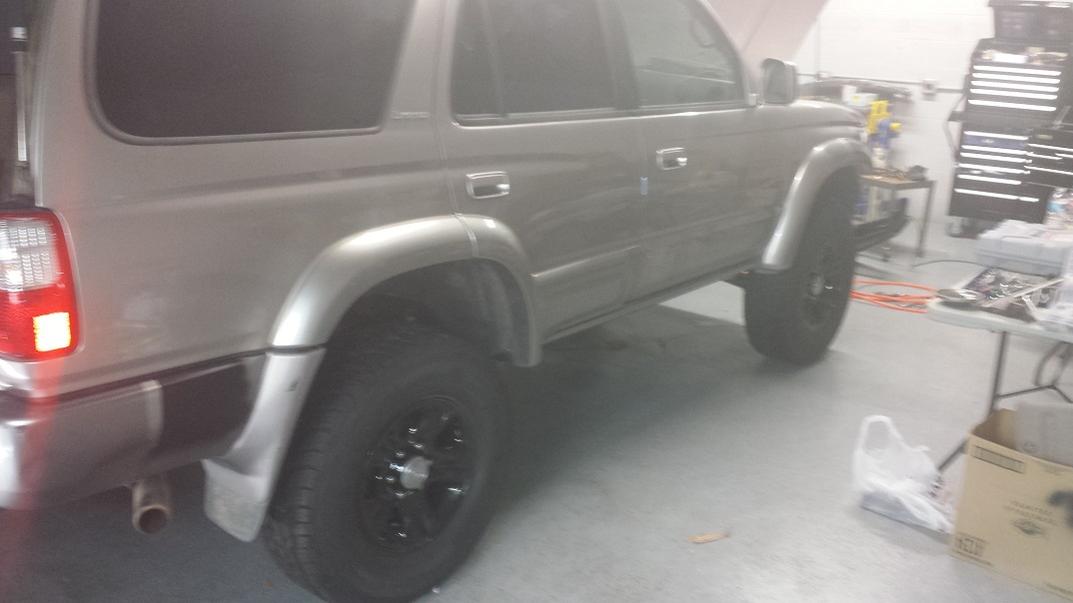

The toy is mechanically aligned and being aligned today.

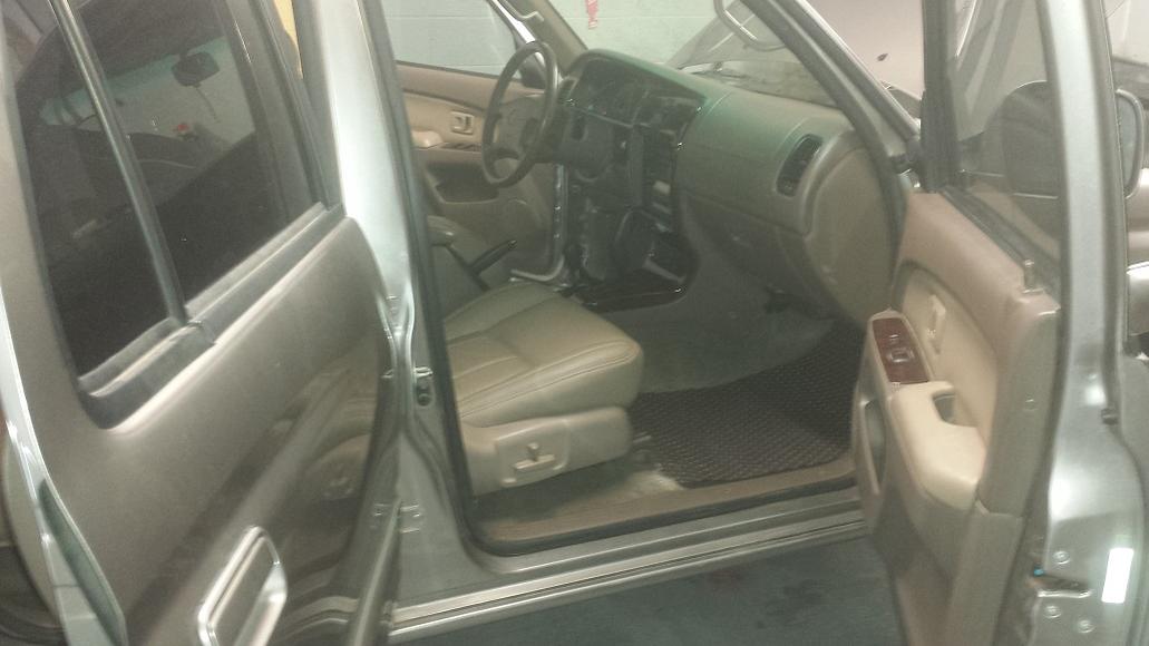

The interior is completely cleaned and the seats are done.
Should be on the road in a week or two.
Wishing everyone a safe new years eve, and a successful, profitable, and joyous new years.
Its all its all starting to come back together

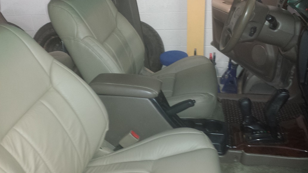

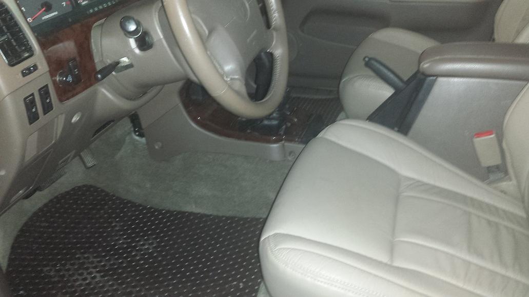

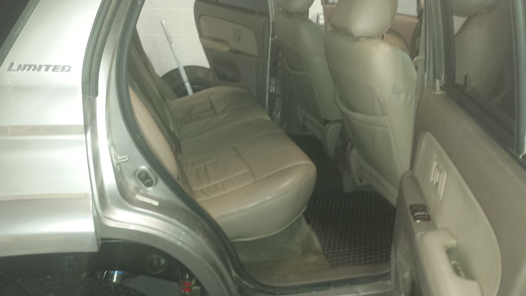

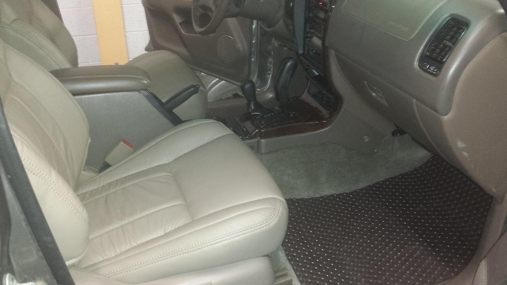

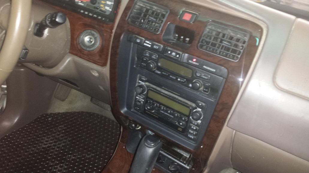

Today I reinstalled the interior. I think it look pretty good. Proper cleaning, and new seat upholstery makes a big different. I kept the original carpet since this will be a ski and desert rig and any carpet I get will get dirty and stained pretty fast. The carpet was thoroughly cleaned and sanitized and smells good, but it clearly is stained. I hid the stains will new floor mats.
The vehicle is aligned and it is running great so far. Still need to get the front bumper mounting brackets welded on and I am waiting for my roof rack, sliders, and rear bumper from savage.

Hey Will - a lot of this work looks familiar. I like seeing a neglected truck get some attention. These trucks will last a really long time with proper care. Chuckles truck is nothing like it was when we got it.
Seats look awesome. Where did you get them again? I don't feel like searching.

I have to go back and find the receipt, so I can give you his direct number, I found them on EBAY, and the shop is a custom rod upholstery shop in Salt lake.
When I go to shop next I will get his name and number.

The seat covers came from perfect stitch, South Jordan, Utah. His number is 801-280-8387
I think he will give you a deal, if you mention this Forum and the fact that your guys have build thread that are wildly popular. They were pricey, but not anymore than I would expect to pay for leather seat covers anywhere except Mexico...Mexico is out for me, as my time is worth more then I am willing to trade to get through the border crossings.
