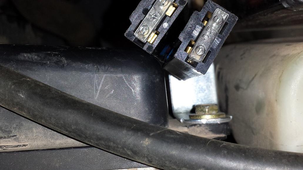

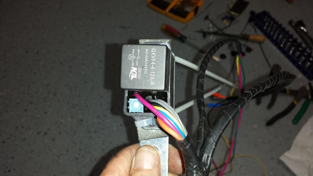

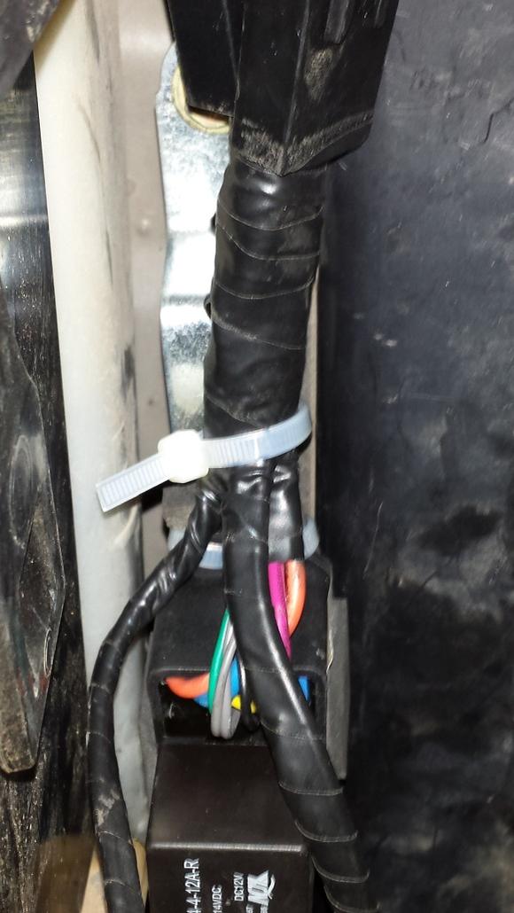

I finished the install of the fan controller and discovered I have the fan turned the wrong way. I will have to change it tomorrow, but its not a problem.

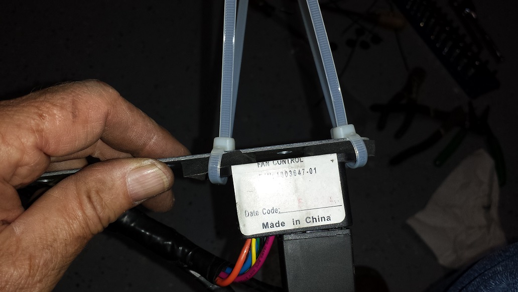

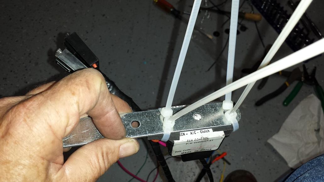

Everything I heard about the controller has been positive, except that the pot seems to get knocked apart when fastened directly to the vehicle without some way to isolate from vibrations and jarring the vehicle under goes.
I fab'ed a little bracket and attached the pot to it with 4 tie wraps, with EDPM foam in between it and the bracket. I attached the bracket by using a radiator shroud bolt, which I think will hold it just fine and the flexibility of the mount, and foam, will absorb any vibration.
The install makes it easy to get to the fuses as the photos indicate. The photos are deceptive as it appears the pot is touching on the sides, but they actually do not, but just in case it migrates left or right, I placed foam on the sides as well.
Again, time will tell, but I think the solution will last for years.

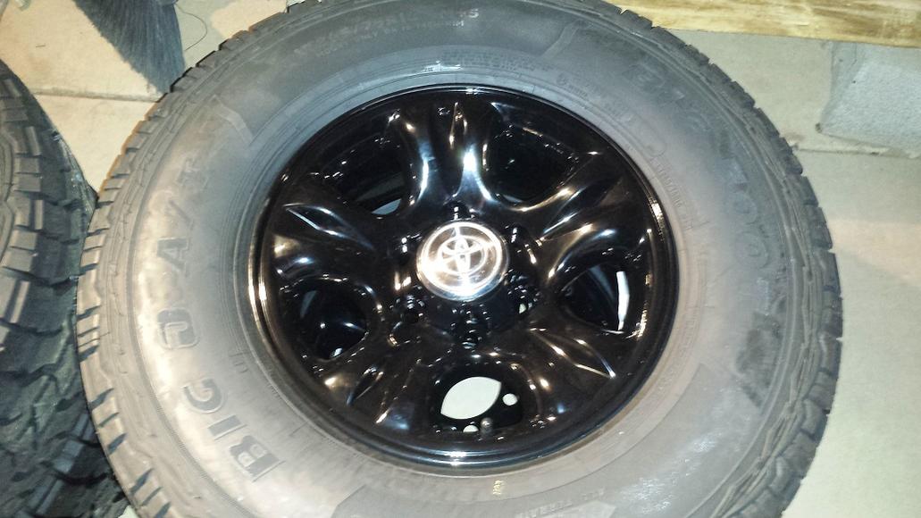

I just spent three hours prepping two wheels for painting. They both had bead glue on them. Neither rim needed it. What a mess, but using elbow grease, goo b gone, acetone and sand paper, I got it done. Arghhhhh
Day 25 worked on the rims some more. Cleaning the tire glue off and sanding them is a chore.

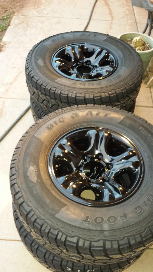

Got the rims finished, and the tires mounted today. Lots of little detail items to do, but I am getting close.

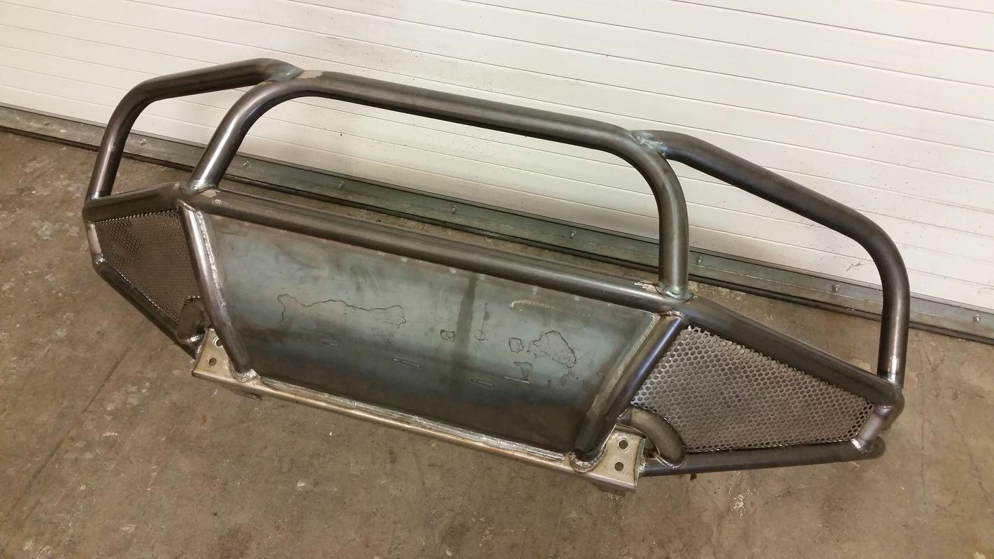

Waiting for the bumper to be delivered is like watching the chimney at Christmas when I was a kid...
The project is getting close, but all the piddly stuff is driving me nuts. Having the bumper on will definitely give me a sense that were are close...

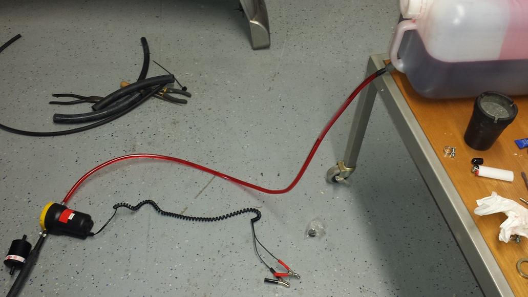

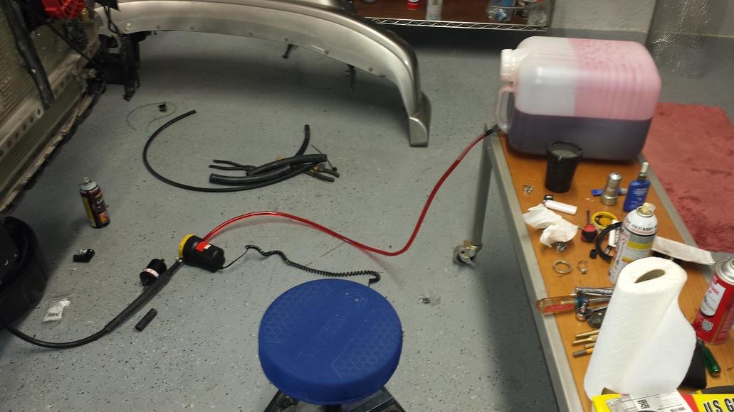

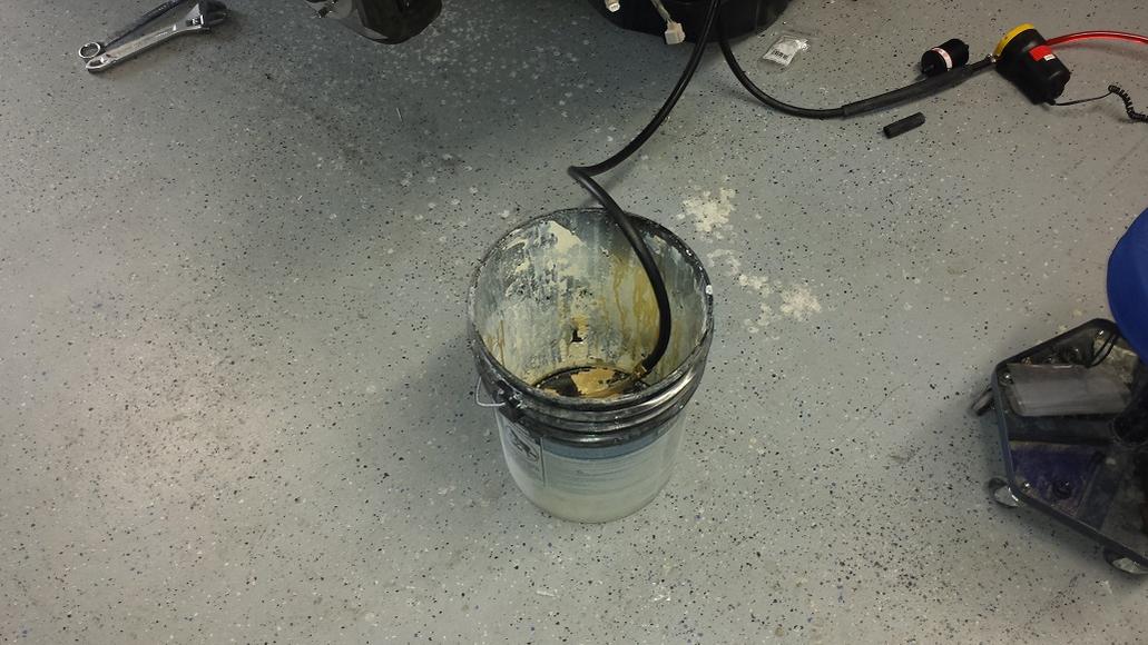

I did a flush of the transmission today
I Flushed the tranny today using a pump and the tranny itself to change out the fluid. It started out ok but halfway through turned in a pink milk shake, and turned to the new clear mobile one. The old fluid was horrid looking, almost burnt in appearance.
One thing I did was not let the trans get warm enough, but I did not realize it until I was done and carried the fluid to my oil barrel. It was not near 100 degrees...I really needed to let it warm up more.
The radiator fluid is low, but it does not appear to be leaking water in the trans cooler. All I can do at this point is hope that the trans is not toast. I will re-flush it in five hundred miles or so. I was in a little bit of a panic, and moved right into checking the radiator and securing the lines, and I failed to get any milkshake pictures.
