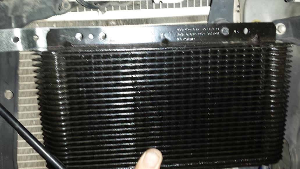

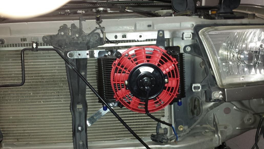

Spent the day fabbing brackets and figuring out just where and how I was going to mount my trans cooler and fan. I bought 14000 BTU, so it is thicker than most. Sorted it all out using tie wraps to temporarily mount it and then make sure I had the clearance I needed. Tomorrow I will mount it in and take photos.

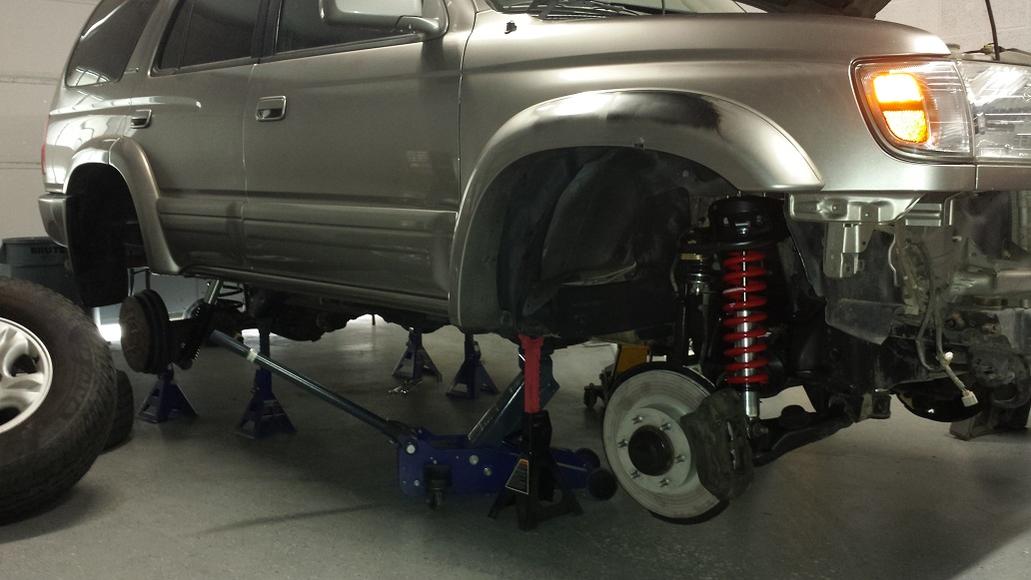

Today I went back through and checked everything and made sure all was correct and tight. I still need to do the ABS sensor and extended break lines.

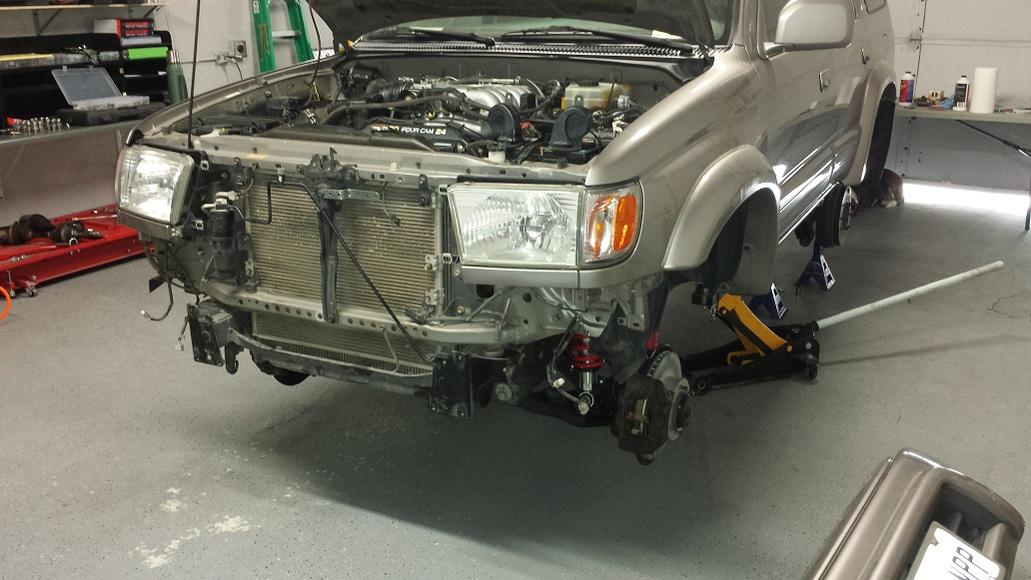

I placed the toy on stands and pulled the tires and wheels so I can swap the tires to some steel rims and then refinish the aluminum rims, which I will do at home on the back porch.
I then pulled the front Bumper to get ready for my Whitson Metalworks bumper, which is being finished up by Josh. It also gives me better access to the cooling system for mounting and connecting up the trans cooler. Worked on fabbing some mounting brackets for that project and deciding where, and exactly how, I will mount it. It is important that it be mounted with rubber bushings, or on the rubber bushing mounted Ac cooler, lest it rattle, and in the process rattle itself apart. I may try to find some better bushing material than what was included

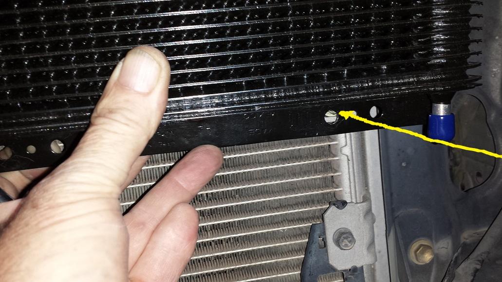

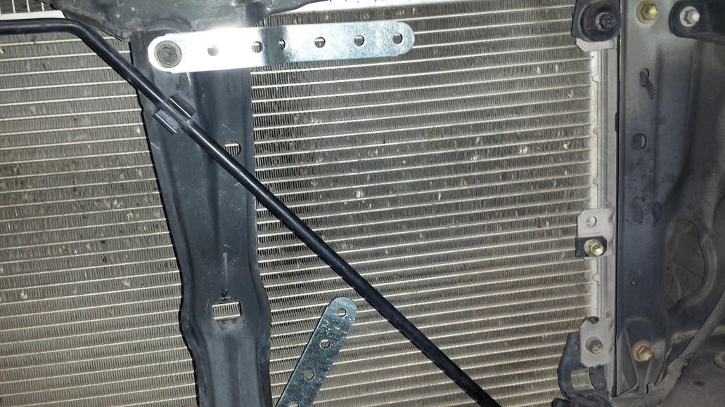

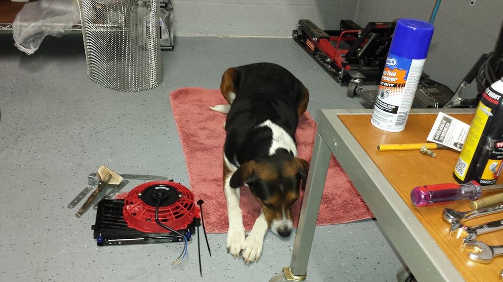

I realized that I can slightly enlarge the existing mounting holes and mount half of the trans, to the AC cooler, and half to the frame. I posted several pics, including one that shows, how oh so close, the bottom left side hole is...it and the upper hole will be enlarge, I will split the difference, and then mount on the ac cooler mounts with stove washers to makes they do not pule through. (at least that is what I am thinking after cogitating on for a while to day).
I also posted a pic of the supervisor. She has a place to lay down on all sides of the project and she follows me from one location to the other to watch...she cannot stand not being with me, or not seeing what I am doing. Occasionally she will poke her head under the toy to see what I am doing and then go and lay(or is it Lie,) back down. She wants me to finish so we can go wheeling to her favorite desert running spots...

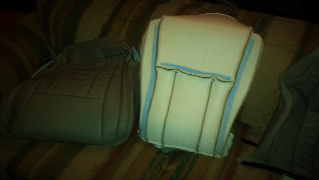

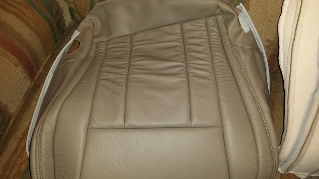

I received my seat covers tonight, and I am very pleased with the workmanship. In fact I think they are better made than the originals. I will update this with fitment when I get to the seats...

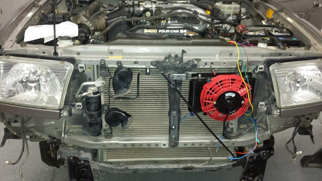

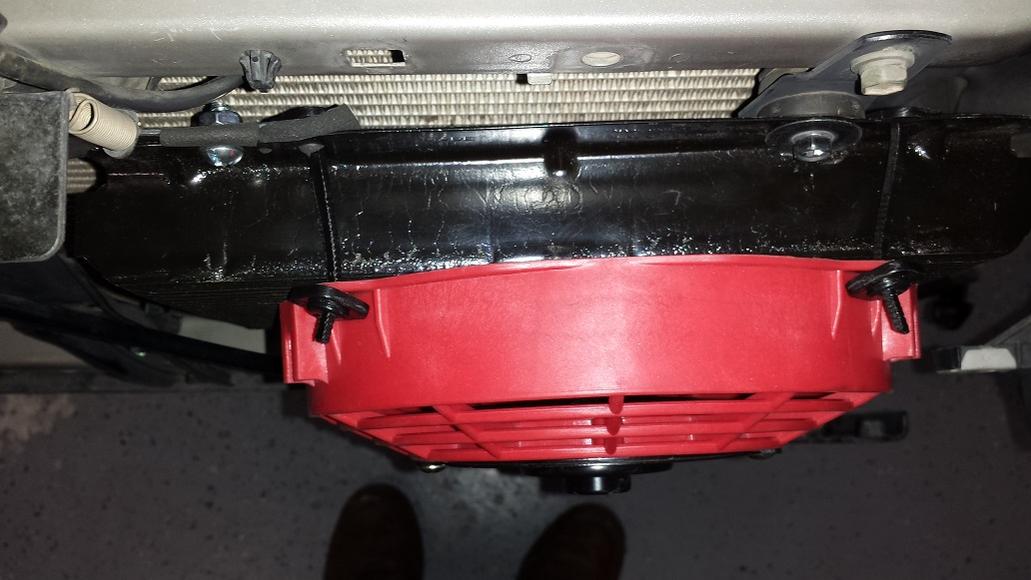

Sorted out the mounting of the cooler, fan, thermostat, and the horns.
The thermostat probe will not mount through the cooler, so I am epoxying it in place with a couple of dabs. I believe from my experience it will work fine, although I am usually using more robust sending unit. We shall see.
I made sure to isolate the system using either stock rubber mounts or edpm foam. The fans was mounted using the through radiator cooler mounting and I expect the will hold up fine consider the fan of the fan is about 1/4 of the fan...time will tell.
