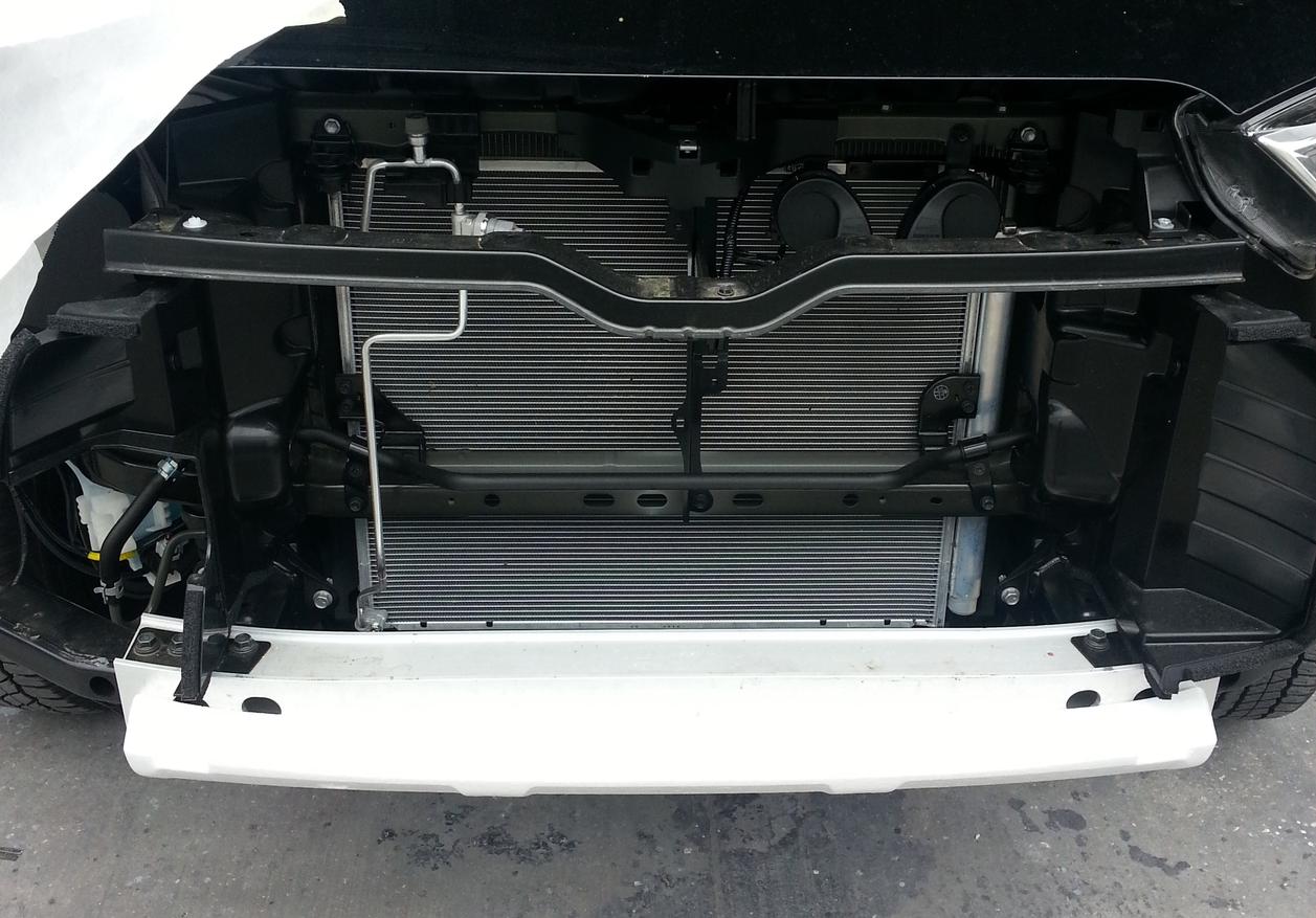

Here is essentially what is behind the bumper cover, in case you were wondering....

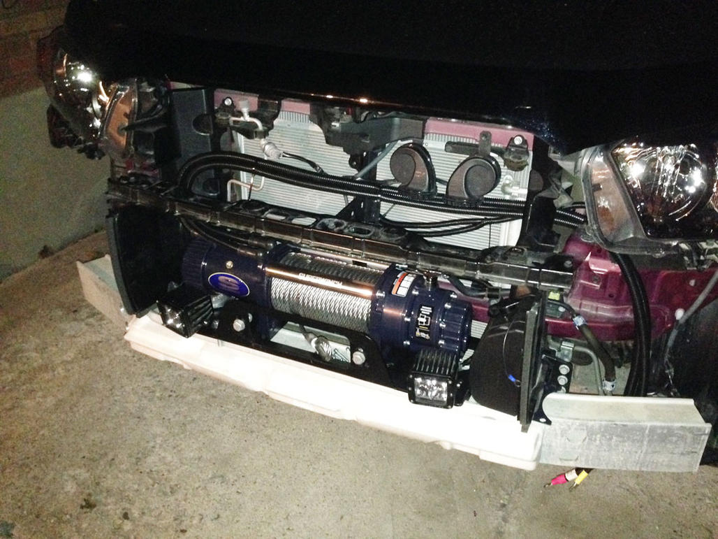

I have a full size superwinch talon 12.5, I had to relocate the solenoid for a clean fit. It would fit but you would have to tweak the light gauge cross member behind the upper grill.
