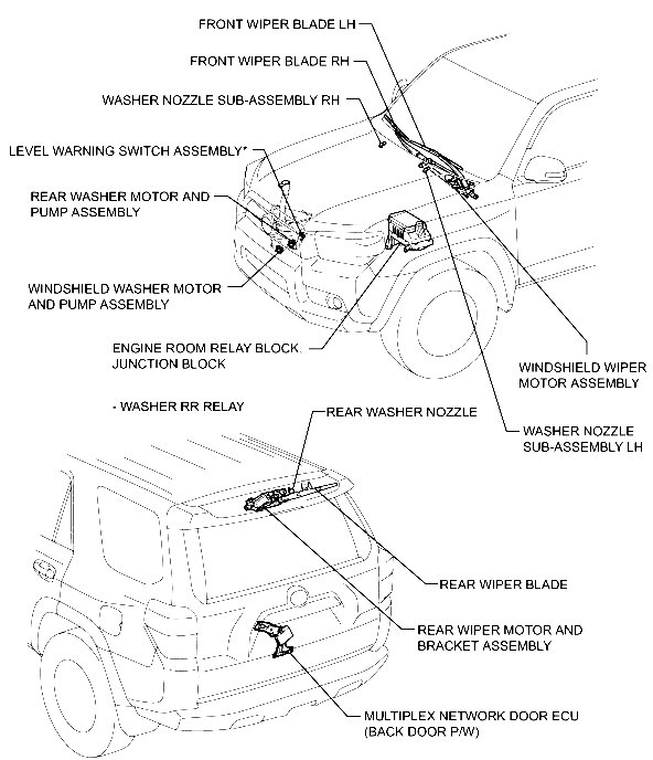

As it was explained to me: the two pumps sit side-by-side, and they simply swapped the tubes to determine it was the pump and not tubing/spray head, etc.

I don't even know where the pumps are located, but maybe you could swap the tubes and see if the failure moves to the rear?

Thanks nashman!
