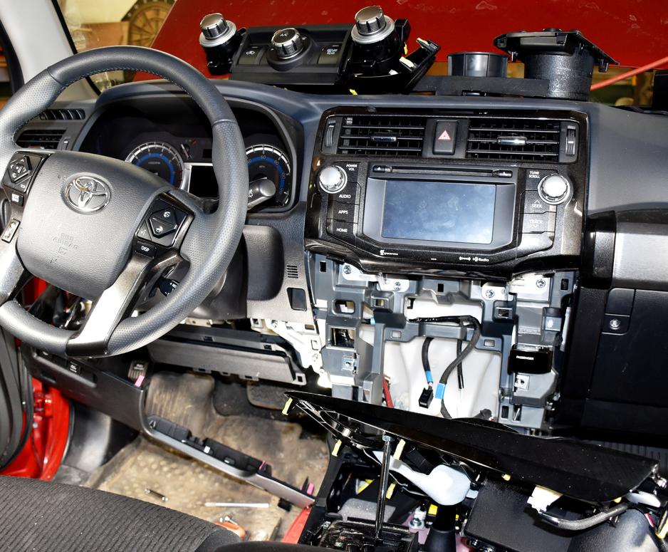

I’m installing aftermarket dash switches to send trigger power to lighting relays. The brand of switches I’m using is irrelevant. I want one of the two LEDS in the switch to light up when the headlights are on and dim with the other dash lights. I know which terminals on the switch will accomplish this. I’m also aware that the ground side of the circuit is what dims the light. I’m looking for someone who has actually spliced into these wires and has firsthand experience with success in doing so.

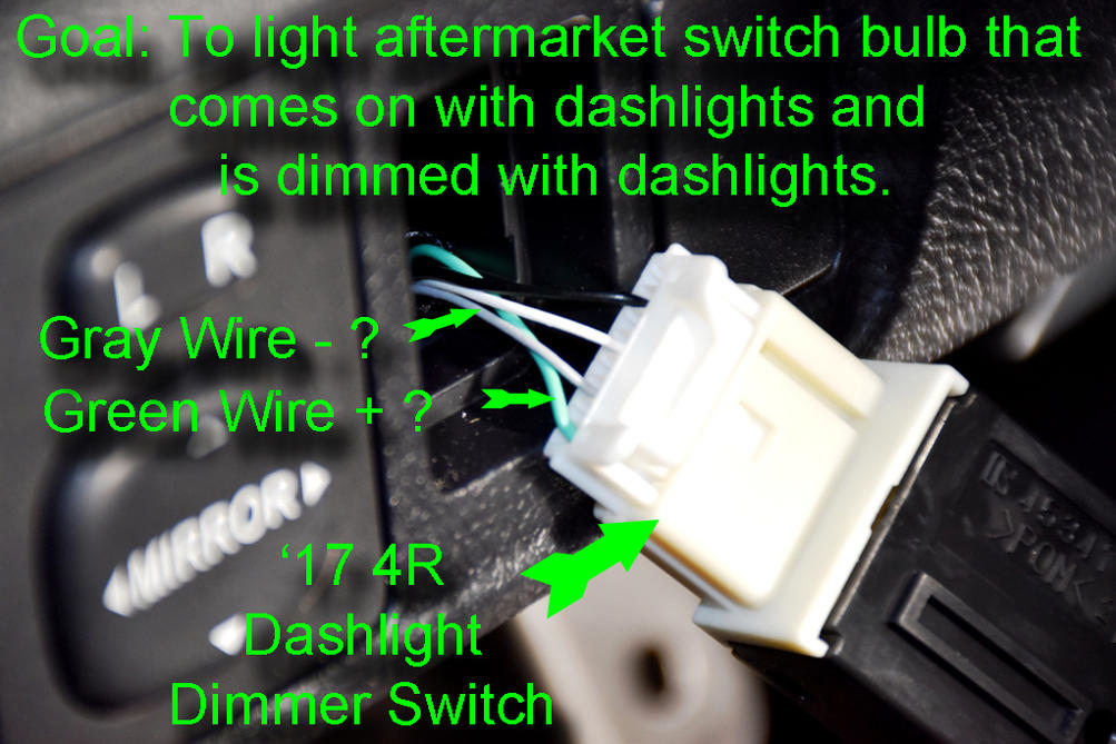

My Question; In the picture below, are these the wires and correct polarity to provide power to the “dash” lights in our new switches?
I’ve done due diligence and read through a few threads that touched on my specific question. They were helpful in pointing me in the right direction but, as they went on the information was confused with conjecture, guesses, and comments that had little to do with the original topic. I’m starting this new thread to hopefully “unfog” the question with correct, straight to the point answers. Thank You.

I would stay away from the dimmer switch, wiring goes directly to the cluster instead of each bulb.
Use another switch or back of HVAC controls that are adjustable:
Green 12v
Gray negative dimmer
Do not short out wires together or you could damage the cluster or dimmer. Always verify and test with a meter.

I ended up having my auxiliary light switches come on with the parking lights - no dimming in them at all. That being said... I'm about to rip it all out and use a control unit that can be dimmed independently.

Seems like i can grab it from the factory "heated wipers" switch. Green is 12v, and grey is ground, with resistance changing when the dimmer switch is adjusted. Does that sound right?

Thanks for watching our videos! Yup, tapping into that switch and those wires will work just fine.
