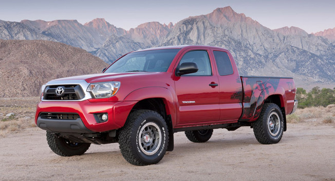

wonder if tacoma baja suspension will fit 4runner

The front end components probably would, but why? You can do a whole lot better aftermarket for a whole lot cheaper. Sounds like they are just adding a 2" lift spring in front and AAL or different leaf pack in the rear.
For the price you would pay Toyota for a set of those coilovers you could buy two sets of Icons and have a much better set-up. I do however really like the wheels!
Curious how they only went two inches...
