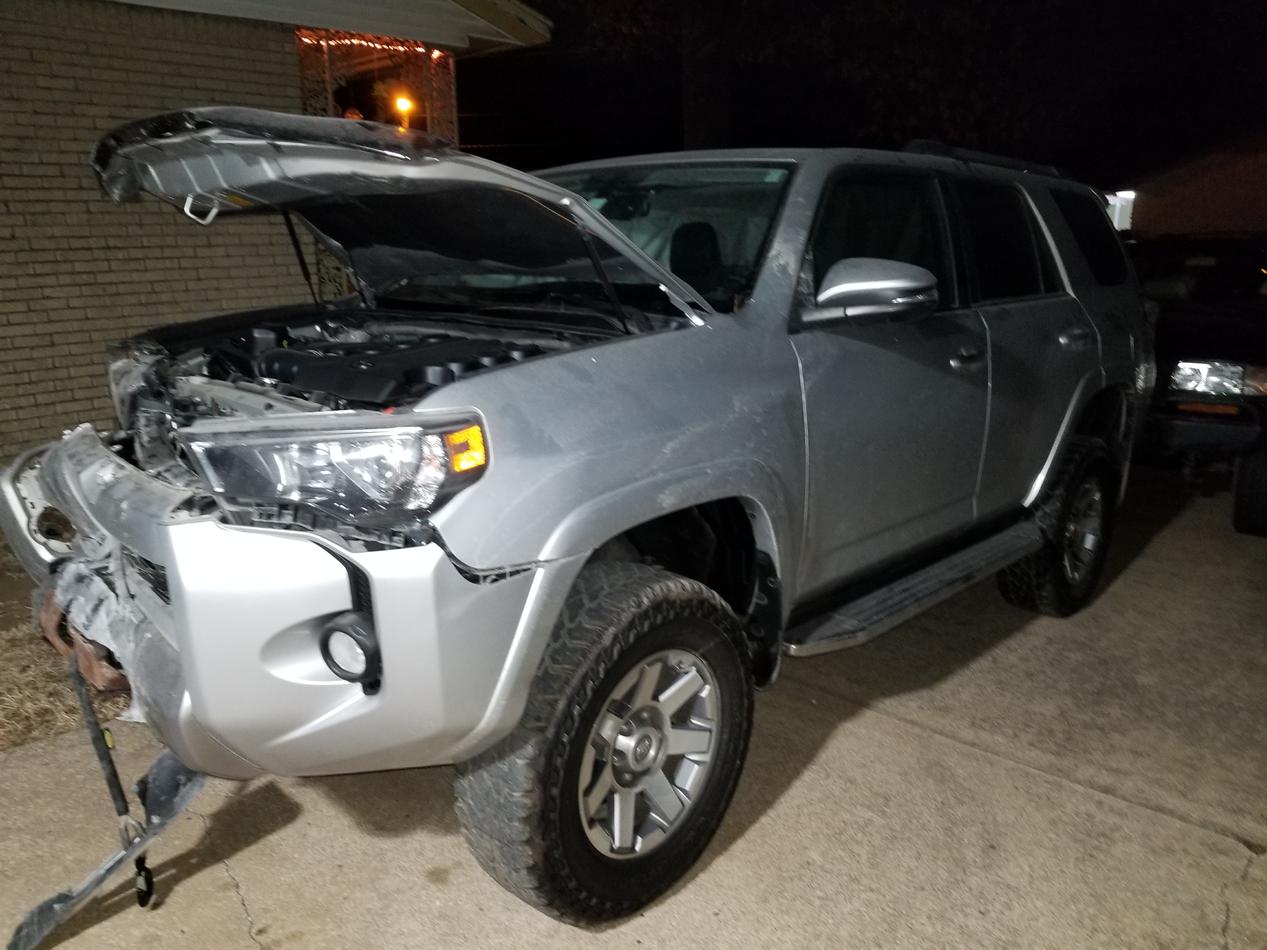

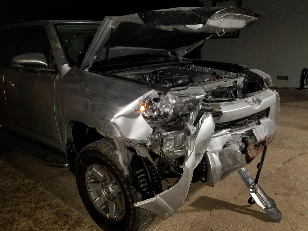

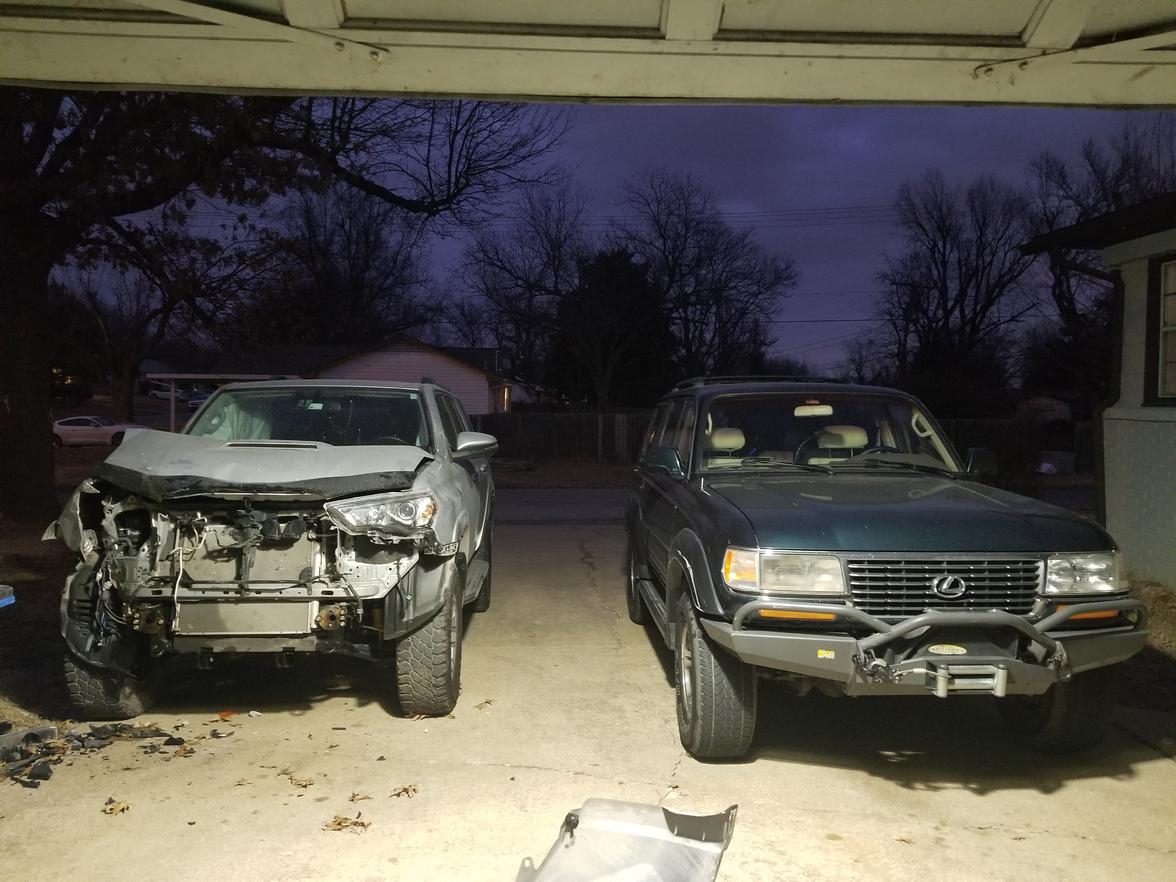

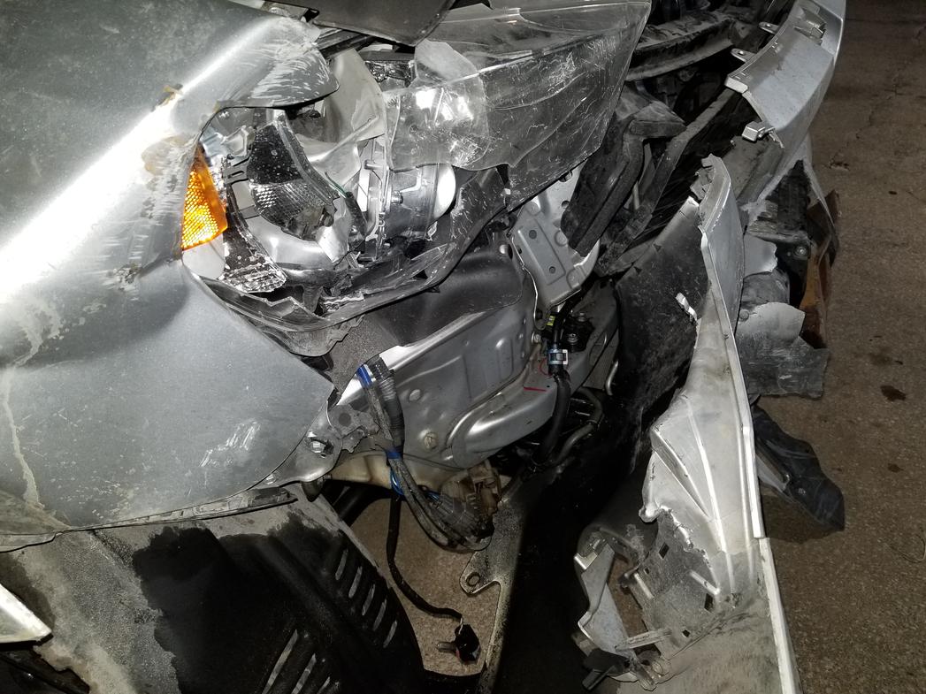

I was in mexico and wrecked the 4runner I was not aware insurance did not cover me outside the US, so theyre completely denying the claim. Fortunately the damage is limited to the pics. However, damages are going to be costly.
It starts and runs fine, power steering is out, it leaked all the PS fluid. Im not sure if it was just a hose coming undone or something more. No other fluids leaking.
All airbags deployed
So just taking care of the airbags will run about $7500 according to toyota. Is this reasonable? Can you get away replacing just front and passanger airbags?
I havent taken it to a shop to get estimate on the damage but if anyone here is knowledgeable about this what do you all reckon the outside damage will run me?
I own the truck outright so im debating whether i should just sell as is. How much would would a 4 runner in current condition be worth? 2015 trail premium 37k miles.

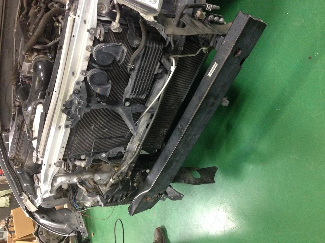

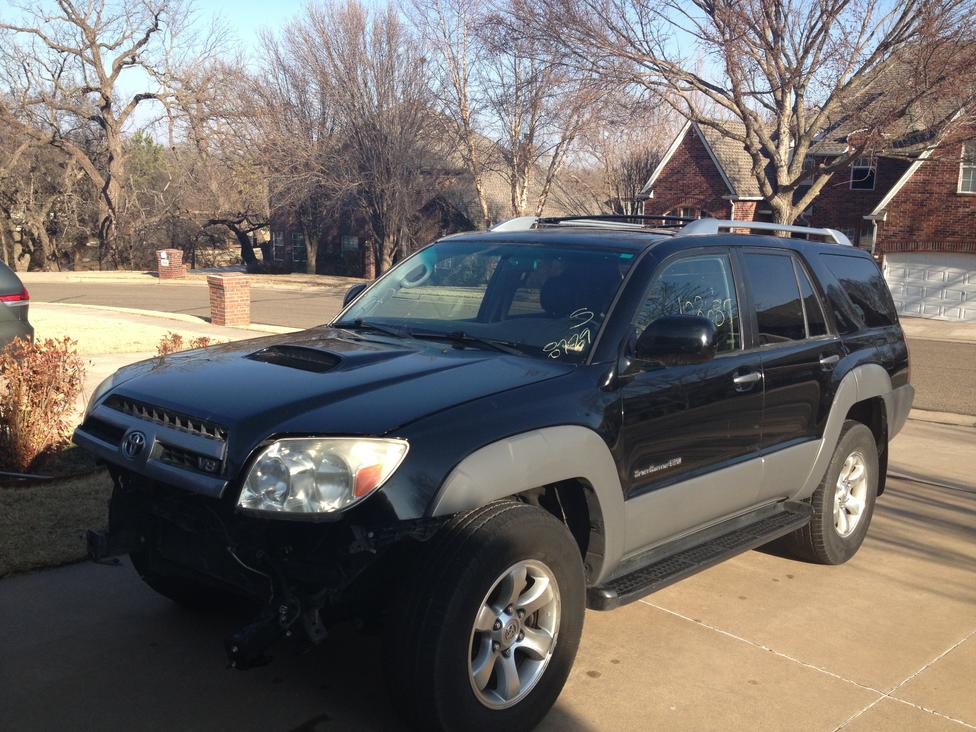

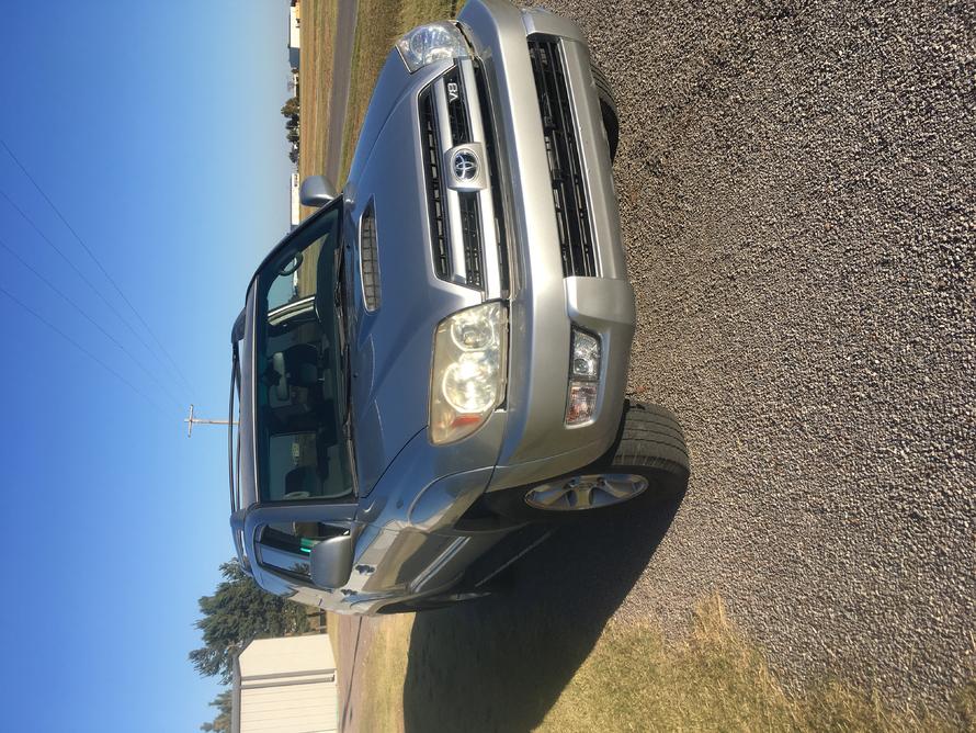

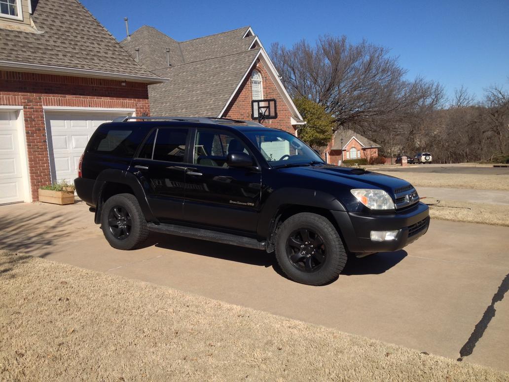

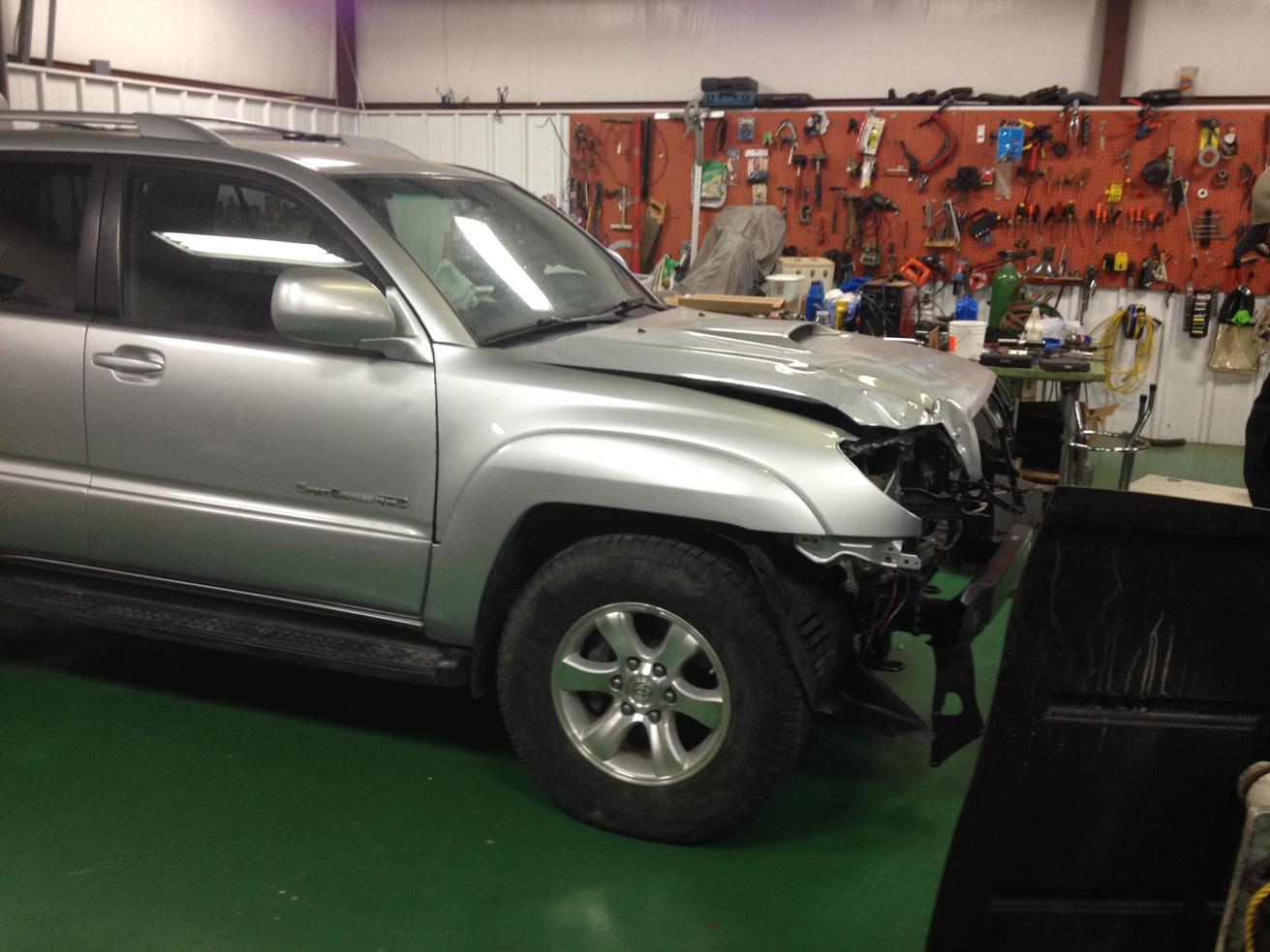

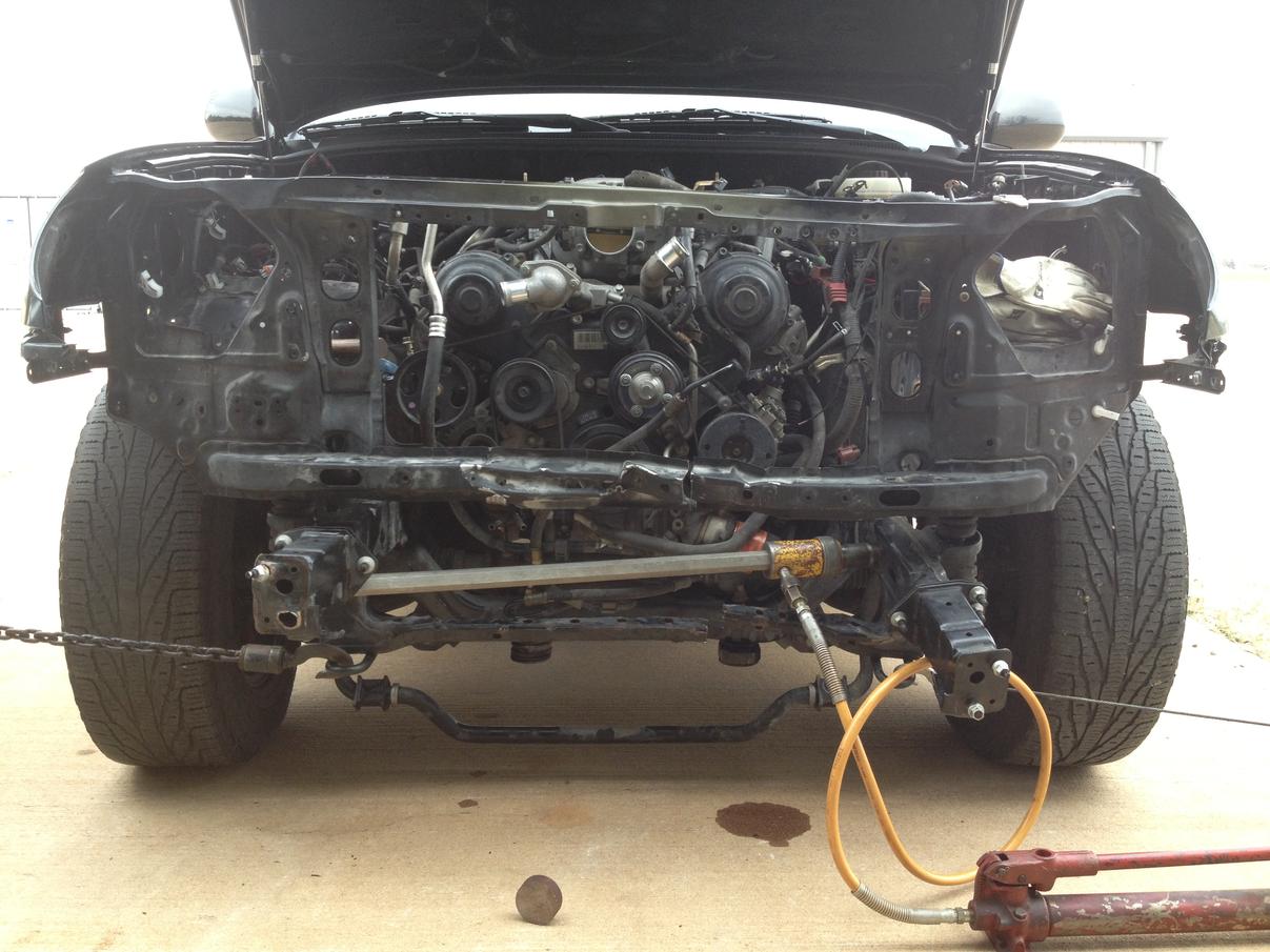

Howdy fellow Okie! It’s going to cost you. I have rebuilt two 4th Gens. #3 required no painting or air bags, but I had to replace the front of the frame and the bumper. Parts didn’t cost me anything because I had the parts. #4 required repainting the hood, one fender, and the bumper, including a frame repair and air bags, and radiator support. I did all the work myself and had most of the parts, but the paint was expensive.
Looks Like you will need at least the inner fender, fender, hood, all the bumper pieces, including the air bags. Probably ac lines, power steering lines or pump. Unless you do the work yourself it will cost you a lot. The air bag module will need to be reset, myairbags.com. Get the parts from salvage not OEM to save more. But you need to make sure the frame isn't damaged.
Follow copart and IAAI auctions for similar vehicles. They have sites in OK and TX so you can get market values.
#3 Before, During, & After
#4 Before, During, & After

At least the 97 land cruiser still good :)... looks like itll be getting a winch upgrade
I took it apart today. Frame is intact. Ac lines made it ok , just a bit bent here and there. Power steering metal hose got crushed and thats where all the PS fluid escaped. All in all not too bad, just need to get that inner fener and front assembly straighted out to get all the other pieces to go back together.

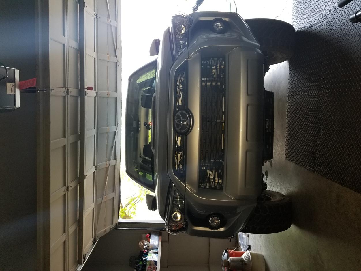

Back in business. Took a while because i had to find the best prices on all the parts myself and then the shop i took it to had a delay getting it done. $4000 in labor and about $6000 in parts including all airbags. Used myairbags.com to save some money on resetting the airbag module, got that suggestion here, thanks.
