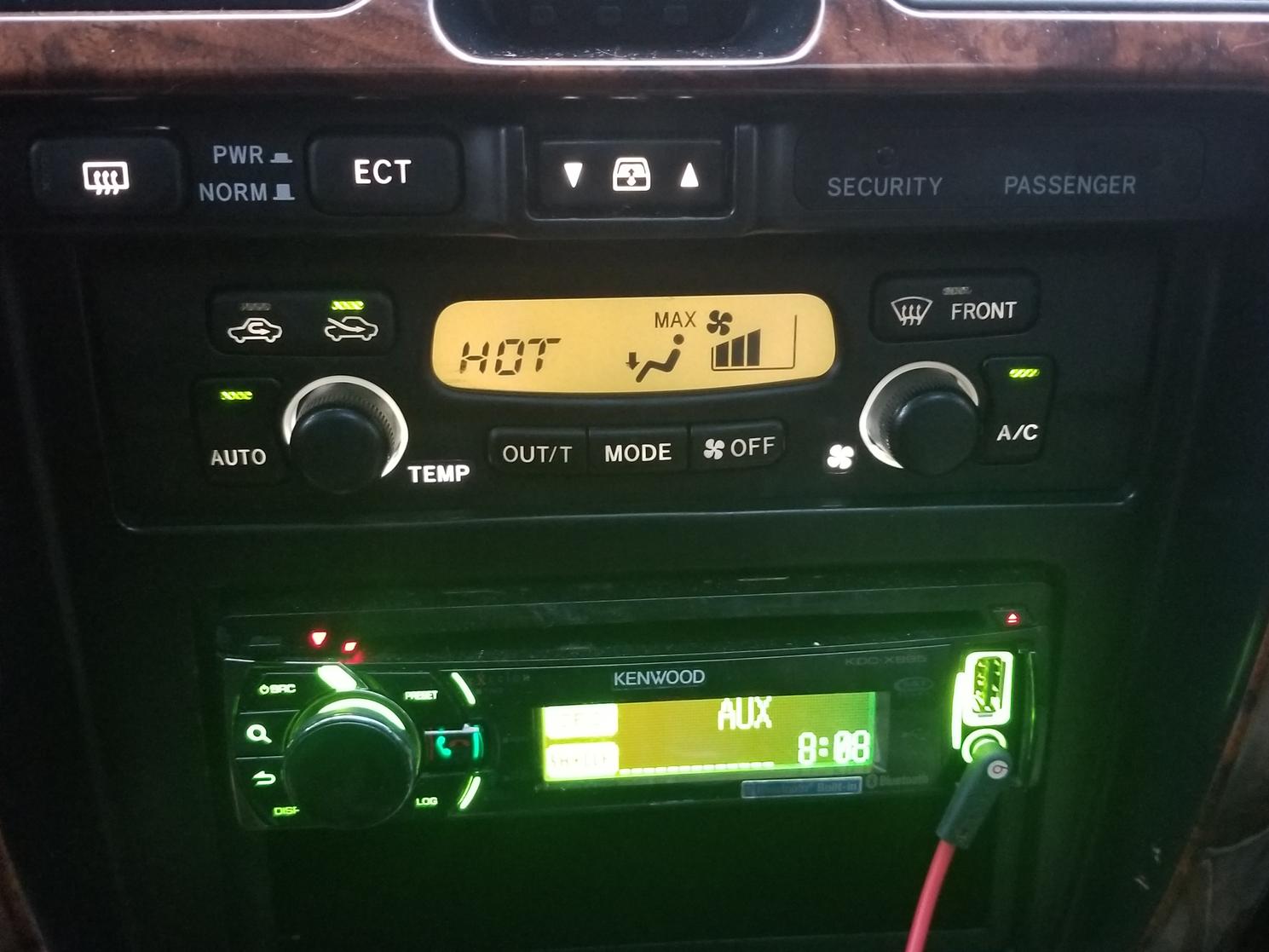

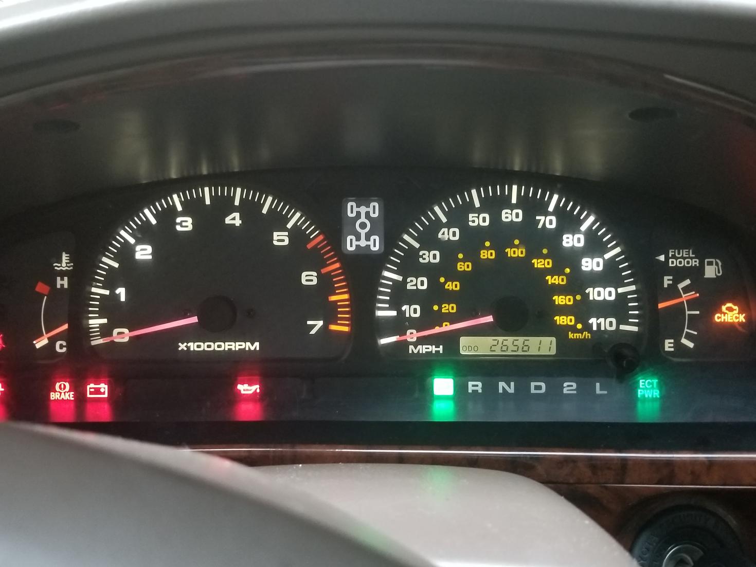

Just finished installing new gauge and hvac lights. Big thanks to the OP for the guide, definitely simplified things. Went with all red.

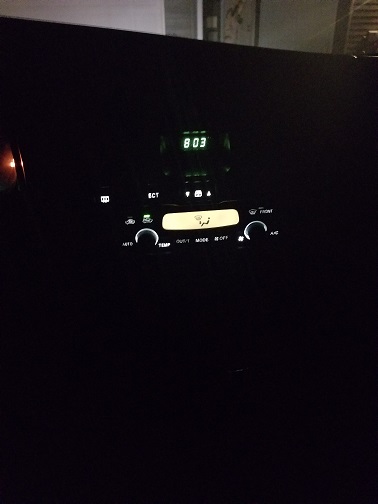

Mine has a yellow tint to it. I used the superbright 6000k. Same LED's I used for everything else that's white
I used

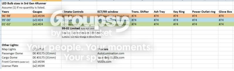

NEOx LED Bulb - High Power Instrument Panel LED | Super Bright LEDs
In 3 and 4 mm sizes, which correlate to neo-wedge A and B.
The ac unit definitely looks a little more of a yellow red then the rest of the gauges but i think that is just coloring inherent to the screen.
The ac unit bulbs are also much brighter than the options for the gauges, it hasn't bothered me too much but others might find it annoying.

Just an FYI for all the future endeavors, I just finished this project on my 2000 Limited and the #74 bulb fit in place of the "required" #24. I spent quite some time comparing website dimensions and measuring bulbs over and over with a caliper, and it worked (in my case).
OP- don't know if its worth editing the original post (doesn't seem like anyone reads it anyway ha) but it may help some in their quest for 74vs24 answers.

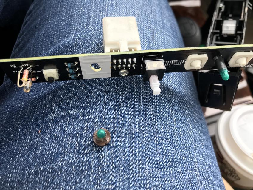

Help! I’m at this point with the ECT module. Do I unwind the wire to get the bulb out?
Can I get one from a dealer?
Quick please need help.

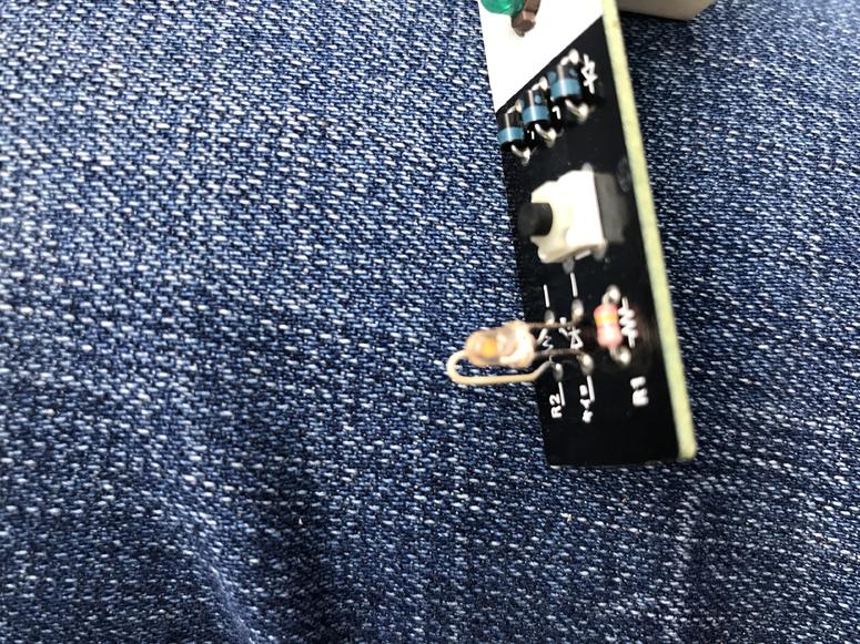

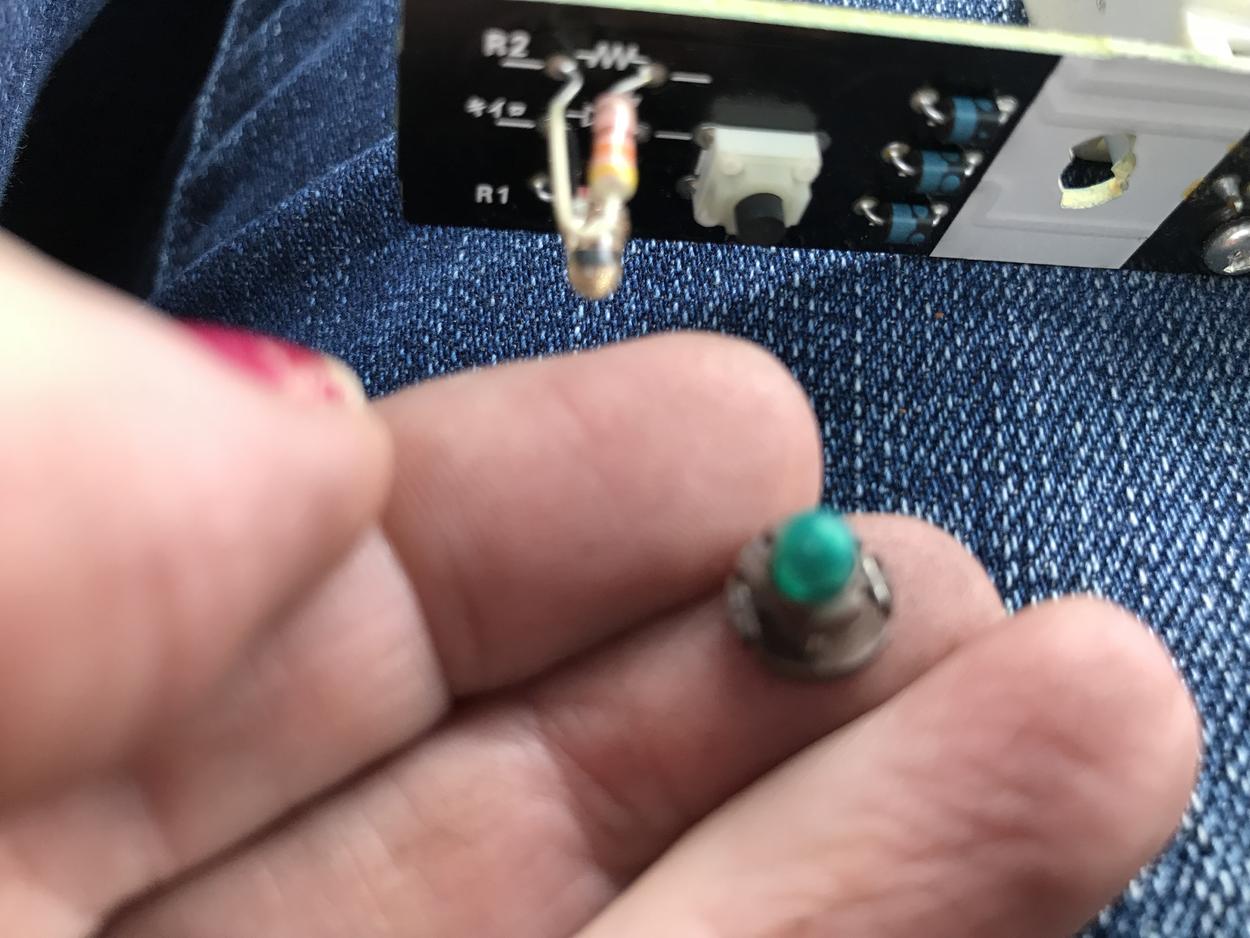

Also this light doesn’t light up. Can it be changed or am I incorrect?
I would replace both those bulbs if I were in there. I'll bet once you snap it all together you may break the filament in those bulbs. Not sure which one of these is the "tall" bulb. Less than $5 each from Camelback (shipping will probably be more)
90010-01041
90010-01042
The other "bulb" is an LED. Would be highly surprised if that was out. Only comes on when you press the button on.
The 2nd pic shows an LED, it's replaceable but requires de-soldering the old one from the PCB then re-soldering a new one back it's place. The first pic shows the incandescent bulbs. The entire bulb is what Toyota sells, you simply twist the plastic base , pull out the entire bulb the install the new lamp. If you have a decent electronics supply store around your area, you could by some new 12V bulbs, I believe that they're an eiko 2174 bulbs.
You will need to unwrap the leads from the old bulbs and fish them through the base. Then you fish the new leads through the base, wrap the leads around the tabs and trim off the access. You also have to remove the green silicon filter from the old bulb and transfer it to the new bulb. It can be tedious and sometimes the silicon filter just crumbles. It's completely doable, you just need to be aware that sometimes it won't go as planned. Those small silicon filters are a PIA to purchase, they are always a mail order part and usually a minimum quantity makes it not worth the effort. Good luck and don't be afraid to give it a go, nothing ventured, nothing gained !
