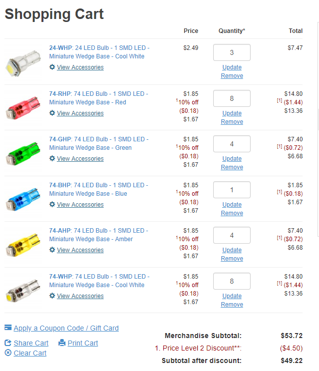

bulb verification
Sorry for reviving an old thread but I want to clarify I have all the right bulbs before I order.
I have a 1999 SR5 with manual climate controls.
For the main gauges, #24 is required or will a different bulb size fit?
I am also going to get the NEO wedge bulbs from VLED like suggested for a better fit.
Also, for the PRNDL can these be changed to LED or do they require OEM? My D light is out.
