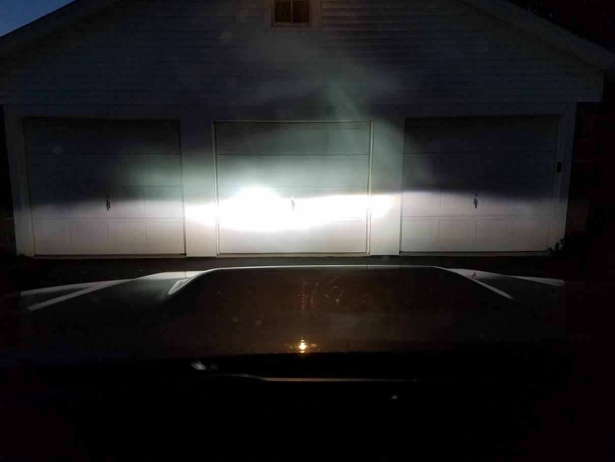

Installed HID Phillips 4300k low beam kit tonight and very impressed.
I see the LED kit for fogs is 6000k, how does this look and has anyone installed LED fogs that match closer to the 4300K? Anyone used the H16 LED FOG LIGHT KIT from XD?

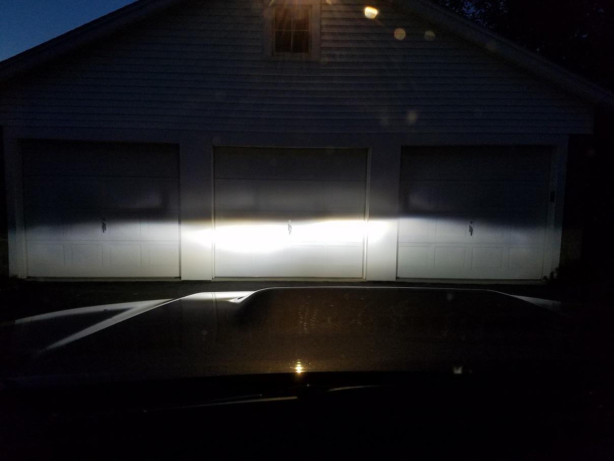

Installed the the Extreme HID Kit (4300K Philips bulbs) today. Extremely happy with the difference, both from visibility and aesthetics. Install was very straight forward as well.
Highly recommend this mod!
Again, a big thank you to Steve [MENTION=12905]XenonDepot[/MENTION] for all of the info and assistance.
Before:
After:

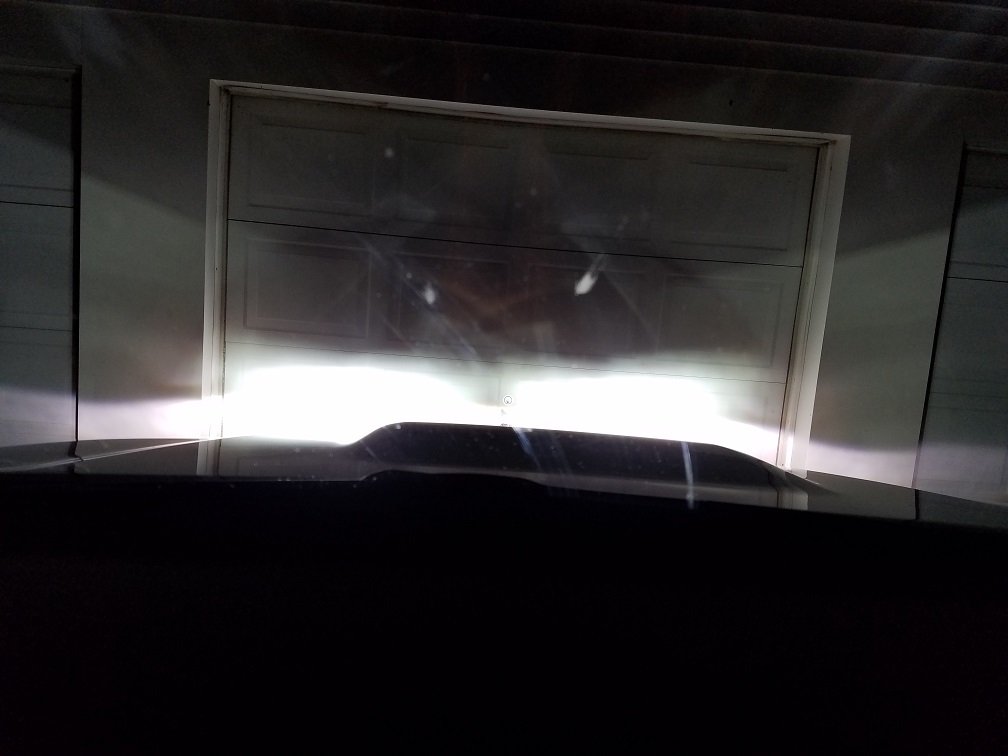

Just popped these bad boys in today:
9005 LED Headlight Kit [DRL Upgrade:With DRL]
H11 HID Kit | Xtreme HID [HID Color & Bulb Options:5000K]
Two questions:
1) Does the driver side LED high beam just need to be re-aimed? or did I screw some thing up?

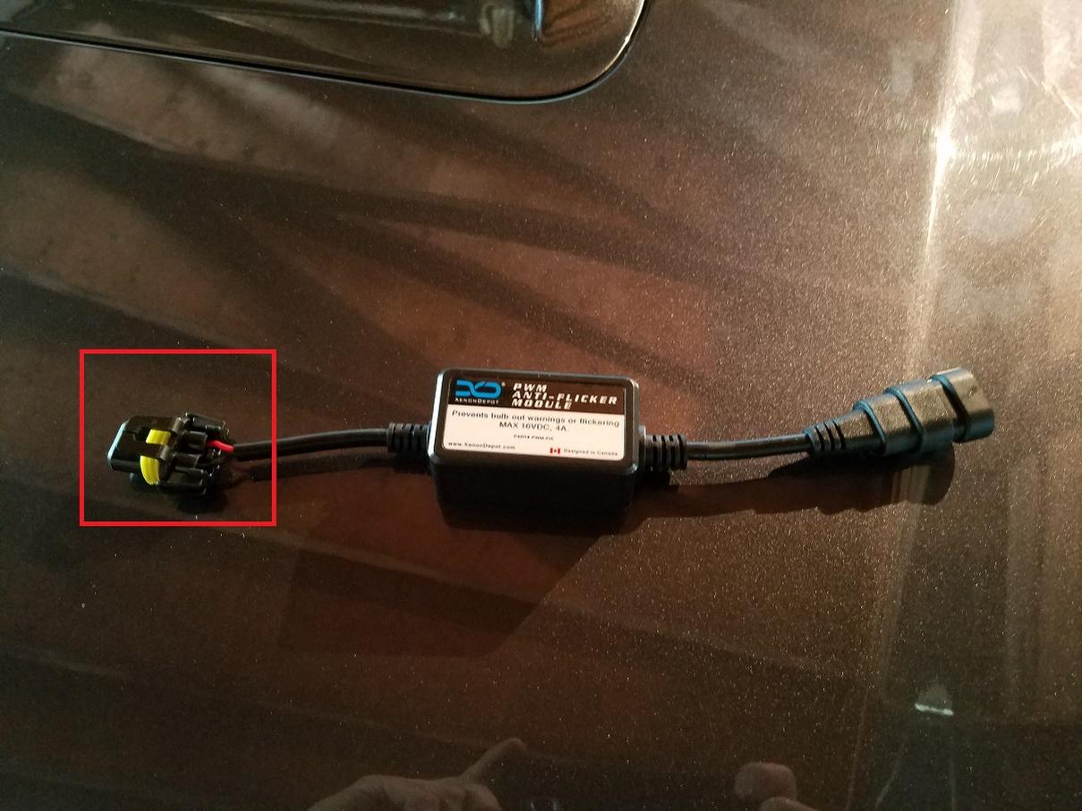

2) I cannot get either DRL upgrade basalts to work. I tried reversing the polarity on the balasts, but that did not work. Any ideas?

The bulb will only fit it one way, so make sure that you've got all 3 tabs locked in. It appears as if you may of only got 2 out of the 3 tabs locked in which would make the bulb sit at an angle.
PWM module - How did you reverse the polarity?
Steve
[MENTION=131471]CF_Machete[/MENTION]:
Steve
Nailed it. Sure enough my passenger side high beam had one of the three prongs out of the fixture. Answering my own question, yes I screwed something up:redbrick:
The pic below shows the plugs that I switched on the anti-flicker module

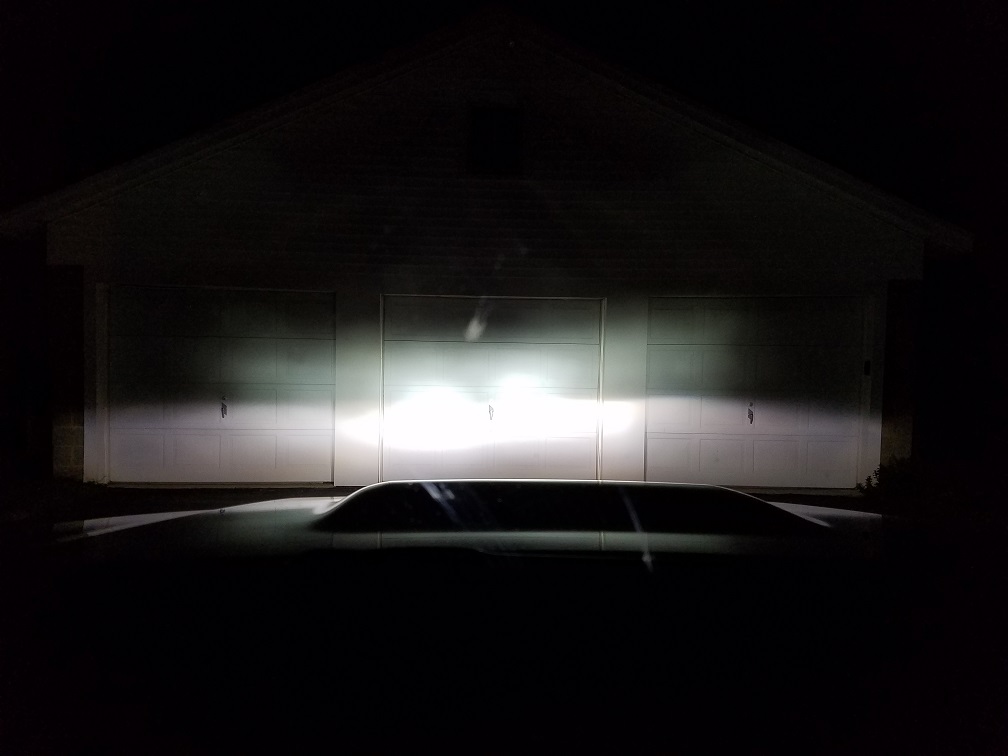

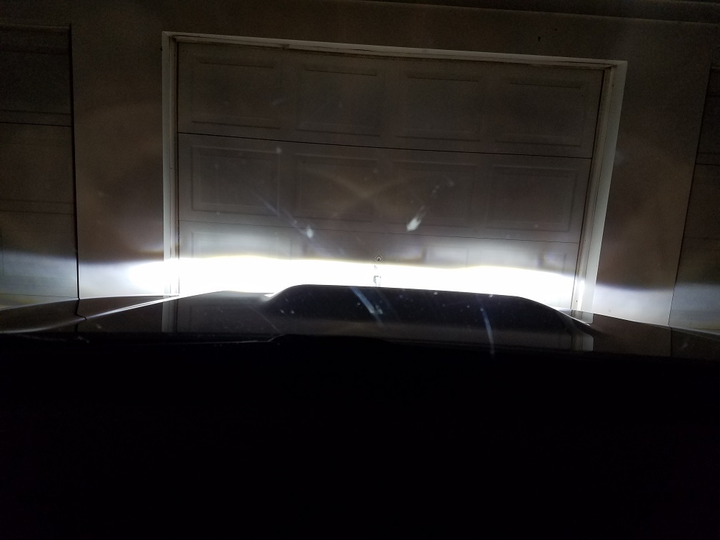

Night pics after removing the jackass factor from the equation. I've changed several light bulbs on various vehicles and never had this happen... but I'm own up.
The beam spread looks way better in person, very even distribution of light. Threw in a close low beam shot as well. Pardon the bugs, its been brutal here lately.
