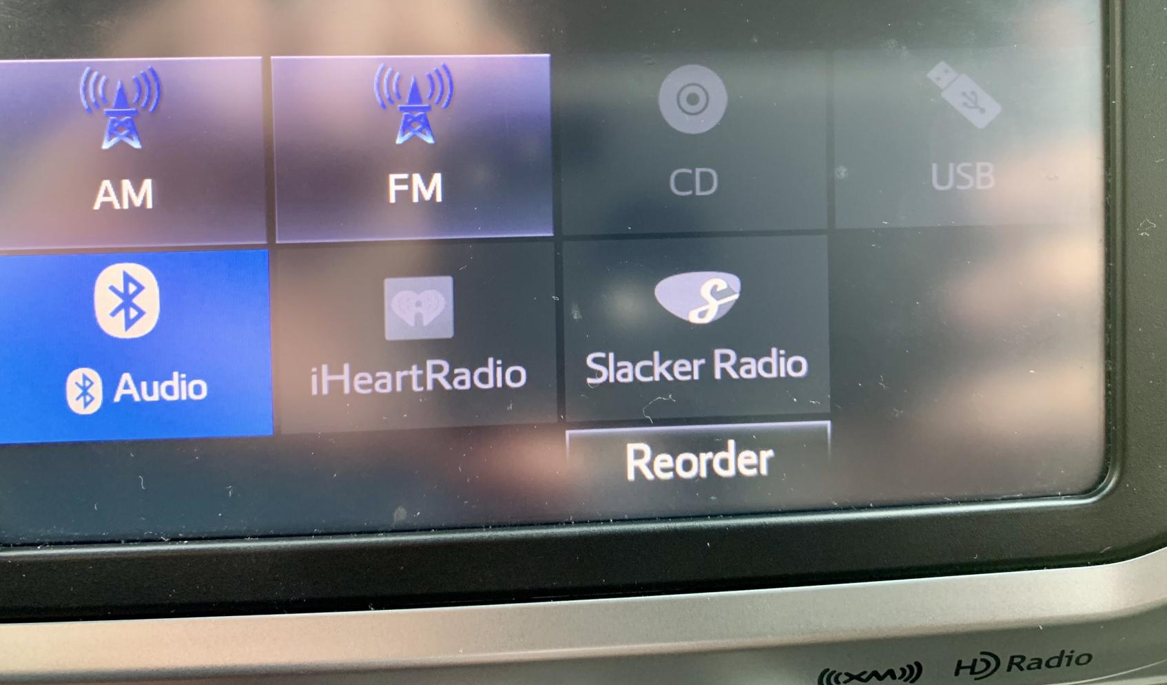

I’m going through this right now. Here’s a pic of my screen.
