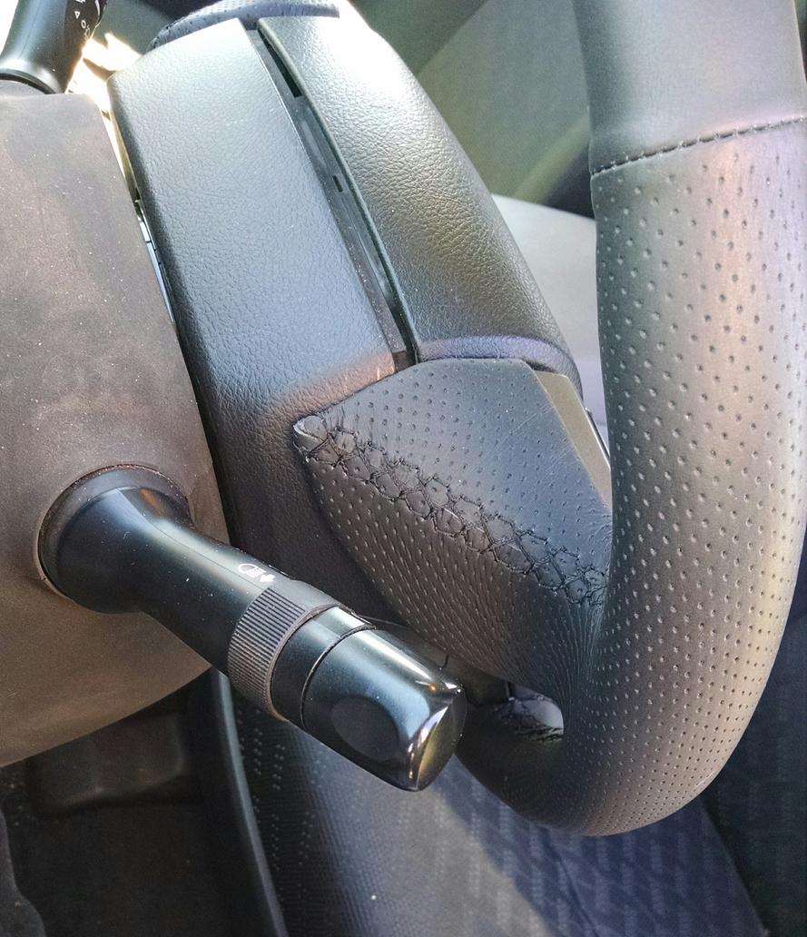

I did not take off my steering wheel nor remove my airbag and trim to do the install but if I did it again I probably would. Instead, I used the flat tool they provide in the kit to press the leather into the gaps. Tucking in the leather to the gaps takes time and being flexible helps! 

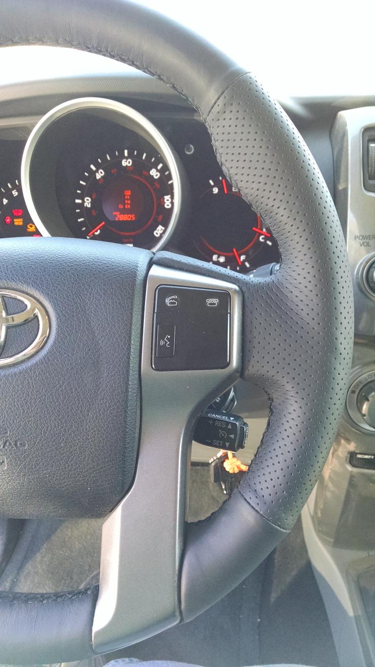

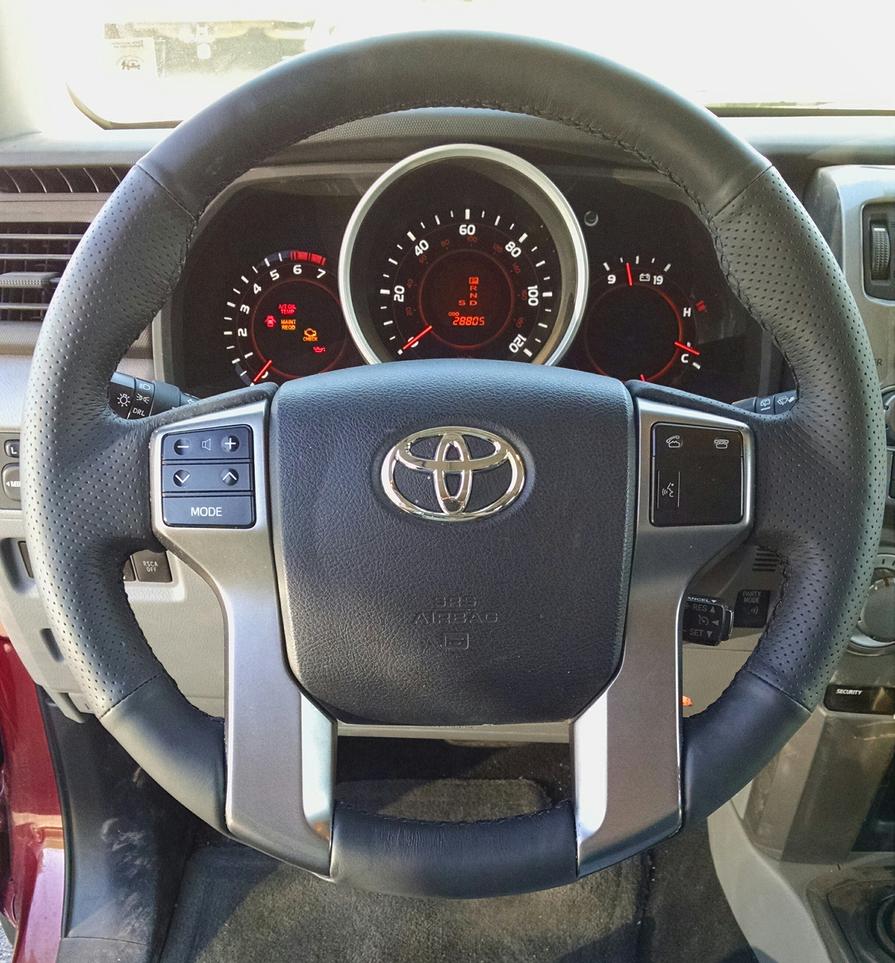

I love this cover. It feels GREAT and the leather quality is awesome. Here are a few photos of mine after the install. Excuse the red dirt covering everything but I was in Moab a couple of weeks ago.
This cover gets tight just like the OEM wheel.

1. I sewed the 6” bottom section first. Then I used the tool to tuck in the ends behind the verts.
2. I sewed the two sections below the horizontal spokes next. I used the tool to tuck in the ends behind the verts.

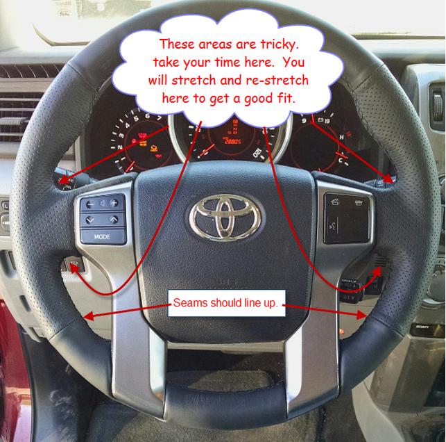

Place the cover on the wheel and get it lined up.
This process will take some time, don’t rush!!! Take your time and get it perfect.
The little “wings” will face you.
I started at the bottom. It was easy to center this 6” section between the vertical trim pieces. When I was happy, I used my knee/leg to hold it in place from below and then my hands were free to push the rest of the cover on.
Center the seam on the centerline of the wheel.
1. Use the thumb holders to verify position. Those little bumps are a great point of reference.
2. The seams where the leather is sewn should line up and touch at the centerline of the wheel.
