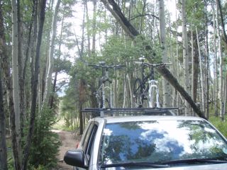

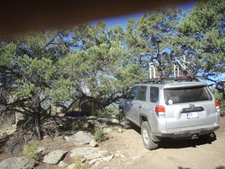

Just keep in mind that with the rack and the bikes up top you now have to watch out for not only obstacles on the trail but also low hanging branches and trees. Took out my new Trail with Yakima rack to hit up some 4WD trails and ride the Monarch Crest this weekend. Great times and everything worked better than I could have hoped. (even if there were some random pine branches stuck in my bike at the end of the day).

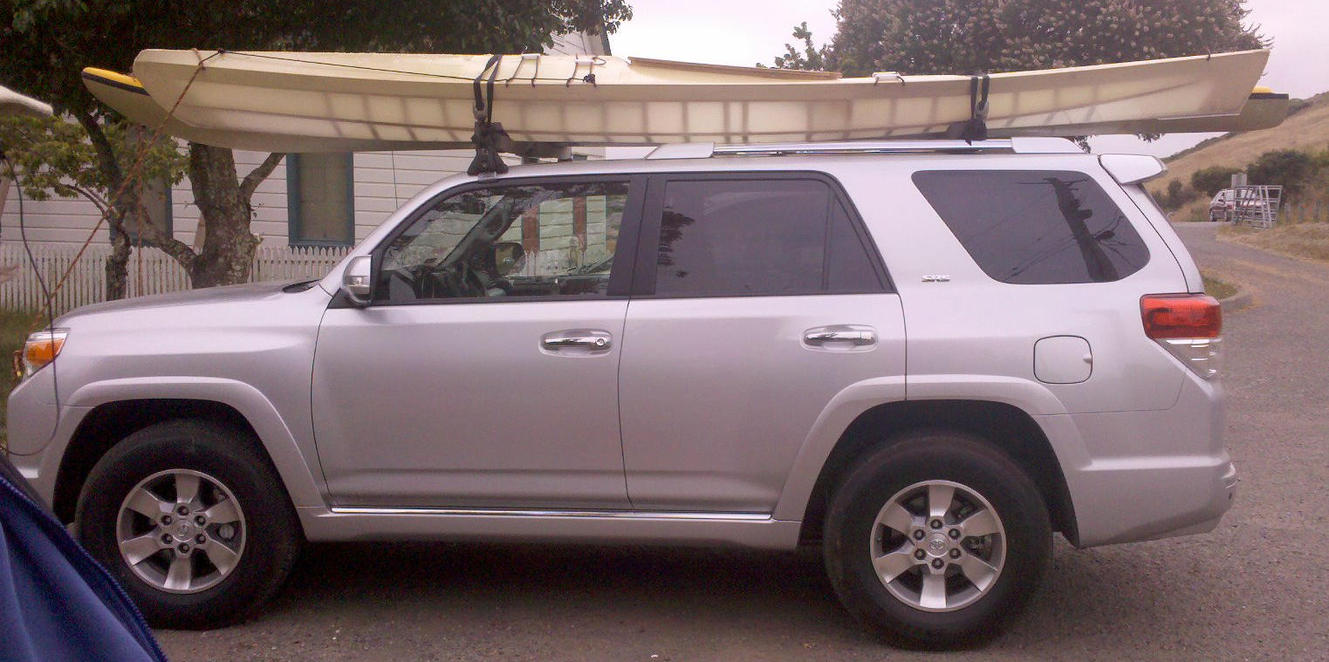

Confirming everything Desertred said. The Q-towers with Q62 clips are an excellent fit. I installed a set over the front door, and use the regular Yakima towers mounted to the factory roof rack for the rear crossbar. It's too bad that Yakima continues to ignore this issue, and refuses to "authorize" this installation.
At least this installation allows for mounting a cargo box and a kayak far enough forward on the roof for appropriate tie-downs (on the kayak) fore and aft, and allows the cargo hatch to open fully.

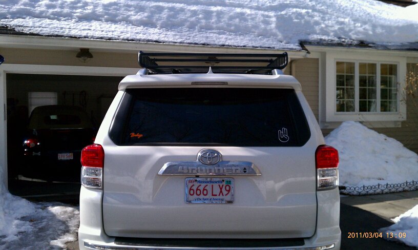

Mega Warrior! :guitar2:
