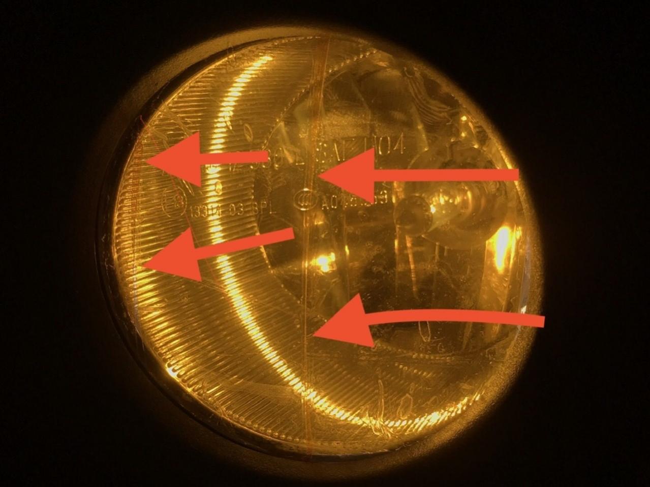

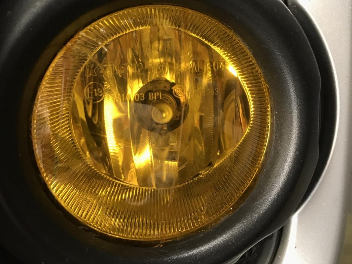

I just tried this on one fog lamp, drivers side. I have some rolls of one-inch wide and two-inch wide kapton tape, so it took three strips to cover the stock fog lamp. You can see the seams in the photo where I overlapped them a little. I got a few tiny bubbles and puckers, but this is a quick and dirty test.
Results:
Well, it does work. I get yellow light that looks pleasing on my garage wall. I cannot see if the seams make any difference. I’ll test it out tonight and see how it compares to the white light on the passenger side.
Notes:
It’s a little tricky doing this while they’re still installed on the truck. I positioned the tape over the lens, started pressing it down in the middle, and pressed out wrinkles toward the edges. If you lift up the tape after it’s been on the lens the adhesive gets cloudy, so when I did that I discarded it and started again. I put a strip of tape over the lens and housing, pressed out wrinkles, and trimmed the ends with an xacto knife, tucking the last bit under the lip of the housing.
To do a more professional job I’d remove the lamps from the truck, get some wider tape, and maybe use a heat gun or hairdryer to warm it so it stretches a little (if it does stretch) around the slight roundness of the lens.
Another note: my stock foglamps are more than 3 inches in diameter, more like 3.8 linear inches with the curvature, so you’ll need a seam somewhere.

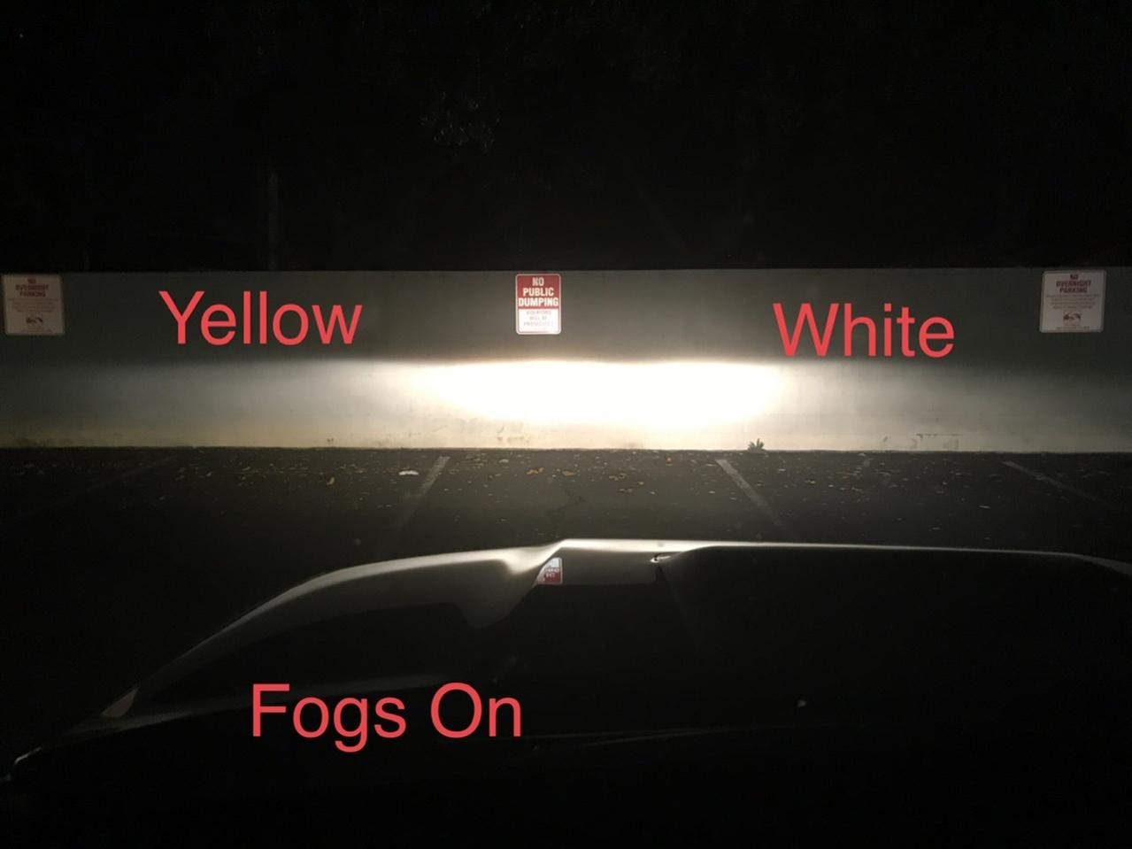

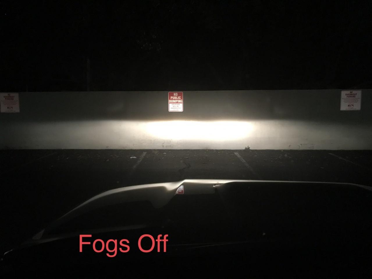

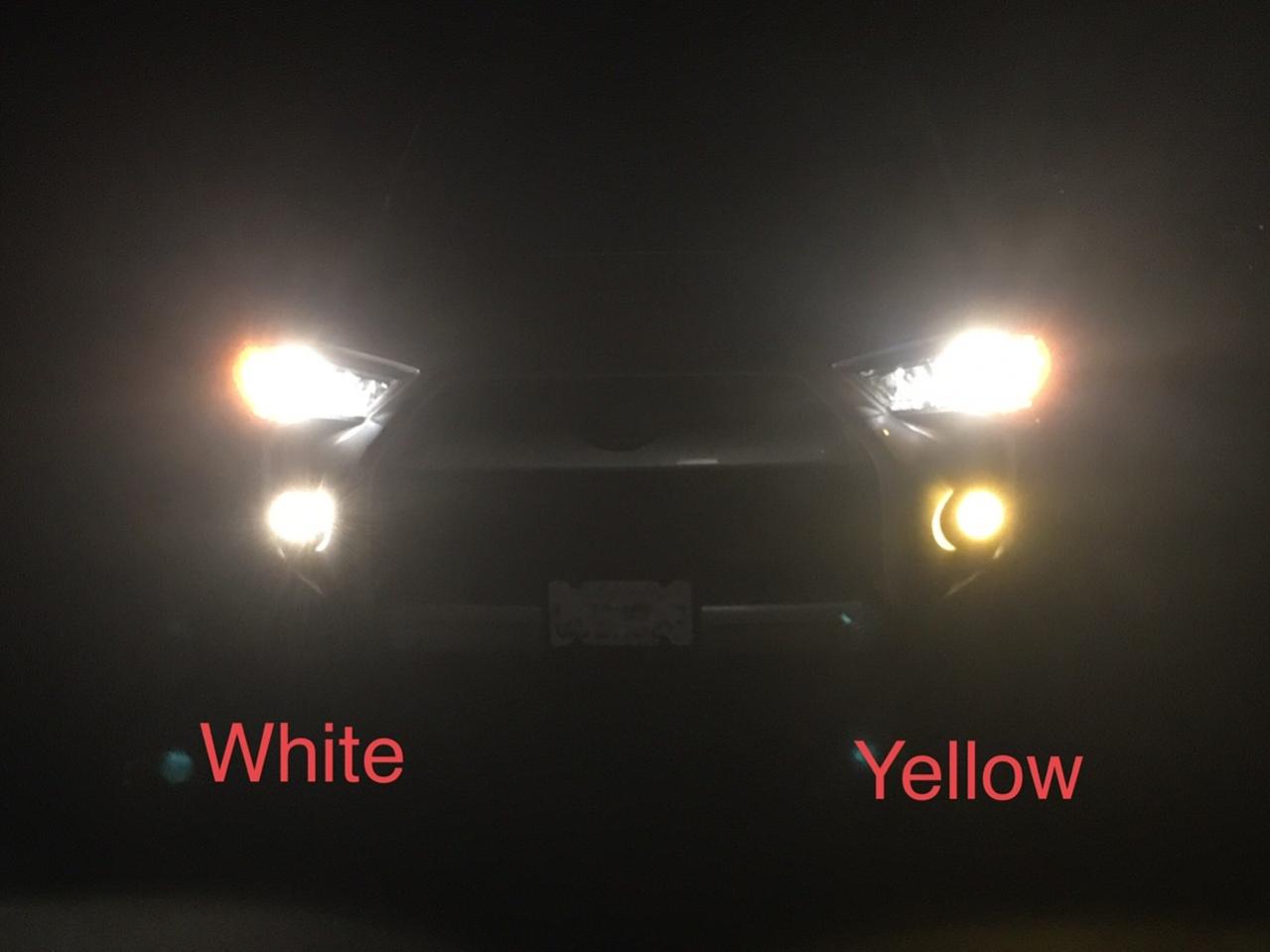

Well, I tried the comparison at night in clear weather. Tried to see the difference driving around the dark city streets and took some pics against a white wall. There definitely is yellow light but it’s pretty subtle. I agree there seems to be less brightness to the light, but that’s how our eyes work. The selective yellow gets rid of the blue which causes back scatter in fog. Fog lights are designed to do just that, low angle light to minimize light bouncing back into your eyes in really nasty slow driving conditions, so you can see the road and shoulders and stay on the road. Fog lights are not supposed to be used as regular low beam assisted driving lights.
I don’t drive at night in fog much or in snow storms. Those two scenarios would be the real test. I’ll keep an eye on the weather report for any foggy coastal conditions around here and see if I can get out there and notice any performance difference.
Anyway, here are some pics. Not very remarkable.
