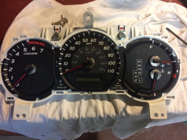

For the folks dealing with the SR5/Sport cluster, you could always try something like this.
Fluorescent Speedo & Gauge Needle Restoration Paint - HiPo Parts Garage
They have several colors available. This might be the ticket to using white leds and still have blue (or whatever color is available) needles. This is something that I have not tried as my truck is a Limited.
Thanks Cisco, I ordered the blue. Did 3 coats of paint on the back of each needle, and kinda wiped them down after each coat. Will try to explain better later. Good find. I'm happy
Thanks for adding the pic. Yea those are pretty orange. Anyone have any luck repainting the needle red? I'm wondering if with the white light it would be almost pink at night. Maybe painting with a dark red paint would help?
Go for it. I like the stuff.

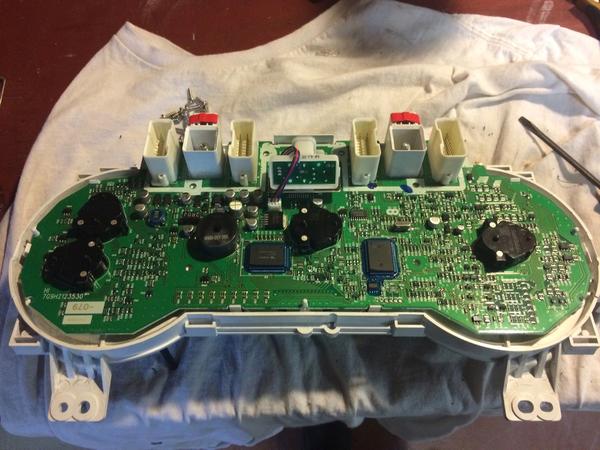

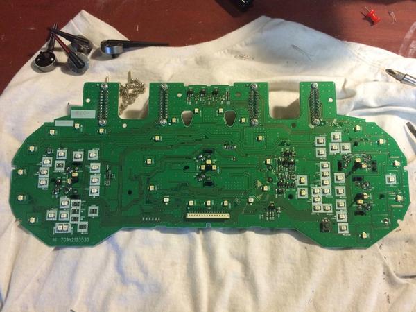

[MENTION=30225]yosh2000[/MENTION] thanks for talking back and forth with me on the swap. I decided to do it myself, and all went well. Here are some pics.

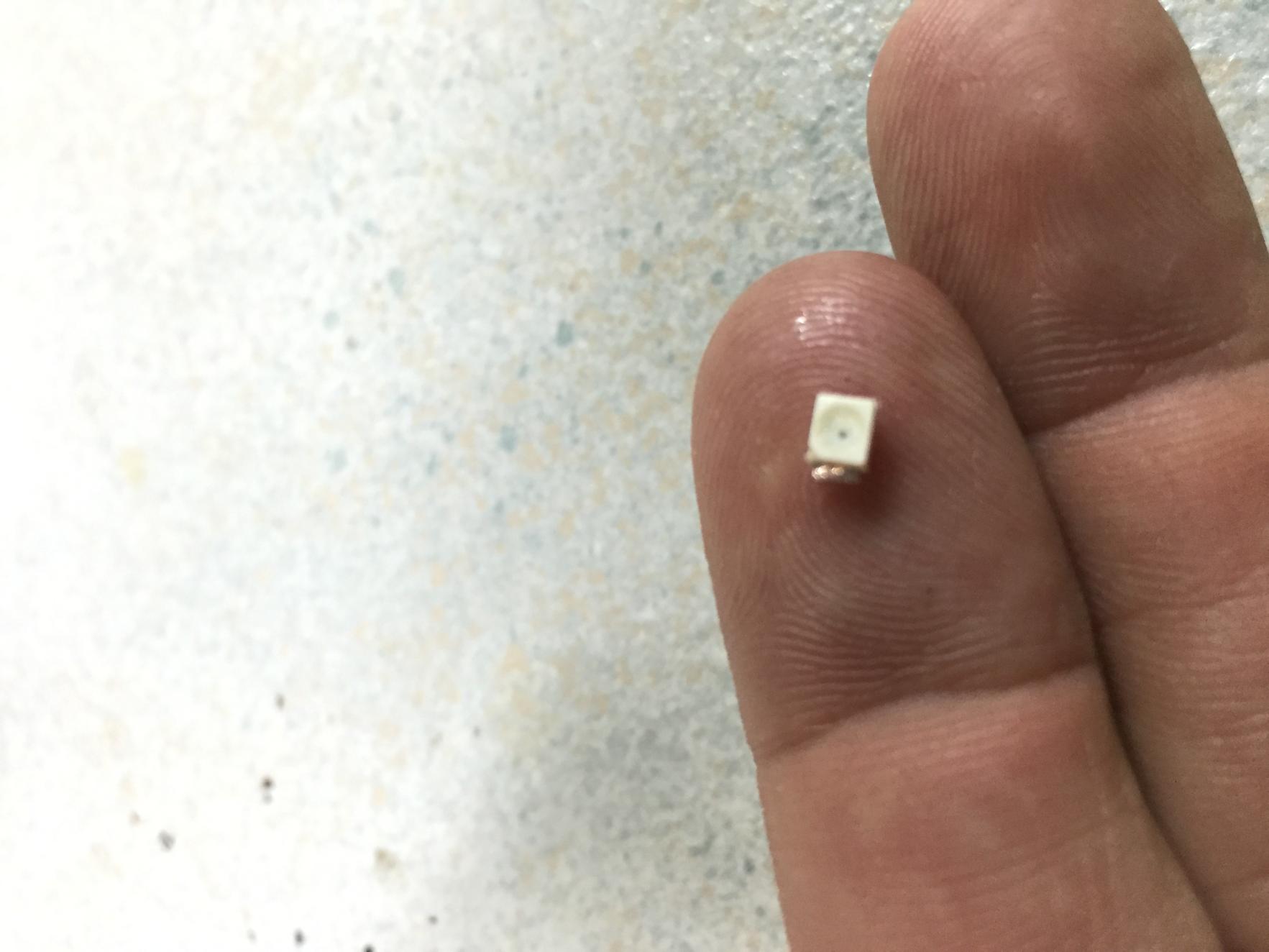

How many terminals do each plcc bulb have? Would love to do this, but would really like to get a good idea as to the difficulty level. Never been a fantastic solderer. 1st gen tacoma was plug and play.

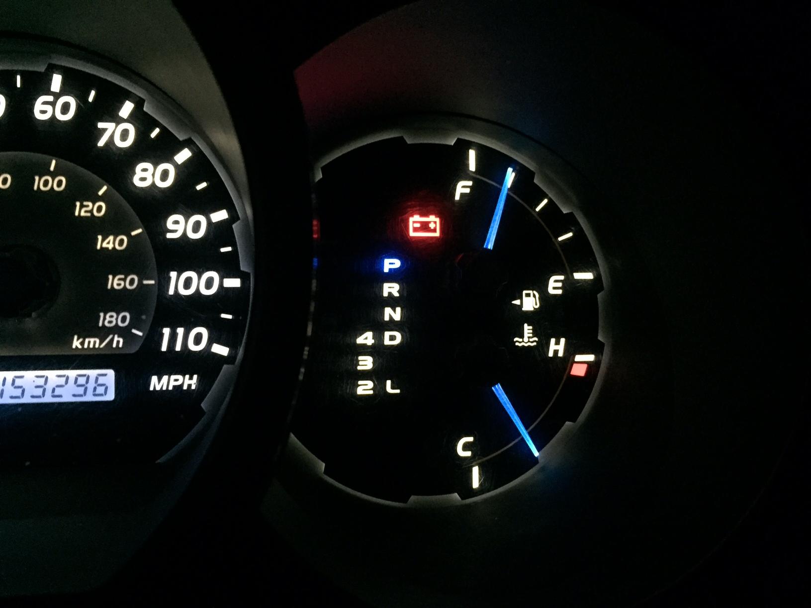

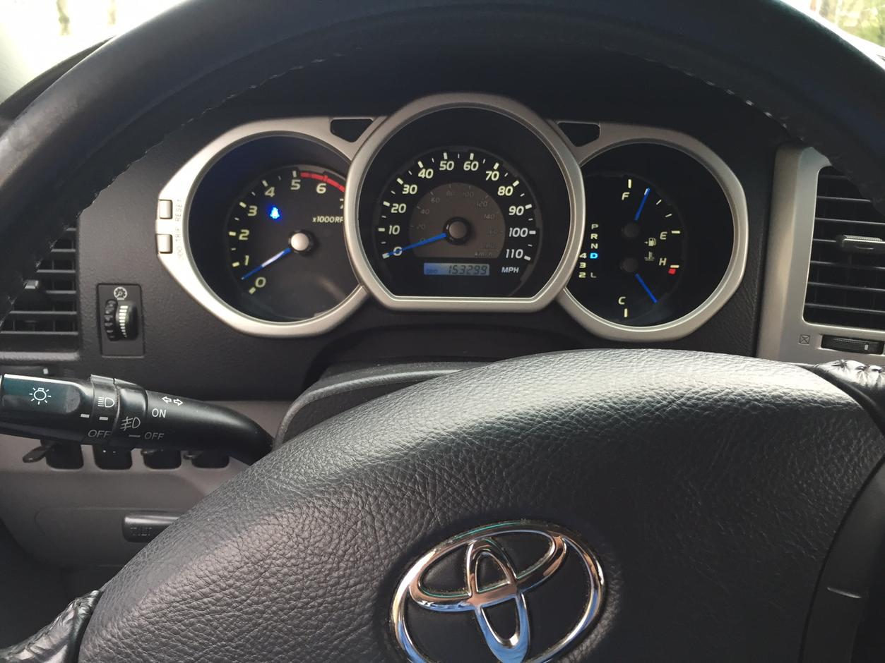

Well, after selling my 2008 Limited, I just couldn't keep the ugly orange cluster in the new to me 2008 Sport. This is white leds and the green needle paint mentioned above.
Before
During
After
2 connections, each are the width of the led, so it's a HUGE area! Lol. See pic!
Before
During
After
Here is my cluster now. I didn't like the green as much as I thought I would. Blue looks much better.
