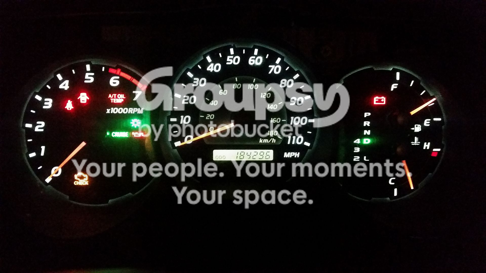

My '05 SR5 cluster
LED qty:
Background/needles: 13
Needles: N/A
Gear shift: 8 (I always recommend doing "R" in a different color for safety)
All others: 1 each indicator
20140721_211457_zpstw7auj3u.jpg~original
here is a white LED swap, OEM orange needles were left alone. needles are a little more orange in person. green headlight, cruise and gear indicators.

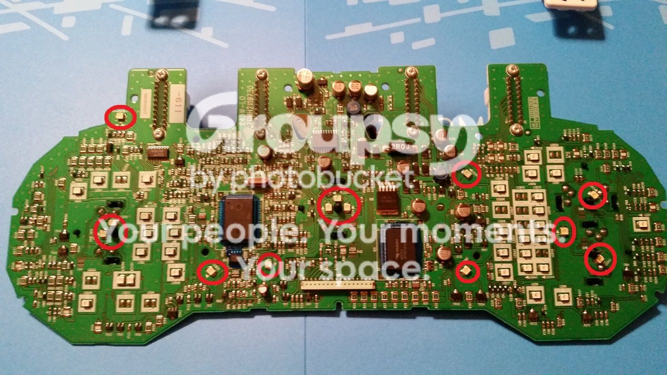

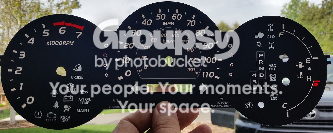

'06+ SR5 cluster (i believe this is the 06+, i know its a newer version, but i forgot to get the year of the truck when i did this)
LED qty:
Background/needles: 12
Needles: N/A
20150503_172815_zpsy89jhr6g.jpg~original
this is what the cluster face looks like. blinkers integrated into the cluster, this is why i believe this is a 06+ cluster. (i believe it was [MENTION=51046]theliman[/MENTION] 's cluster, which was an '08 sport)
20150503_172846_zpskwj2wt8t.jpg~original

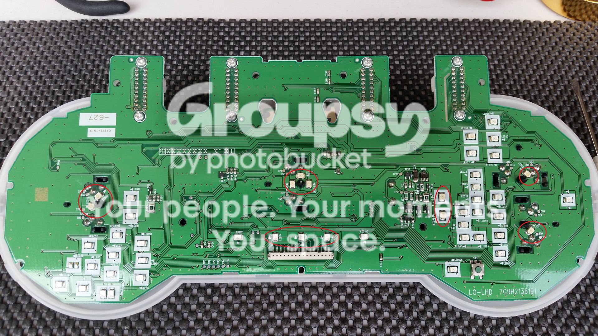

'06 Limited Trim: (all limited clusters appear to be the same. 03-04 will just have 1 less gear LED due to the 4 speed trans)
LED qty:
Background: 30
Needles: 7
Locations (03-09 Limited clusters):
limited%20background_zpssnnhdjao.jpg~original
Swapped (white background, blue needles, blue gear shifters):
IMG_1271_zpsict8wvkr.jpg~original

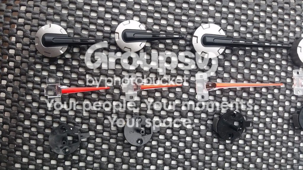

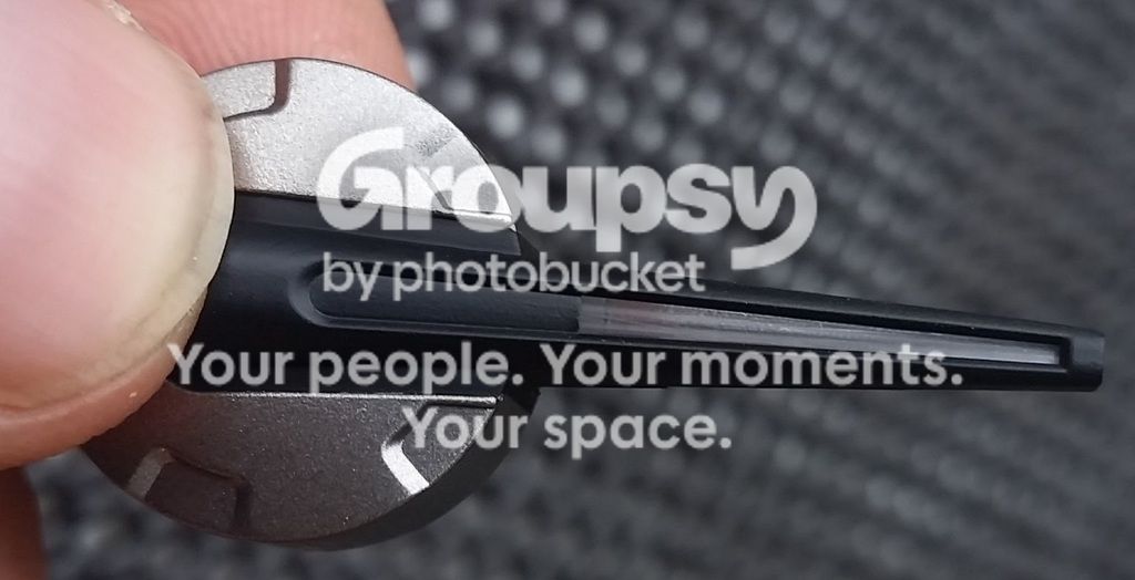

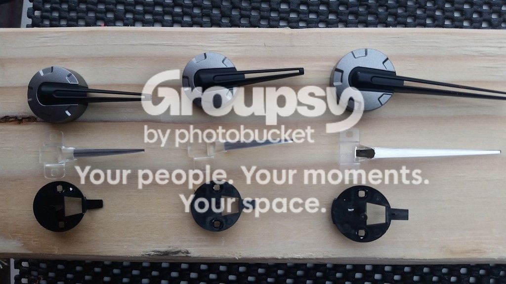

Limited needles:
to swap, cut away plastic weld on back enough to take apart. orange paint on top, chrome paint on the back. scrap the orange on top off with a hobby knife or razer blade. either leave the chrome or scrape the chrome and paint only the back white. during the day the needle will be white, but it will show whatever color LED you swapped in there.
Plastic weld cut
1faa2676-f8e9-45b0-a7b4-cee4e86337b1_zps0oxdngw5.jpg~original
All apart
20150826_175454_zpsrte942ta.jpg~original
Orange scrapped, OEM chrome on back
20150826_180917_zps2apjse7p.jpg~original
Assembled (OEM chrome on back)
20150826_175819_zpsuksujn9z.jpg~original

For the SR5/Sport cluster, the orange is on the back of the needle. It will need to be scraped off and the color of your choice applied to the back of the needle. The Limited cluster has red on the front surface of the needle with chrome on the back. Those are more involved when changing the color.
