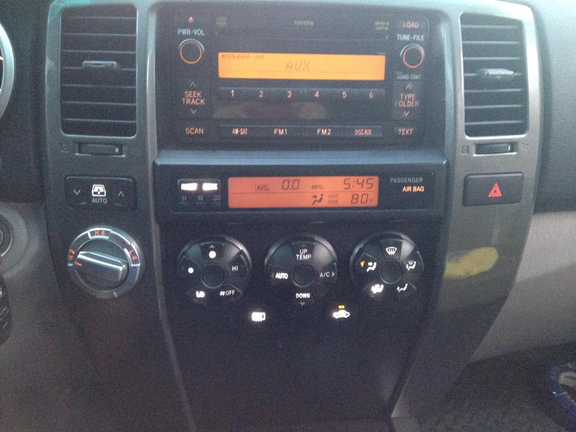

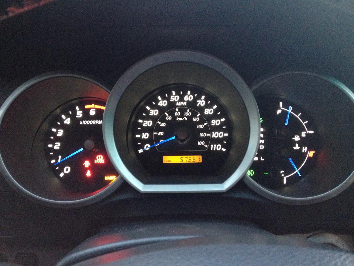

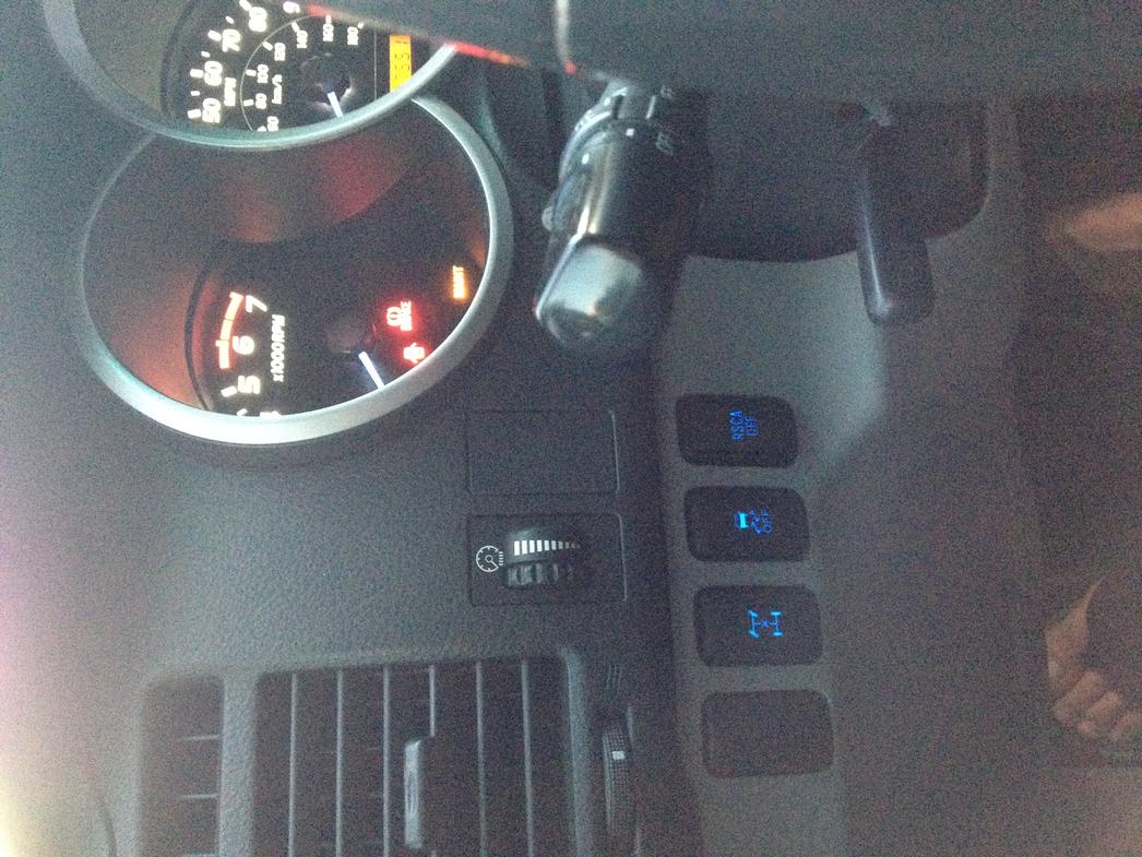

It's Done. Thanks to all of you for your help. i couldn't have done it without you. I'm stoked it came out great, and i learned how to solder too!
as you can see i do have a little more swapping to do. orange arrows on HVAC will be swapped to blue, air bag, 4wd, steering controls, cup holders, shifter, door window, and maybe i'll even do the radio.

[MENTION=135207]DreamRun08[/MENTION] any reason you didn't do the odometer?
well i know there are problems with getting the right voltage NEO LED's for the HVAC display so;
i figured i'd rather have it orange and bright than any other color and dim. i know theres other ways around it, like taking the 12v from the cigaret lighter, but then what about being able to dim it. so i thought what the hell, i'll just leave it stock.
I wanted both the screens to match so i left the ODO orange too. also i don't know if its just the pictures, but with the white LED's the HVAC screen tends to look a little greyish-green and i don't like that.
overall i think it still looks good and i kinda like the contrast.

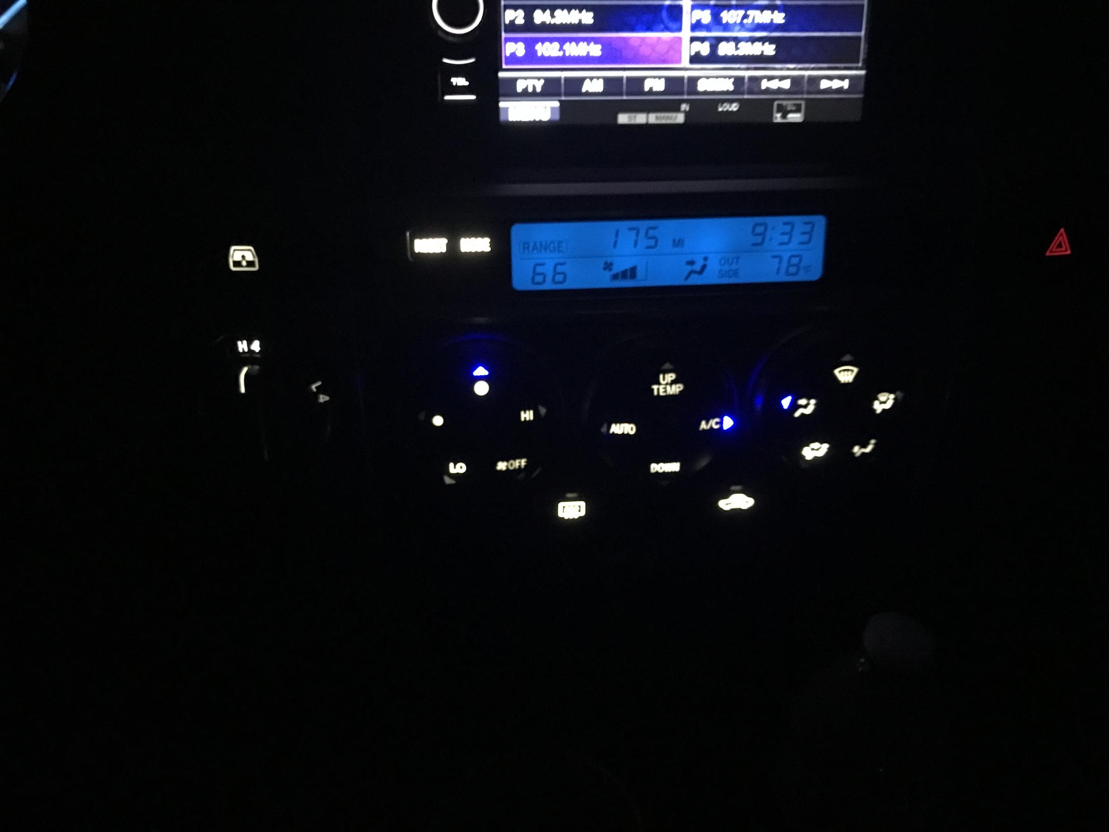

Agree completely that white looks terrible in hvac, blue looks prett good though, not as bad hot spots as the pic, still looks good how you have it!
Oh! nice, that looks good! were you able to find LED's that work properly in it or did you rewire? maybe ill change mine in the future.
Also how'd you get the light to spread so evenly on all your controls?
Neo Wedge Takes 2 weeks or so for these to come in, but they work and very cheap.
To get good light spread, just sand the acrylic at top of the led down. I typically sand it down half of the actual dome acrylic.

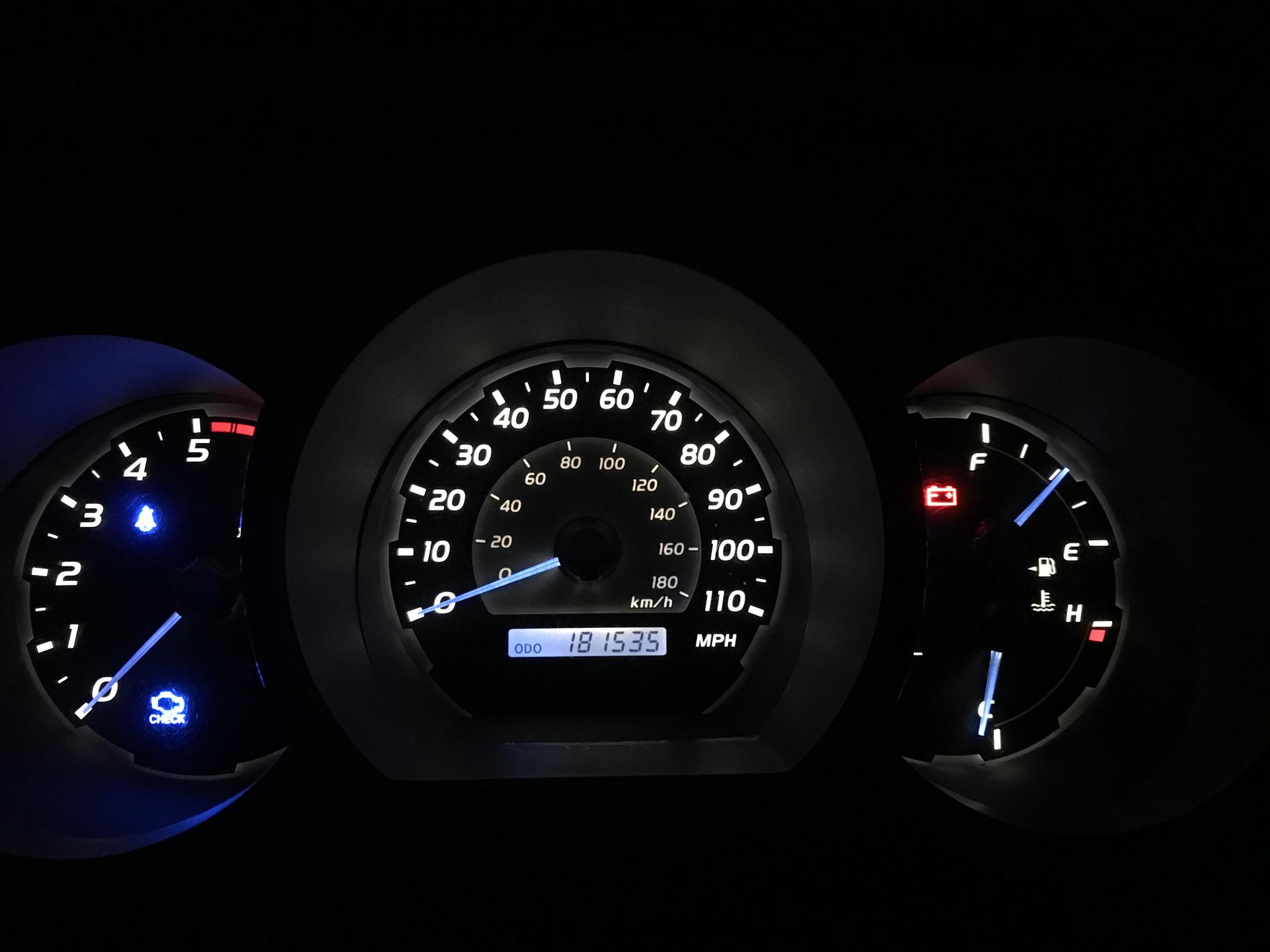

Finished my full LED conversion this weekend. Got the final piece in which was the new head unit.
