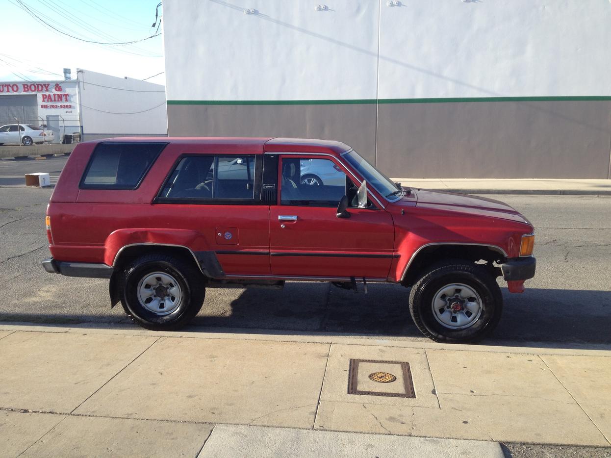

Should I do the ZUK mod? I wanted to see if anybody had any reasons why I shouldn't do it. Horror stories? etc. Also if I were to do it should I do the 12 or 14 inch springs? Do the 14 inch springs raise it too much? more than even?
here is my truck...

Why the f do u need the zuk mod for? Your truck sits level. Don't be fooled by the smaller rear wheelwells. I bet if u measure the frame height front n rear it would be the same. Spend ur money elsewhere. :biggrin1:
Probably because he hits a bump and his backbone goes through his jaw! :first:
